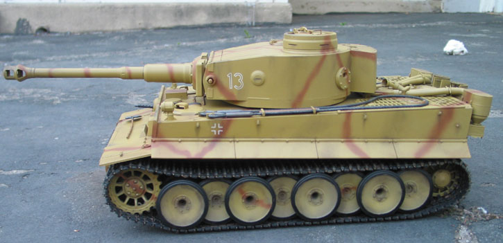

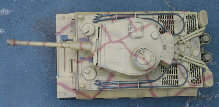

Well gang, here is the completed tank, with markings and weathering.
I tend to, as I did in this case, use only dry transfers when I can. I like to avoid the decal sheen. Although the numbers are a tad small, I have seen examples (in pictures) of Tigers with smallish numerals, so I took a bit of artistic liberty.
For weathering, I do dry brushing and then darken recesses with pastel chalks. I also use chalks for general grime and dirt streaks, as I did here. Dullcoat the whole thing and it lasts as well as paint. Any feedback on how she looks is appreciated, love it, hate it or otherwise

Very beautiful . . . especially the three-quarter view of the Tiger. Lot's of star power there!! I like the understated camo pattern. Frequently, camo can be a bit overdone and hide the overall lines of a tank. Perhaps, down the road, you may consider spraying the tracks with some brown paint and spray dark gray to the muzzel and exhausts. I love it!! Fee free to send it back you me whenever you want!!
