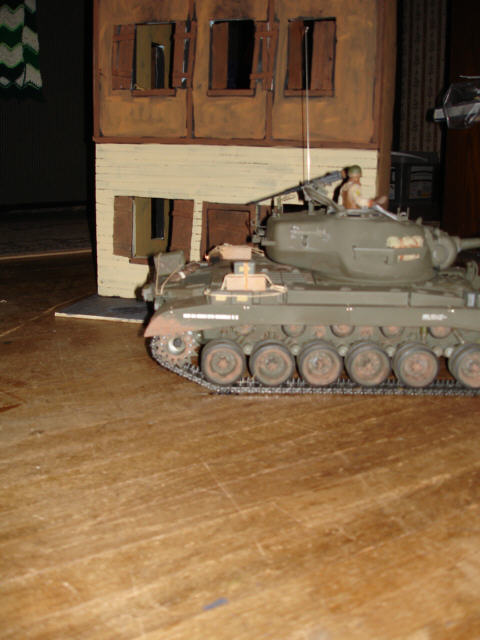

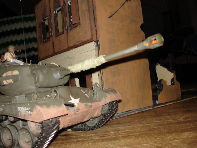

Default Pershing going thru town

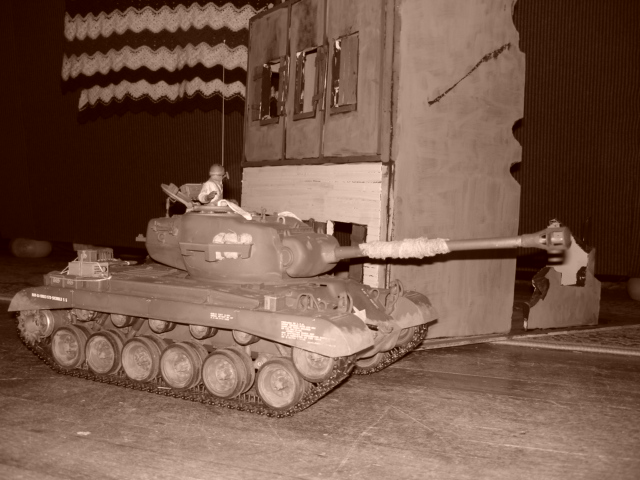

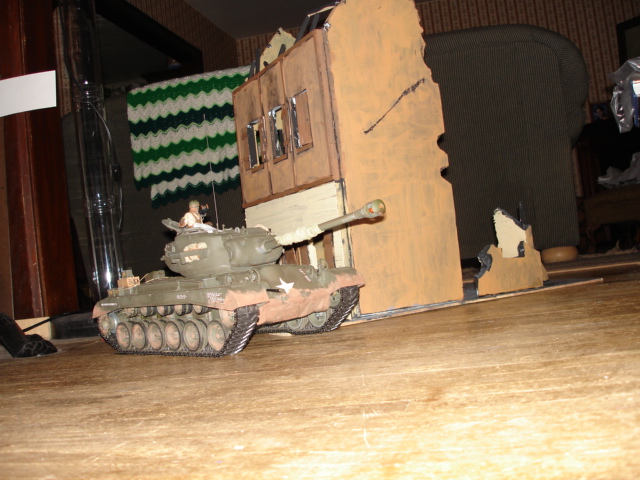

Well, if you can call one building a town...lol. It's a start anyway.
Out Here.
Dennis

Cool i love the sepia

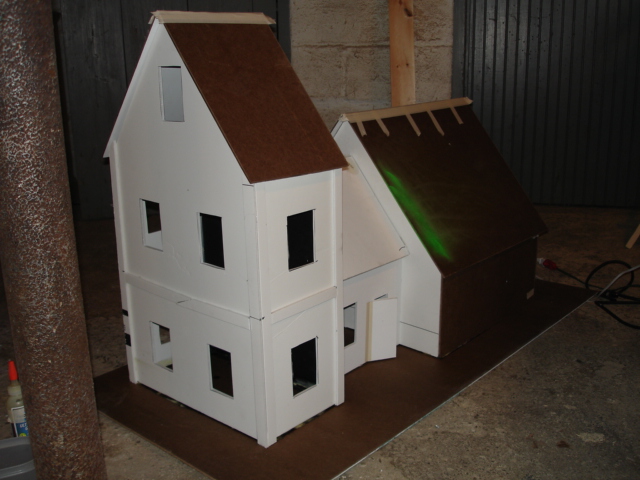

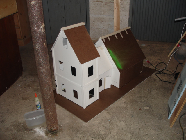

Here is the new building I'm making...
Next, a bridge...starting on that in a few minutes.
Out here.
Dennis

Looks great! Keep it up, more buildings makes battling other tanks all the more fun and challenging.

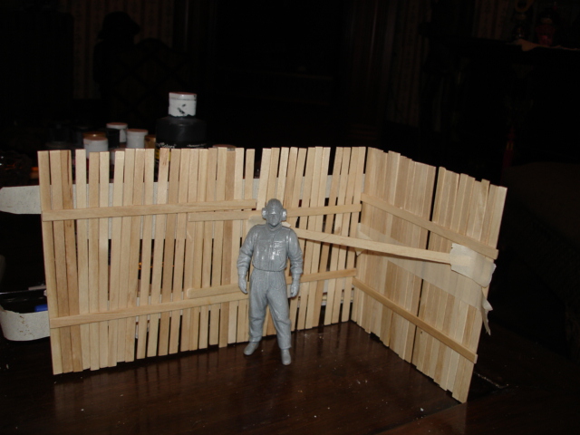

Here is some fence work...easy to do while I watch TV

hey, some really cool buildings there, what is that fence made out of? is it those splints?, i think there called

They're little sticks from walmart.
Forster skinny sticks...75 count.

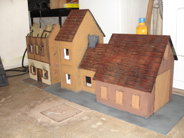

Thanks! Almost done with this one....needs a little brown on the doors and windows...

Great looking buildings! How long on average does it take you to complete the above one?

Thanks guys!
I cut and built the big building after work...so a couple of hours. One day to add sand for texture...had to let it dry...The next day prime it black...today painted.
Materials...I'm kind of a pack rat so I use whatever I have. The ruined building is 1/2 blue foam insulation...very cheap...cuts easily. The big one is 1/8 paneling (homedepot...50 cents half a panel...bought 4 and foam core board from Wally world (it used to be cheap...the price went up a whole dollar...no longer cost effective).
The shingles are poster board cut into a zillion pieces and glued on. For assembly of everything I used my hot glue gun. To hold it to the base I used gorrila glue. Paints are cheapy wallyworld acrylic...I thinned it with windshield wiper fluid to use in my airbrush. The roof shingles were drybrushed with three different colors.

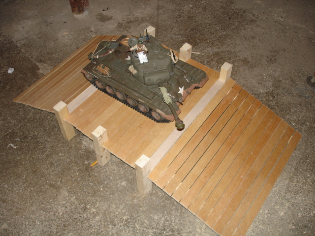

What could this be?! Started this after I painted the big building....
.......the platform of a bridge? [sm=confused.gif]

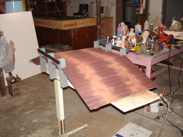

Default RE: Pershing going thru town
and the prize goes to icecream!
had to call it quits for the day after this....tested it....a little steep
some paint...and rope and this puppy is done.
Later,
Dennis

In an effort to increase traction I used my secret formula...sand and glue to make mud...hope it works. Waiting for the pillars and mud to dry so I can prime it then it is ready for field trials...lol
