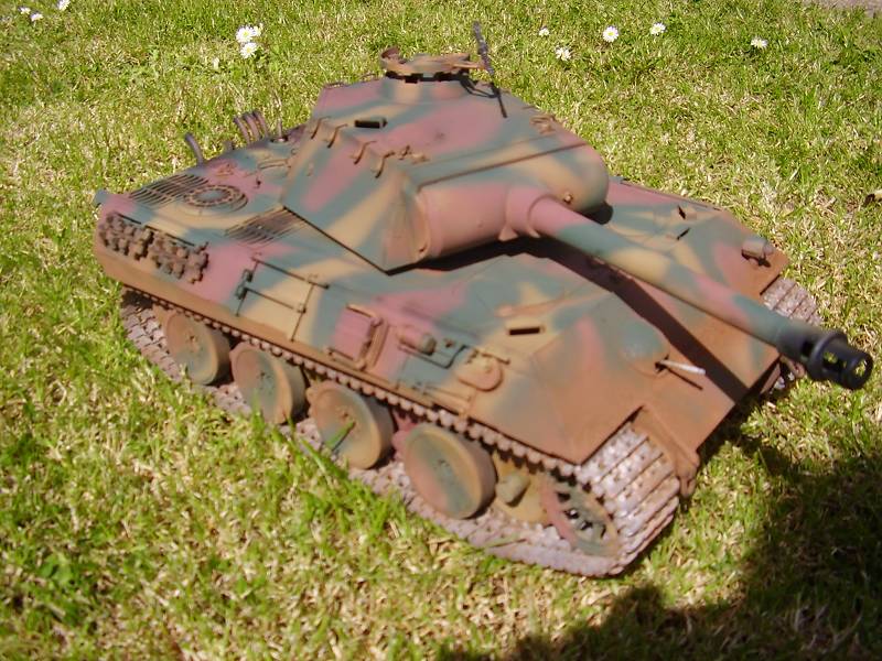

as promised pic of the hl panther reface job, same upgrades as my other hls, hope you like the finnish.

the sounds not bad i dare say a speaker upgrade wouldnt go a miss, i havnt tryed this yet so ??, the gearboxes are not sealed just metal upgrades i did loads of cutting off and out and replced with hand made brass mudguards etc then airbrushed them, the panther.... i removed the hull top took of the silly spare tracks glued a 2mm plasticard on the front of the lower hull with a 2mm spacer behind to give it some more angle, the upper hull i chopped of the front mudguards along with the rest of the front and rebuilt the front of the upper hull with 2mm plasticard, did a good sand down bonded some fillings onto the front hull (mud slatters) then airbrushed it using humbrol enamels.
hope you like the finished job, total time to revamping the front took around 3 hours. the only thing i have done to the electrics is i sprayed them with liquid silicone to protect them from the wet not that i use them in water.

nice painting. tom

thank m8 the credit must go to my airbrush tho i just stood there and waved it around
