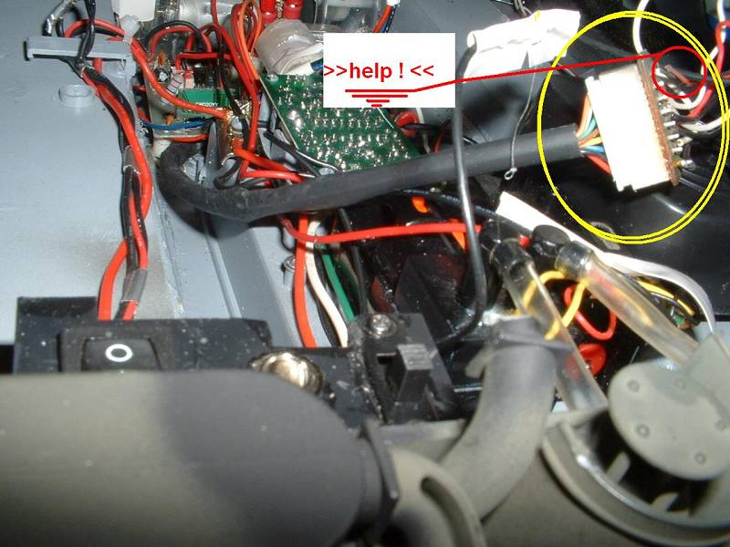

Hello!
I got the upgrade kit, and it works fine. The Tiger is able to move very slow and very fast. The speed is varyable as schutzstaffel wrote.
I have only one question: whereto should I connect the wire of the led of machine-gun.
I made some pictures from the reciver board. Please, someone designate the points, whereto I should blowe on the wires.
http://img.tar.hu/semseyp/img/23876327.jpg#3
http://img.tar.hu/semseyp/img/23876304.jpg#3
http://kep.tar.hu/semseyp/50301506#2
Old 07-20-2006 | 01:32 AM
schutzstaffel's Avatar
Joined: May 2006
Posts: 686
From: near montreal, QC, CANADA
Default RE: HL Tiger S&S version variable speed control
the machine gun led has 2 wires .
the 1st wire connect to the top(1st) wire(orange) on the plug see pic.
the 2nd wire (if i remember well [&:]) on the 4th wire from the top .
just weld the 1st wire to the first top wire on the plug ,
the other one just press the machine gun switch and test the 4th or 5th wire from the top(no danger ,it is just a led) .

My next problem is: if the tank is running forward (or backward at any speed) it convulses, and it responds slow to the sender commands, and if I release the button the tank is still runnig for a second. Occasionally if i push the forward "button" (or backward, or spin) at slow the tank doesn't move and the motors roar.
Old 07-20-2006 | 02:34 AM
Joined: May 2006
Posts: 686
convulse = low battery
yes , it is tricky to slow turn without stalling ,adding a link on tracks really helps to slow motion,but tend to change track alignment on the rear idler on rocks or obstacle
- if you push 3 seconds on controller , it will turn(or try to turn) for 3 seconds, that is how you got the feeling
that it continues for few seconds(3s) understand ?
maybe you dont charge your battery enaugh ,
if you have a 1700mh with a 400ma charger you should devide 1700 / 400 = 4.5 hours for charge, me i add 0.5 hours more to be fully charged.
have to go sleep now[&o],
have to finish rebuilding a kx250 engine tomorow.

I understand!
I thought that the RC board or the controller gets out of tune.
Thanks schutzstaffel!

Schutzstaffel!
The cause of convulse was an unit that had contact error.
I agitated it, and the tank responds well and fast to the signals of controller. No convulse!
