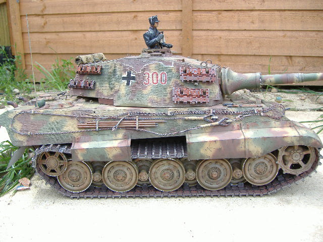

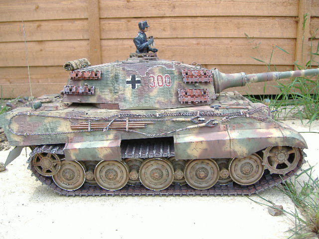

Hi all,
just a quick visit to post pics of my Kingtiger full option, lots of additinal detailing and hand scuplted zimmeritt, in all 5 mnths work.
any comments welcome,

The rolled up item is meant to be a camo net, additional work included many metal parts such as track hanger brackets, mudflaps, a zinc metal commanders cupola replacing the old one, metal conical antennae, photo etched engine grilles and scale bolt heads. hand made steel real wire tow ropes, commanders blade sight, gas detection panel on gun mantlet, lifting lugs on armored exhaust covers, added weld beads and armor plate texturing, wire around gun mantlet bolts to stop them from loosening on the real thing, attention to detailing tool box and tools with careful painting, wire replacement hatch handles and tool box carrying handle.and much more ...
The commander is a great item from Forces of Valor Kingtiger (now sold separately)
i also added a hidden recharging jack for nicad battery, a hidden toggle on/off switch and i fitted an LED in the headlamp with 2 resistors going straight to the DMD.
A labour of love indeed, fancy a late war steel wheel Tiger 1 conversion next.
love looking at all the other work posted here, very inspiring stuff, makes me realise how far i have left to go before im happy with my work
the 3 tone paint is a generic late war scheme typical of KT's (i hope?) and i tried the new filtering techniques with general battle damage, scratches and wear and tear.
i think its important not to go too mad on KT battle damage as most saw action for just a few weeks if they were lucky!

The rolled up camo net is a great idea, thanks.
Your comments about too much battle damage made me think that perhaps I might have gotten a bit carried away on how much battle damage I put on my KT.
I think I'll make some repairs to make it look a bit less damaged. This should be fun -- I've wanted to try Bondo, so I'll see how it works.

Thanks for all the kind words guys, dont think im deserving as there are many very talented modellers out there who far surpass anything i can do.
Cap n crunch 43 for instance, your KT looks so lifelike, if it was photographed with a wintery scenic backdrop i would think it was 100% the real thing, Awesome work!!!
just a quick note, the zimmerit was applied with a very cheap household product, known in the UK as "no more nails" used for fixing skirting boards and architrave around the home, i bought a tube for about $5 make certain its the Non-solvent variety or you'll have molten plastic on your hands! one tube did the entire tank.
i then got the serated blade out of a sticky parcel tape gun and fitted it into a wooden handle and "trowelled" throught the zimmeritt pattern, make certain to keep the blade clean by washing under a tap frequently.

Tom,
the inspiration for this pattern came from watching a superb piece of cine-film footage filmed at the assembly area for the newly equipped 503rd Heavy tank battalion at Padderborn in sept 1944 (i think) just prior to the battalions deployment to Hungary into action against the Soviets forcing there way into the West.
The battalion was a truly organic Tiger battalion with 45 brand new KT's, the battalion was the first of its kind initially equipped with Tiger 1 and later Tiger 2 Porsche, most of which were destroyed in Normandy.
Stills from the Paderborn footage can be found in many books including "konigstiger" volumes 1 and 2 by Waldemar Trojca, the footage itself is normally included on DVDS about the Tiger tanks and its stunningly impressive to watch.
interestingly the tanks sport a variety of camouflage schemes such as the late war "Ambush" pattern and the 3 tone zimmeritted patterns i like to call "cloud pattern"

Stu, thanks for the compliment, but your tank looks like the one I originally wanted to model!
I chickened out on the zimmeritt, and went with a later model from the 509th. Your tank is just plain incredible! That camo pattern is very accurate and looks just like in the book! Also, I agree on the MG-42.

Ron, fo kt does come with two manlets, but u only can use the smooth one. the step mantlet was design for old kt. but you can use it with some modification.
do you have scanner? i would like to see the commo pattern on 5 side.
Stu, when are you going to take some photo of 5 sides of your tank?

Tom,
i will post more photos as soon as i can, i did not photograph other sides as i had one track off at the time and felt too lazy to put it back on.ha ha
