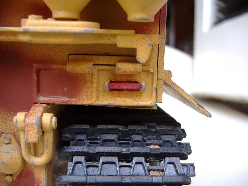

Then, there is only one backlight, at the left side, below the mudguard.

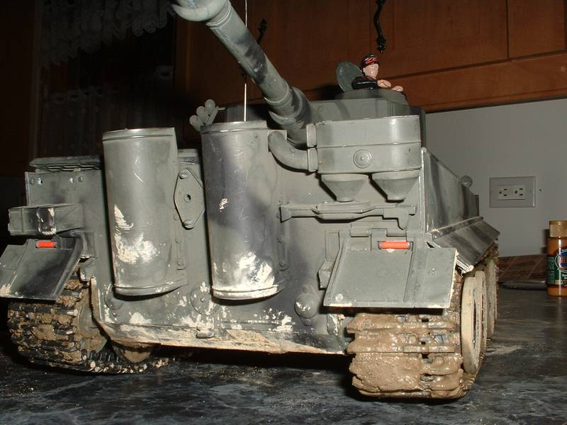

not sure what you want ,
but here is a pic of the 2 rear lights of the tiger(red).

I followed schutzstaffel "instructions". It was the simliest solution for me.

semseyp , i like your cammo patern(looks almost like mine) same taste ...
does those back light are leds or painted ? look like it is real lights!

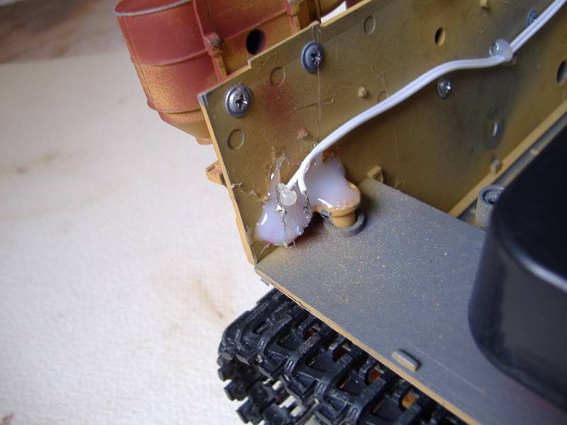

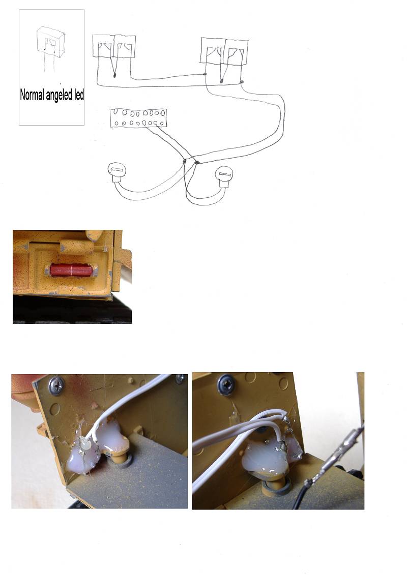

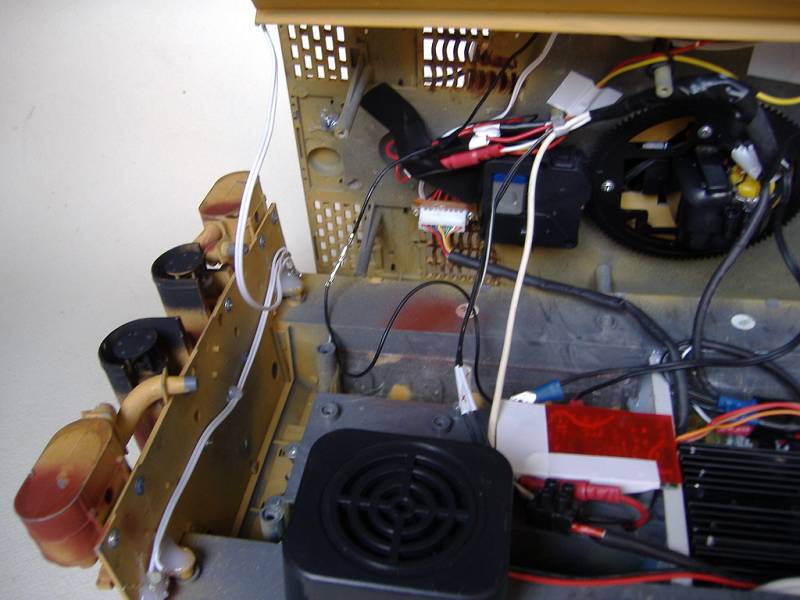

It’s not difficult to make it. I got an auger-bit with 2,5 mm diameter, and I bored holes. Then I got a scalpel, and I made the hols to angeled.
A light is two led in serial connection.(So it doesn’t light too bright).
I bought the leds in an communications shop.
