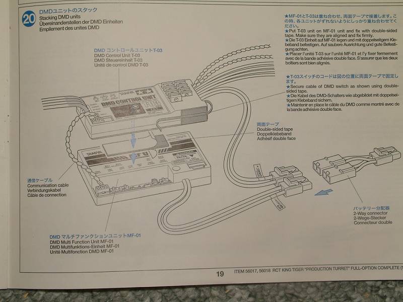

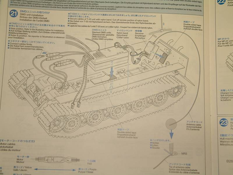

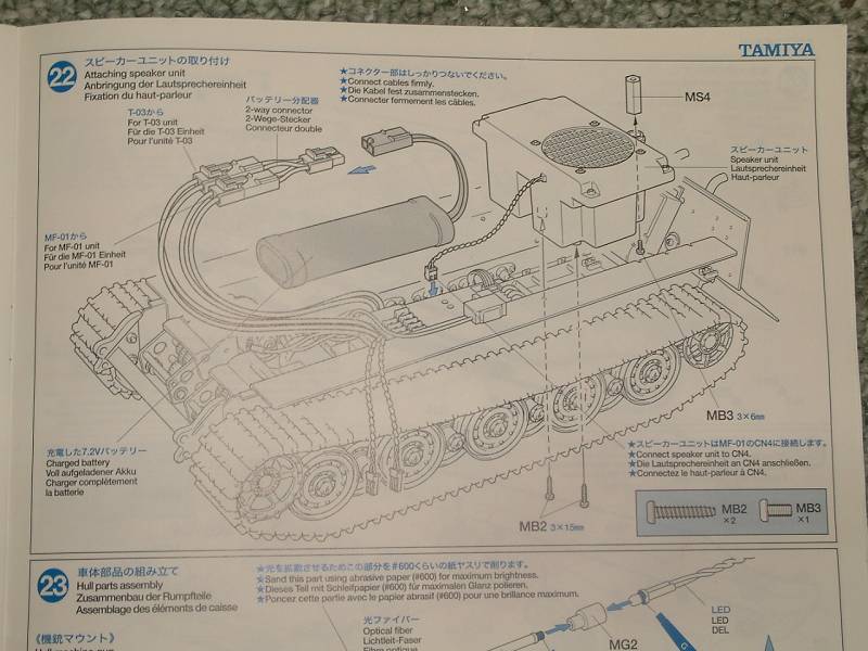

Can someone show me a pic of the inside of their KT (electronics)? I don't have a full option manual, only static, and am trying to setup (placement) of the DMD/MFU, speaker etc.

Hope these pics help i'm in the middle of building my KT at the moment
Cheers Ian

THANKS IAN!!!!! Exactly what I was looking for!!!!!!!
