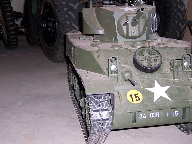

Here are a couple of pics of my M5 plus a couple more of the KT. I'm 6'1" and 210 lbs -- that's my hand in the photo, to give you an idea of the KT's size. It weighs somewhere in the range of 65lbs. It operates much more realistically than the smaller 1/16th scale tanks, especially clawing its way over bushes, dirt, through snow, etc. I decided it was worth the investment and it's paid off.
