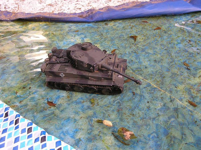

one of my qtips needles made some colateral damages.

I've heard of shootin' some pool, but nothing like that, Shutz. [sm=lol.gif]
