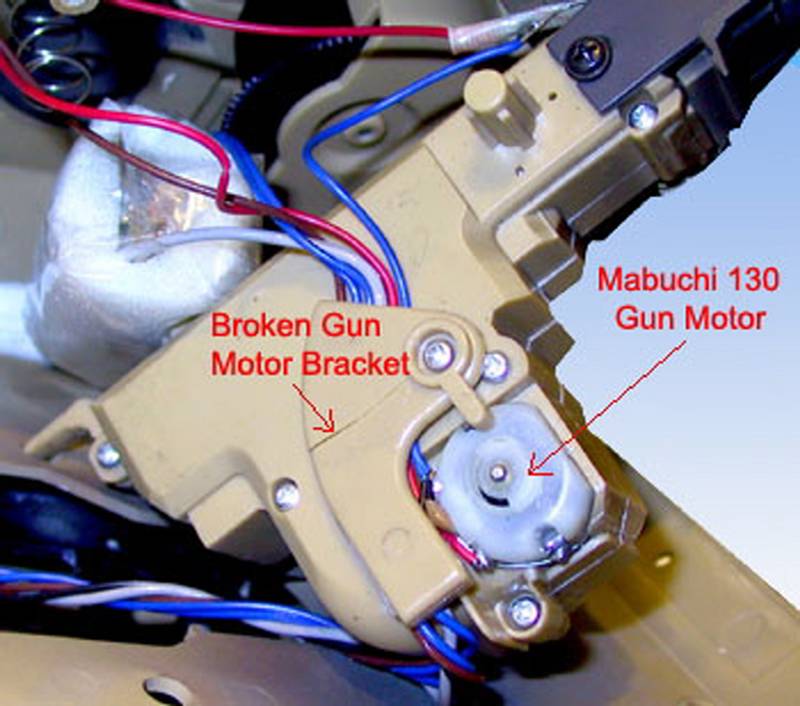

It does not shoot. Got the other bb's some times it worked and sometimes it did not.It got to the point that I would count out 10 bbs and it would work. Now all it does is make all the noises of it firing but nothing coming out the barrel.It'd done this since I got it about two months ago.I don't mess with it much anymore just waiting for the new stuff coming to make it battle with my Tamiya tank someday. I do have two motors the long can black motors that I'll be installing later. As for speed- it's slower than my Tamiya Pershing , It gets caught in the same grass my Tamiya cruises thru. Climbing ability is less than the Tamiya on the same hills.So what I've got is a tank that is slower /has less torque, the airsoft unit has never worked properly and the smoke unit never worked.It drives - the turret works,gun goes up and down, it makes the engine and machine gun noise.
If it rains this Sunday then maybe I'll take the tank apart and mess with the airsoft unit.Since I've got no idea what to expect when I take it apart- I don't know what I'm looking for.
If the motor makes sounds and it sounds like the gun fires but nothing comes out you may have a jam if you used the original bbs that came in the little box. More then likely your breach is busted. You can attempt to glue it back together or order another one from Mato (sells the whole airsoft unit in pairs). Another option would be to buy A6 VS airsoft unit from Toy East. When you get it, swap over all the internals, including the barrel and breach into your Heng Long housing. You'll experience 65% better performance and have a much more reliable gun, provided you use quality bbs.

this is a vs gun may look like yours when mine broke the motor had slipped back out of housing i repaired crack sliped motor all the way into housing and super glued it in fires great now

Without that plastic retainer the motors can sometimes back out and their gears won't touch. If you order the VS units, they'll come with them, so do the HLs.
The breach is the part of the gun that the bb falls into when the nozzle retracts. Inside the breach is a rubber bushing that holds the bb in place and keeps it from sliding down the barrel. The thin side should face the bb, the thick side against the barrel. The barrel also goes into the breach. Some of the heng long screws that secure the mantlet to the airsoft unit are a little long and touch the breach, especially the left side. If yours has the indentation from the screw and is not cracked, cut the screw down so it won't touch it. If the breach is broken you can try to fix it or order a new one. If you install the VS breech in the Heng Long housings you need to modify the breach and housings a little for trouble free feeding. Shenloco on MTG and Panzer forums has posted some great pictures.

I looked at the breech and everything looke find. Tried shooting it off the tank and it worked. I think I had a 1/2 a bb stuck. Put everything back together and it still does what it did before.Nothing!It makes the noise but does not fire the bb's.

I have the same problem as regards a broken breach. Does anyone know wher I can get 2 gun motor brackets? I bought 2 firing mechanisms from MATO but they did not include the Gun Motor Brackets. Also to Swaithdiver, do you have the internet locations for the Panzer forum and MTG with their pictures you spoke of ? Thanks for any help that can be provided
