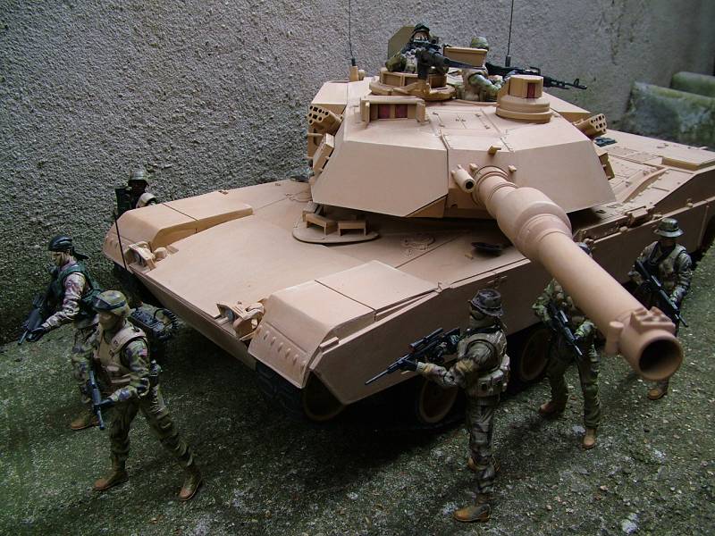

Hi, I have used Tamiya paint many times and it really is outstanding, fine spray possible and it lays out well when brushed, lovely smell and taste of apples! When I was in a DIY (Home Depot type) Store I saw some matt acrylic/emulsion small sample pots used to see if you like the colour and they have worked out fine! I first thought that the particles in the paint might be too big and it wouldn't flow through my airbrush but no problem at all! I sealed the finish with airbrush using PVA Wood glue. It hasn't peeled off yet! Over spray PVA with more emulsion from superstore for nice matt finish. A cheap and cheerful alternative to expensive model paint.
Joined: Jul 2006
Posts: 151
From: londonengland, UNITED KINGDOM
Hi, I did something wrong on the upload of my photos but got there in the end! PS The picture of the Hummer was taken in a heatwave and the glue holding the windscreen failed! The paint stayed on though!
