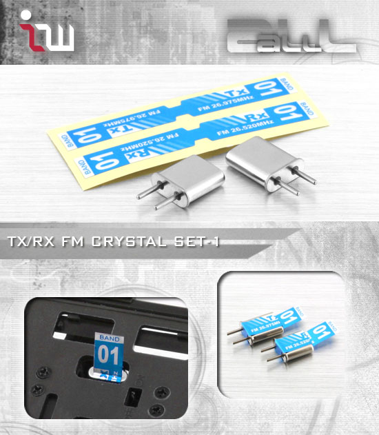

Shoot!!! No, they won't work. Look at the picture, the TX and RX frequencies are different. Anyone need a crystal set? [:@]

???? Yes.. I haven't saw that!!!!. They have different frequencies for TX and Rx. [:-]
How this Crystals will work with anykind of r/c car or tank if they have different frequencies? Maybe this is just the picture because I can't imagine how crystals with different frequencies would work together. Since they are selling a set of RX and TX 27.255MHz, both crystals should work at 27.255MHz, right?
They also said that it is a "Futaba FM Crystal " set. Does futaba controls works on different frequencies?

That's our problem. The 27 MHZ FM Crystals that I have found at ebay have different frequencies for TX anc RX. The TX uses 29.975 MHZ and the RX, for the same set, uses 26.520Mhz. I contacted the Futaba customer service and they told me that it's all right. That the correct is that the crystals will have different frequencies (at least for futaba controllers) and that this crystals would work on any futaba controller. I don't about other controllers (the ones from HL tanks).

Look at this:
Would this crystals work on a HL Tank?

No, they won't work, the numbers don't match. Look at my previous posts on the topic. Tower sells the Hobbico and several other brands that will work which adds 3 more frequencies for a total of 7 tanks that can be run at once.

More and more I believe that the Crystals in the picture should work. I downloaded the VS tank manual and it shows a table where it says that the transmitter frequency is 27.045 MHZ and that the receiver frequency is 26.590MHZ. There are 6 different frequencies and always the transmitter is .455 MHZ 'higer' than the receiver. In every store that I have enteres looking for VSTanks, they generally only show the transmitter frequency.
So I don't know about HL, but this crystals will probably work on VS Tanks

I don't think they'll work but I'll try them out for ya. Just got them in the mail. Once I put the kids down and charge up a battery I'll let ya know. This test will be for Heng Long tanks, I don't own a VS tank, just their guns!
