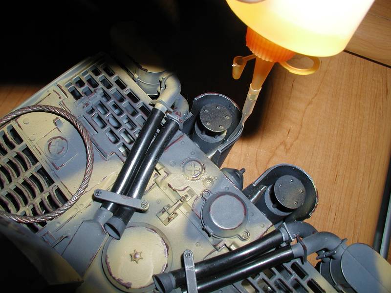

hi there have had a tamiya pershing for some time (must biuld it some time) but have just bought heng long tiger mk1am a bit unsure were to put oil for smoke[sm=shades_smile.gif]

Their are 2 tubes in the back that the smoke comes out of, you up the pil in by using the long extension tube that is in the back with the oil.
Jeff

you should use the left side tube for filling the oil because this line goes directely on top off the heating element.
the tube shown on the pic is the right side line and it is not a direct line to the reservoir(may spill back oil).
dont over fill it.
