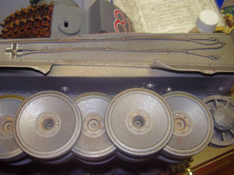

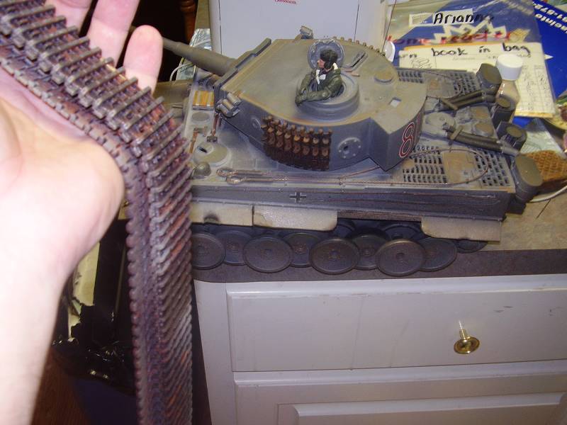

RE: HL Tiger arrived......having problems ..Help !
My Tiger 1 did the same thing after I made some modifications to it, but upon closer inspection of the wiring, I realized that I had a short in the antennae wire. You need to open the tank.......it is not as bad as you might think.
Remove the tracks from both sides (pulling a link pin is the easiest way).
Remove the three (or 4?!!) long screws from the bottom of the hull.
Remove the two front screws (short) under each of the fenders that were blocked by the tracks (the rear screw on each side can stay).
The two sections of the hull will separate, but will be connected by a bundle of wires (unplug) and the antennae wire (metal connector pulls apart).
Look for broken or loose wires.......the antennae wire may just be unplugged. Take a picture and post it, so we can see it topless.
Jason

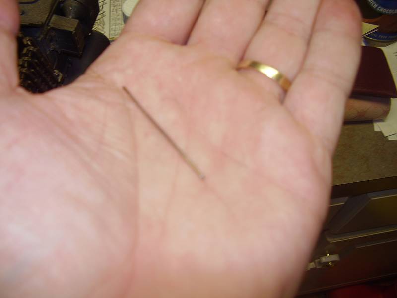

Sure.
As you can see, the tracks are basically several dozen individual links that are held together by metal pins. In order to remove one of the pins, you need to push one out with a tiny screwdriver, stiff wire or even a safety pin. From one direction (inside of the track on my tank), the pin will push out enough to grab it with a pair of needle-nosed pliers or maybe even your fingers, but it won't go out the other direction because the pin has a raised surface at one end that will not go through the track link. Once you get a pin pushed out, the track will be one, long set of links that you can pull off of the sprocket, idler wheel and road wheels.
At that point, you should be able to see the screws. There is a group of three small screws toward the back end on one side that hold the speaker in place......you can leave them and the last screw on each side. [sm=thumbup.gif]
