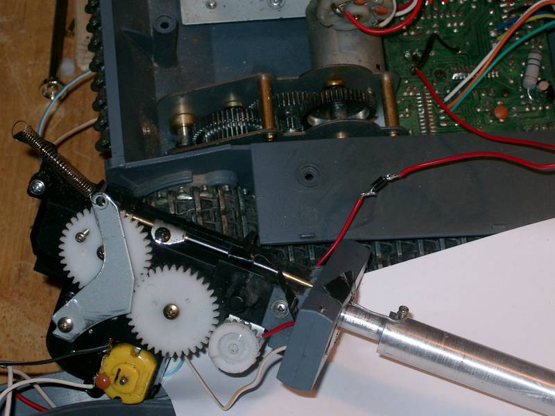

a bit of a newbie tanker, while modding my tiger I have fried one of the boards - damm shame as I had got a recoil system to work using the pulse that goes to the tracks to initiate a recoil which in turn opened a micro switch to enable the runout of the barrel - still I digress. Where did you get the web address for the Elmod site as I couldn't find it on their web page - and despite living in Germany I am not too fluent at reading the lingo. Regards HVI

Hi HVI,I'm very interested in how you managed to find the outputs on the board to initiate a barrel recoil......can you explain further
or post a pickie of where these outputs are on the board?
Cheers
CaptB

Hi, I just stuck a volt meter across the points leading to the motors then traced back through the circuit to see where pulses occured (which cause the whole tank to rock back and forth) when the K button was pressed. Soldered 2 wires on to the revers pulse then linked through a diode to the recoil motor. If you can tell me a quick and easy way to upload a piccy I'll get on to it.
regards HVI

Captainbertie, techno dummy at this end has read through some other forums so hopefully here a picture of the recoil mechanism and the wiring. The pictures show the gun run out and recoiled. The recoil pulse from the tracks is just enough to turn the motor behind the righthand cog. This moves the link pulling the barrel back far enough to open a micro switch in the mantle (mounted by the screw visible in the forground). This switch then enables a larger current to the recoil motor making the cogs turn with enough power to overcome the recoil spring and push the barrel forwards again. This in turn closes the micro switch cutting power to the motor and resetting everything for the next shot.
Where I messed up was the diode on the red wire under the barrel was not high enough to prevent a 7 volt spike getting back to the pcb ooops! The red wire goes back to the black wires which in turn are soldered to the recoil puls pins on the PCB.
For my next attempt I am trying to make a circiut that will take the recoil pulse and use this to open an electronic rather than mechanical switch. This should enable me to make the recoil motor work for a set time period independently of the main PCB and reduce the risk of frying andother board.
Only snag is going back to work this week kills off any spare time for playing.....

Hi HVI,Very innovative........I am sure that you will get it to work........I was just going to link a retract rod into the airsoft barrel
so that it retracts when you fire the BB.......I know this would be independent of the hull re-coil but I thought that
when firing from the side with a 90 degree turret position, the tank would'nt jump back which looks wrong to me, but you could combine the two motions when firing forwards etc................have you tried this?

The advantage of the TLS in this case is, that it generates an impulse for the recoil unit and after a shot you have to wait approx 9 seconds (reloading time) until you can shot again.
http://www.rc-panzerketten-forum.com...?threadid=6854
I posted a short description how to connect the recoil unit to TLS. The english version will follow in the next 2-3 days.

Hi,
is that a Tamiya recoil unit in your picture or one your firm produces? If it is a Tamiya do you know where they can be bought?
regards Harvey
regards Harvey

Hello!
Yes, it's a Tammy. But sorry, I have no idea where to buy. I got it from a customer for testing purposes. But ask in the RC-Panzerkettenforum:
http://www.rc-panzerketten-forum.com/wbb2/
Greetz,
Th.
regards Harvey
