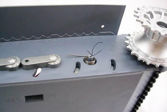

Hi guys i need help. My suspension axel arm thingy has snaped here is a pic of what i mean.
any sugenstion will be very apreceated.

i did that replacing my suspention arms! tough to get off aint they.
i just broke off the plastic stubb, and shove an m4 nut and bolt through.
worked a treat, make sure you make the hole a little bigger on the tanks body!

i would do but i dont want to risk taking the tank apart again incate i damage it some more, the place i broke mine was just near the electronics and any false move an i think it could short,
but in brief,
1 compleatly drill out the area where the pivot for the suspention arm goes, the same diamiter as the hole in the new metal arm
2 Find a nut and bolt and bolt ( i think about m4 - m5 (4mm-5mm dia)) and bolt though the suspention arm and the new hole you've made,
3 secure bolt with a little loktite,
that should work,

[link=http://www.rcuniverse.com/forum/m_3592742/tm.htm]Here[/link] you will find pictures of 2 variations of one possibility ...
