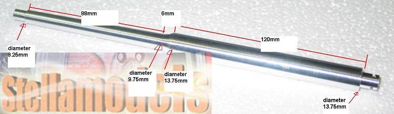

Does anyone here have the aluminum barrels from Stella Models or elsewhere? Need to know diameters (muzzle, collar, etc...) and lengths (muzzle to collar, collar to breech end ).

Stella Barrels dimensions are as per the picture - sorry about the quality but this was the only pic I can find. If somebody has a better one they can put up I can put better dimensions on it. Excellent quality barrel though unlike my picture

Thank you muchly,
