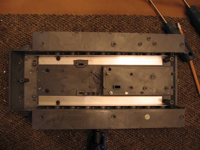

Actually... simply a drill bit and a thread bit will allow you to thread the hole in teh arms to M3...... Then use a file to file the splines off of teh original axles and a flat spot on them.. using a grub screw to hold them in place.... For the new axles a hacksaw to cut teh brass tubing, a file and the same thread bit will allow you to make the brass tubing to replace the suspension... quite simple.. and the picture below shows my how I gave it all extra support (note, I have not added the brass axles yet..I might do this as they break...)

i will try and put a photo together of what im trying to achieve as im not explaining it to well at the mo
trying to get the suspension to work better and last a lot longer

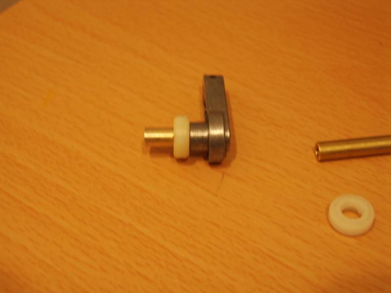

What is the plastic bushing for?... Will it not bring the road wheel away from the and effect how the track runs?... Besides that... that is what I am planning to do.

the plastic bushes are the cheaper version to bearings just to show were they will sit on the shaft.
the arm will sit as normal once i have mounted the bearings inside the body or ground the shaft flat on suspension arm

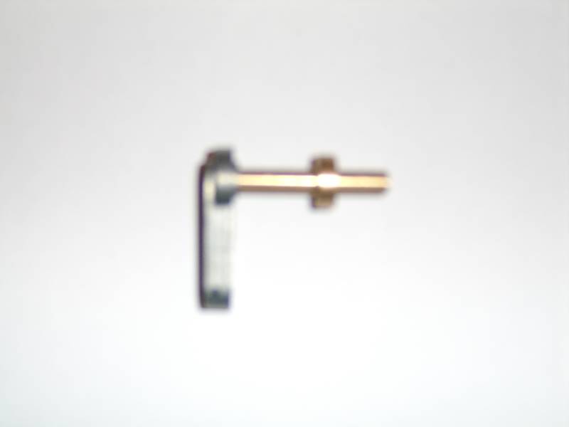

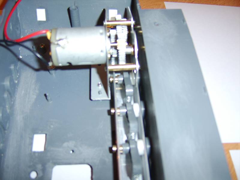

heres some photos of what i achieved over the last day or two here the suspension arms with solid 5mm brass bar insert
Old 02-16-2007 | 06:09 PM
Banned
Joined: Jan 2007
Posts: 1,707
From: swindon, UNITED KINGDOM
Default RE: suspension

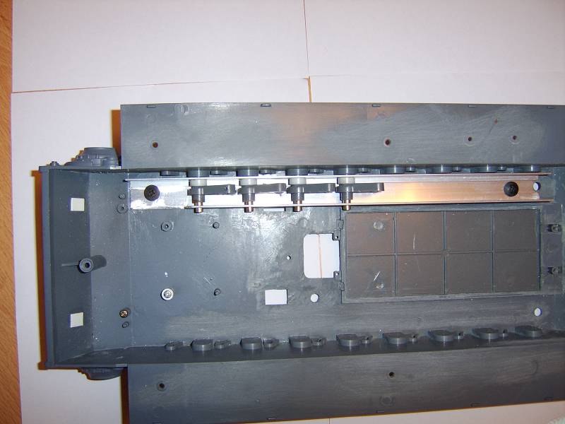

aluminium angle and arms being fitted to tank chassis
Old 02-16-2007 | 06:12 PM
Banned
Joined: Jan 2007
Posts: 1,707

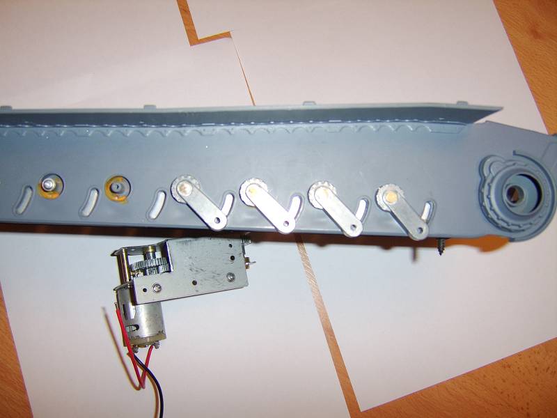

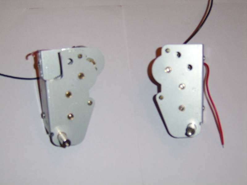

modified motor housing showing clearence for new arms
ID:	622986   Click image for larger version
Old 02-16-2007 | 07:00 PM
Banned
Joined: Jan 2007
Posts: 1,707
oops sorry for the fuzzy photos but i hope you get the general idea
Old 02-16-2007 | 07:15 PM
Joined: Dec 2006
Posts: 525
From: Richmond, BC, CANADA
Fv432,
looks good but why are the suspension arms on the INSDIE of the hull?
Old 02-16-2007 | 07:19 PM
Banned
Joined: Jan 2007
Posts: 1,707
there is a brass bush in the recess where the old spring used to sit
Old 02-16-2007 | 07:23 PM
Banned
Joined: Jan 2007
Posts: 1,707
just read your post a little better they are the old plastic arms the new metal ones are attached to the brass bar on the outside as usual
Old 02-17-2007 | 12:58 AM
Joined: Dec 2006
Posts: 525
So the plastic ones... Inside... you will grind off the arm and use it as a bushing?
Why did you decide to use channel stock instead of angle stock?
Looks good!!
KT
Old 02-17-2007 | 03:59 AM
Banned
Joined: Jan 2007
Posts: 1,707
the plastic arm on the inside has a spring attached for the suspension the "U" channel is actually two bits of "L"angle not very clear from photos hopefully will get a photo of the plastic arm with spring attached
Old 02-17-2007 | 04:18 AM
Joined: Dec 2006
Posts: 525
Ahhhhhh... I see the inside springs now... cool!
KT
