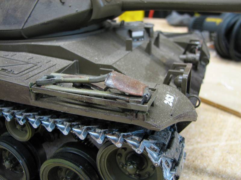

Outside of their covers (with the rest of the "accessories" )
Inside their covers (which are just painted plain yellow at this point)
These were done with nothing but tamiya acrylics. If you like them, here's how...
First off, I painted them all over in XF-16 Flat Aluminum to give a metalised undercoat (thinking about it, although I undercoated the rest of the tank in car primer, I didn't with these, I was too eager to get on and paint something!).
Then I gave them a thorough wash in 50% XF-64 Red/Brown, 50% thinners. Then it was a wash of 25% XF-1 Black, 75% thinners.
After those were totally dry, I started to dry brush with multiple layers of XF64 Red Brown mixed with more and more XF-57 Buff, making it lighter as I applied the layers.
If at this point it starts to get too light, another wash of very thin black will sort you right out.
Finally I gave it a very very light dry brushing of orange (this was in fact some old Citadel Miniatures (now called Games Workshop.. and if you remember CM that'll give you an idea of how old this paint is and it's still good!). I'm sure Tamiya's XF?? Orange would work perfectly well.
And that's it. I was REALLY pleased getting the effect I was after, which like you say gives that look of constantly heated pipes that have a solid, non-flakey layer of rust all over them.

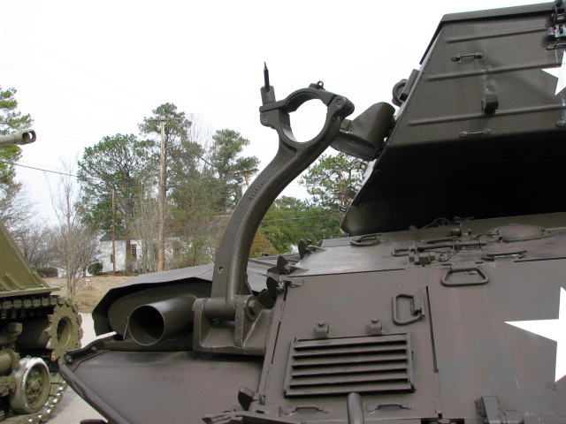

The mufflers and shields on the M-41, M-46 and M-47s all did the same. Within an hour, all the paint is gone and overnight, the moisture gets to it (it always rains on tanks) and they will rust and the old paint will flake off. At night, after you have been running a few hours, the pots will glow bright red and let everyone know where you are. Nice in cold weather 'cuz you can always get warm and eat hot chow...but also nice to be able to hide and keep pesky metalic hornets away. The exhaust on the M-48 shot straight out the top center but the M-48A2 came with a cover that hid the mufflers and blew the exhaust out the back. This kept the heat signature to a minimum.
Bill
Bill
Hi Bill,
What color was the base coat (primer) used on the tanks? Was it Oxide Red like the Germans? I cannot say enough how we appreciate your input and knowledge, Thank You!
Hi James,
Never really saw one of my tanks in primer, but from scraping, sand/filing etc, it looked like the standard wine colored primer.
By the time I got any of my tanks , it probably had 8-10 coats of paint, even over the bailing wire and green tape that held it together.
The M-41 is my all time favorite though. It was fairly easy to maintain, sufficient room to move inside and fast as a blitz and extremely maneuverable. Hated that gun though...the 90 was just a dull boom, but that HV 76mm had a very vicious snap that would take your head off or pop your eardrums. We normally had to brush paint....armor units in the field didn't have nice stuff like spray paint guns.
Bill

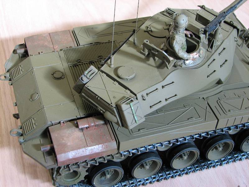

Here are my bulldog tracks... They need a little dirt but after quite a few coats of different colour paint... and alot of dedicated time to sanding.....
Well you be the judge.... comments appreciated.
KT
KT

Well.. I have the tracks done..... I had to wash them in bronw. I had some comments they looked a little red.. and rightly so, they did... Mufflers done as well... Keep in mind on minimal mods have been done.. so I can play with this...
KT
