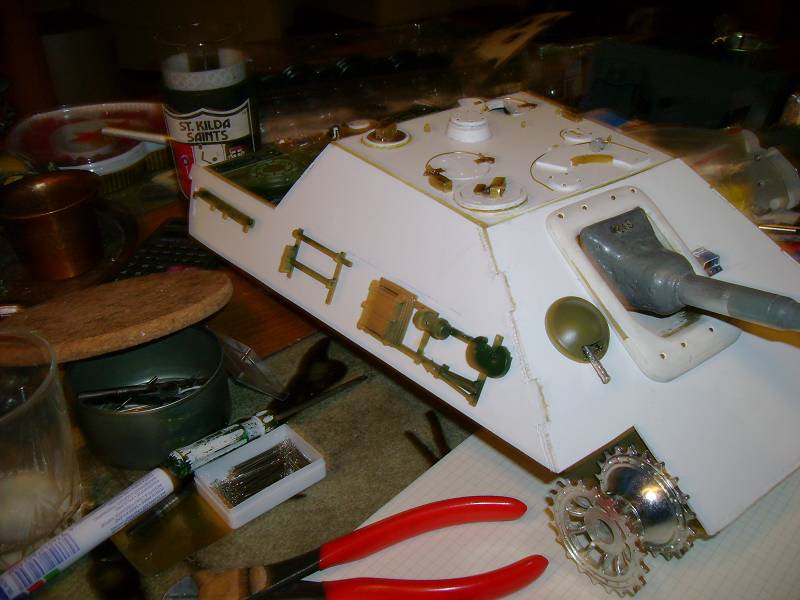

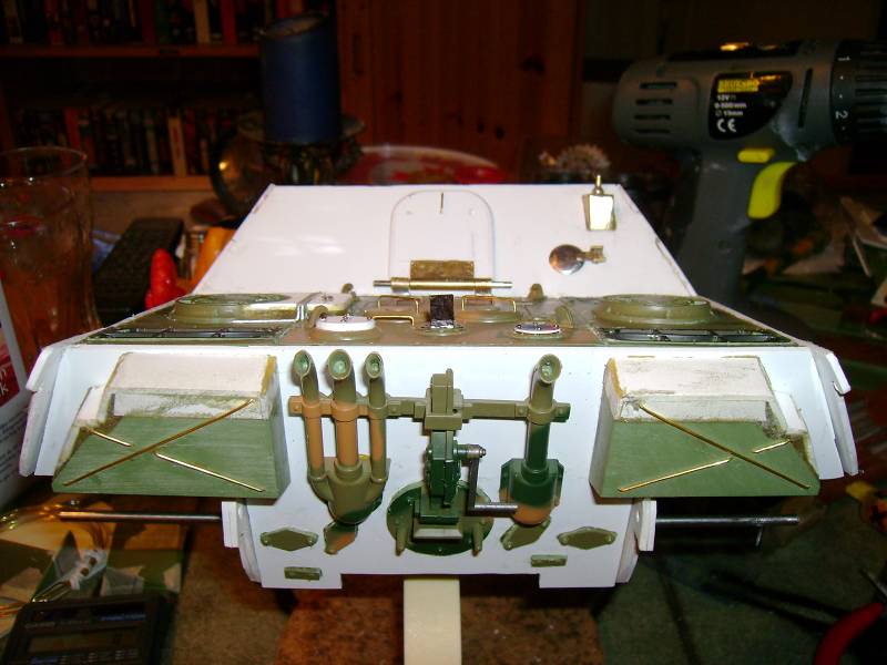

Hi - have now done some more ... the barrel sheild and so on ...
Also i finally made the exhaust system - bit tricky that one

Old 04-14-2007 | 09:02 PM
  #40
Joined: Jan 2007
Posts: 166
From: Umeå, SWEDEN
Default RE: Jagdpanther
Hi - I have now done some more - all the gun functions is working , have reinfoced the chassie ( metal suspension arms - new rear axel ) . Have also done most of the outside too - im thinking of not doing Zimmerit ... have to see how it looks after the base coat ...
Have also starting with the roadweels ( not quite done yet )..
Jonas
