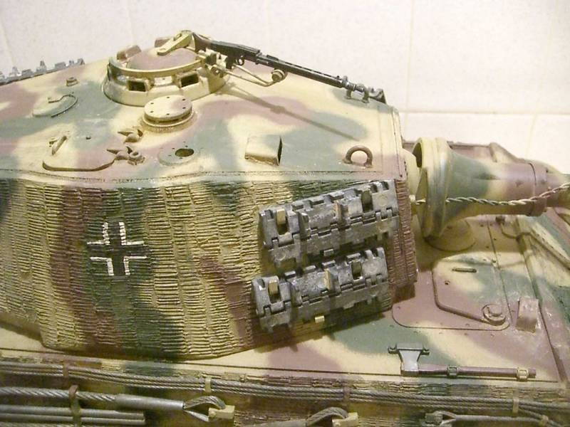

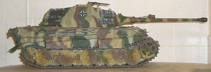

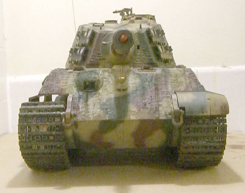

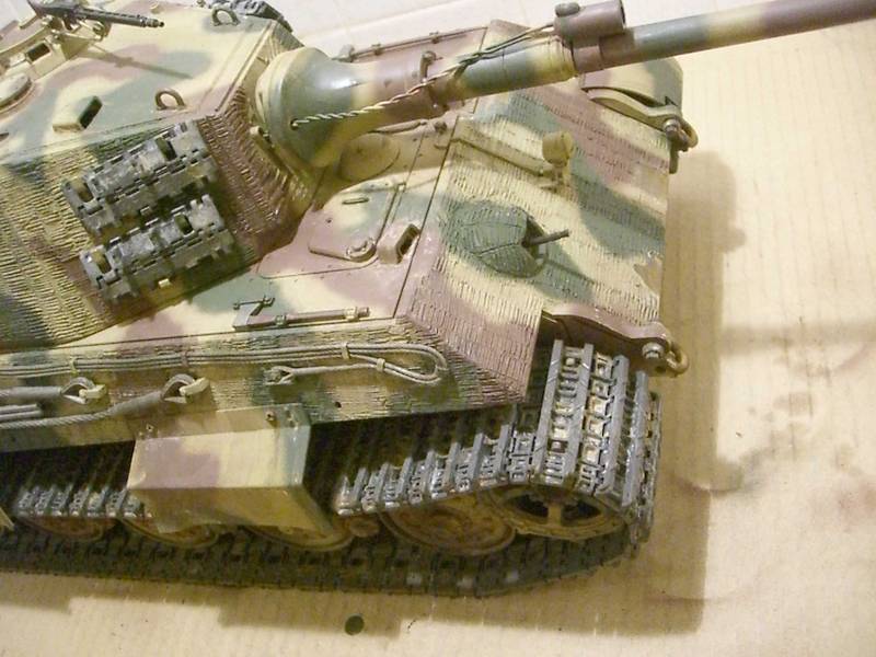

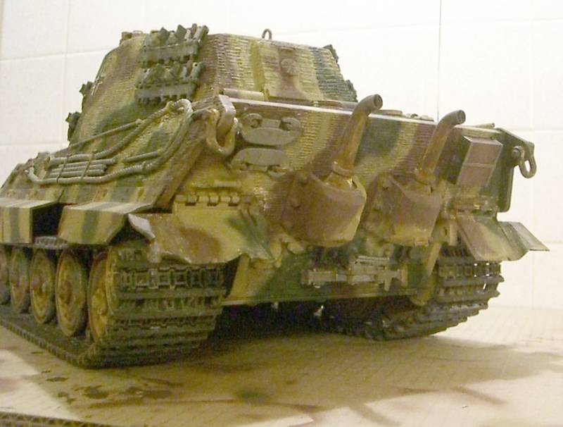

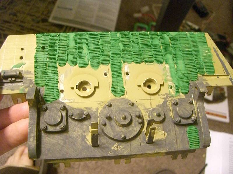

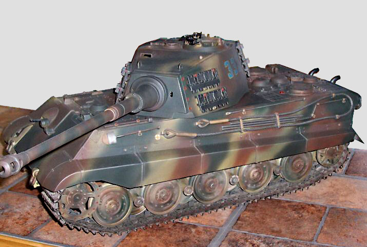

Well I got this off Ebay for a great deal and it showed up as in the first pic. The previous owner took meticulous care in building it and dropping another $500 into upgrading the suspension, tracks, recoil, and lots of metal detail parts.
I just had to detail it really, but with the previous owner doing such a great job, I was determined to do the best I could.
I went for the 503rd battalion Ardennes scheme. I didn't number it because I couldn't figure out what tank Knispel Kurt commanded.

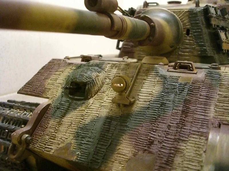

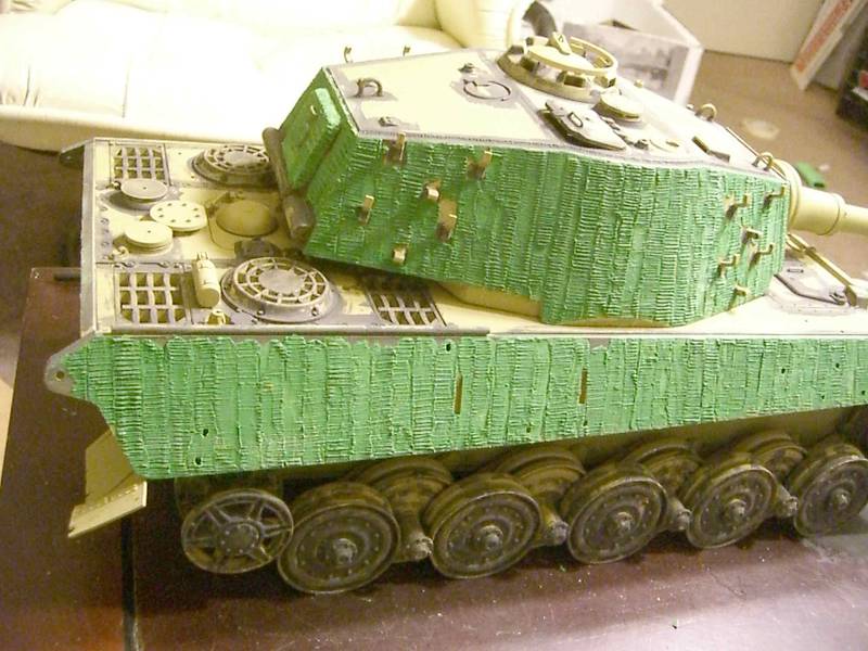

So I started by applying Squadron green putty for the zimmerit. I actually laid each line seperately just like I imagined the real deal was laid up. It's to scale so that's like 220 columns of zimmerit, or 12 hours of work! Man, what a pain.
Then it took another 12 hours to airbrush and finish off the remaining detail parts.
Then it took another 12 hours to weather and rust it. I actually applied a rust kit you can get at any craft store before I painted the camo. I laid on more rust on top of the camo paint where it made sense.
When I applied the rust catalyst, it created genuine rust on top of the paint but even below the paint just like a real metal tank.
It takes a lot of catalyst to seep through the paint, but look at the wheels, they look pretty real to me.
I matte clearcoated the whole thing after to keep rust from getting everywhere.

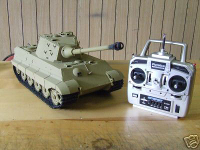

So after 40 hours of work and enough chemical exposure to take 5 years off my life, I'm happy with the looks, but I can't get the guns to fire! HELP!!
The previous owner knows what he's doing but I haven't heard back from him.
He soldered 2 fire buttons to the Futaba Skysport T4YF board.
I have all the trim tabs neutral in the center but when I press the right red button it makes the tank drive forward.
When I press the black left button, it drives the tank backward.
I tried every combo of moving the trim tabs and hitting the buttons, but the tank just drives and moves its turret around.
I had the MF01 do a self check and it makes the guns flash.
Can anyone with a similar radio give me the procedures to fire the guns?
I wasn't doing so, but can this tank shoot and drive at the same time?

I had a similar problem with my T4YF and fire buttons on my Tam T1. I installed the fire buttons myself. Afterwards, I got the machine gun to work, but not the main gun. Pushing the main gun button only made the motor noise rev up. My problem was that I had the receiver wired wrong. I had the left stick on my tx controlling forward and right/left turn whilst the right stick controlled elevation and traverse. In a fit of desperate research, I re-read the assembly instructions, and noticed that the controls in my tx were backwards (i.e. the left stick controls forward /reverse and left/right traverse, and the right controlled the elevation and right/left turn) from those in the manual. I swapped the plugs around on the rx, and then the fire button worked fine.
For internal wiring in the tx, I was able to get a picture from a RC tank club in Colorado's website. The article detailed how to do it, and had pictures. I can't seem to find the website, but I'll look around and post if I find it.
Hope this helps!
