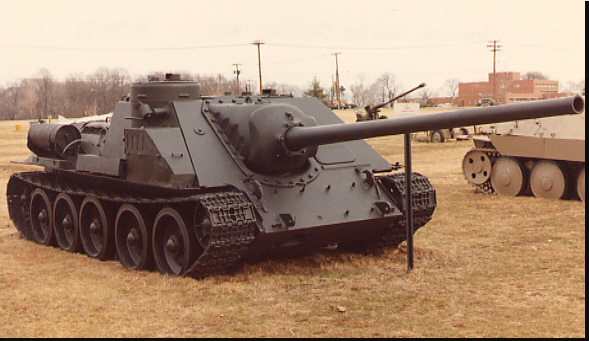

Hello all. I have decided to build a Soviet SU-100. I will chronical my progress on this thread. I chose this tank for a couple of reasons. First, wherever I go, I'll probably have the only one, there are conversion kits for it, no rotating turret, and a huge gun.
I will use a WSN T-34 and a conversion kit I got from BYA. I will use HL electronics and convert it to HL metal gearboxes for reliability.
I plan to up-gun this one substantially. I'll start with my standard tank CO2 setup and modify it from .177 caliber to .236 or .25 cal.
So let's get started;

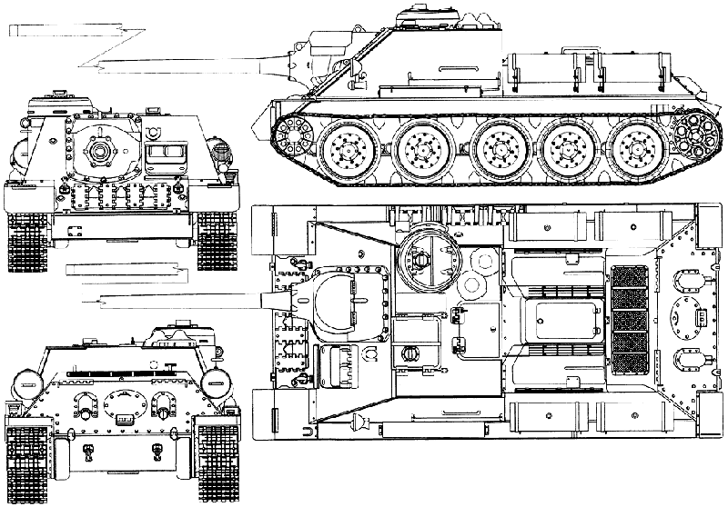

Here is some info on the SU-100 in case your not familiar.

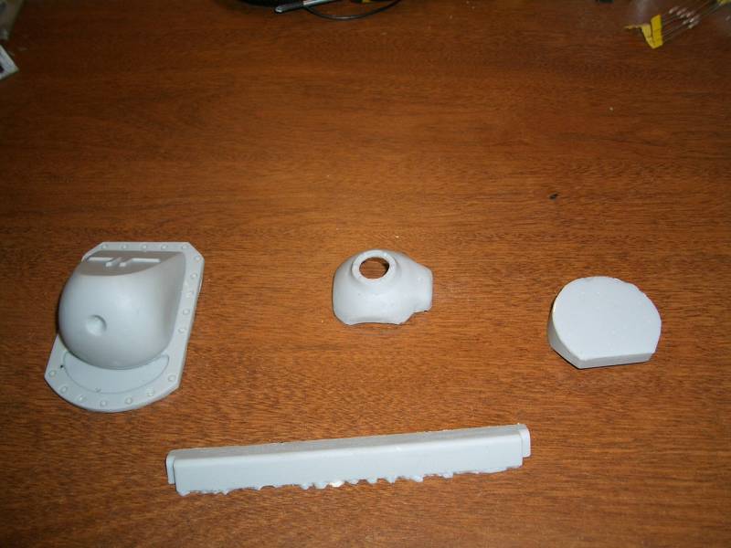

Ordered my conversion kit and T-34 from Back Yard Armor. $85 each. They arrived in about a week. Good experience with BYA. The conversion kit comes with a resin body and parts as well as the metal items shown below. The quality of the resin casting was very poor but can serve as a starting point. THe metal parts were of pretty good quality. The resin parts are thick and solid. Too thick, I had to use an air sander to remove enough material so it would fit up.

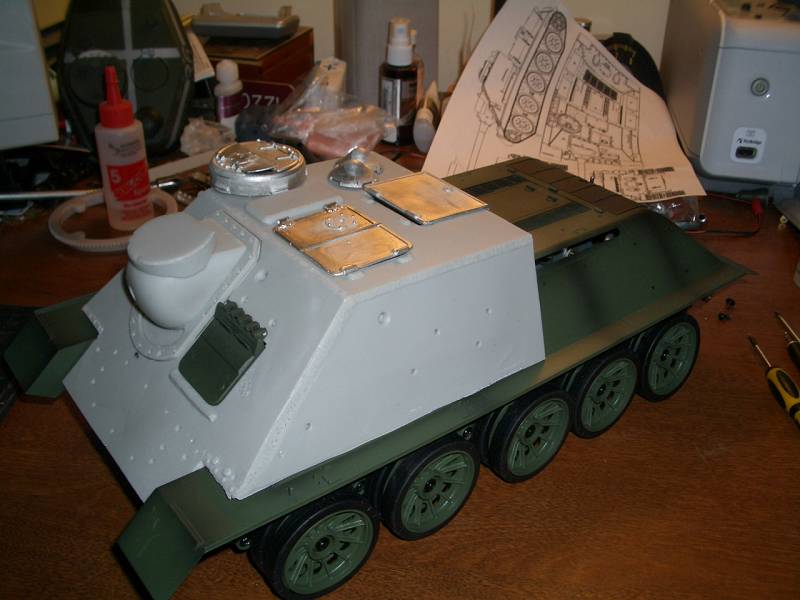

THe donor T-34 was stripped down to bare minimums and all the interior plastic removed. There will be a lot of room to work with. Mocking up the gearboxes proves I will have to do some cutting on the rear to make them fit. I still have to add an additional stiffening plate.
A little trimming on the conv kit and things are starting to fit up.

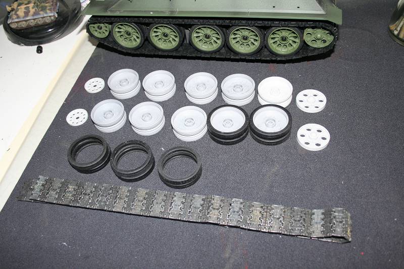

The gearboxes do not fit without modifications. I cast an entirely new rear sprocket and turned it on a lathe to get it in the correct position. I am curious how others have done it.
This is a shot from my build. Need to get back on this project soon.

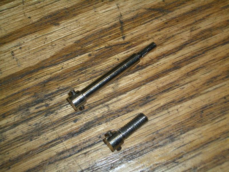

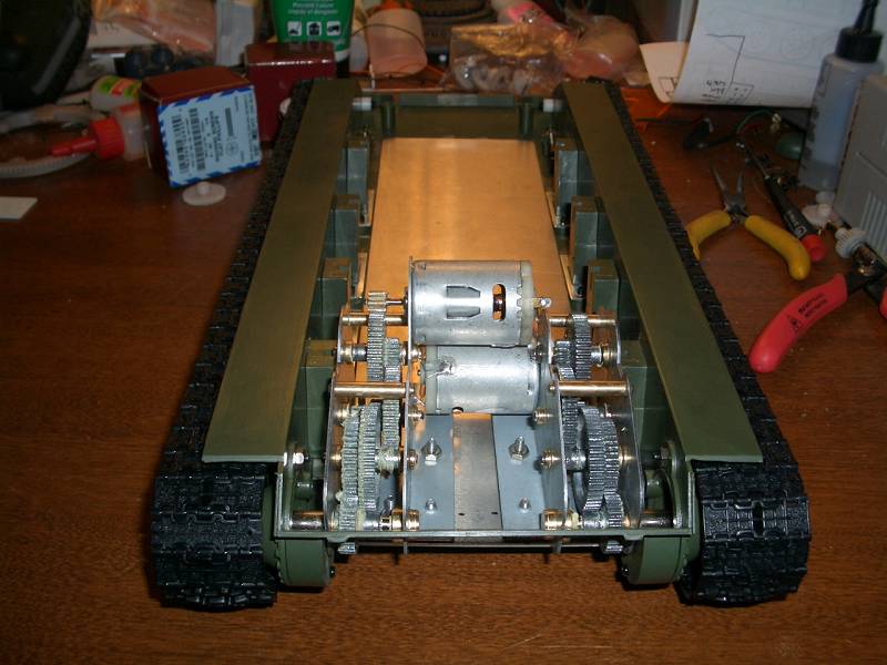

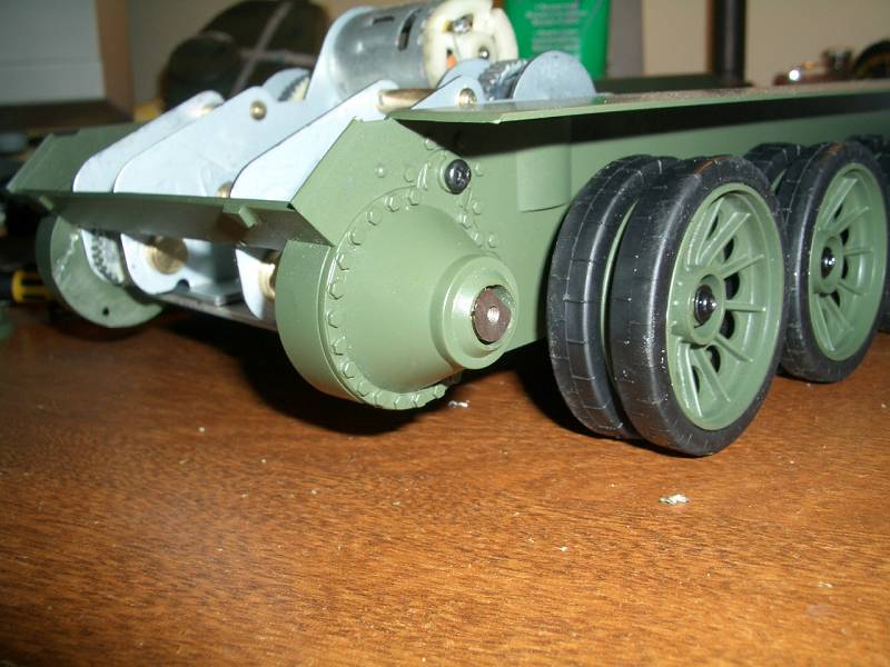

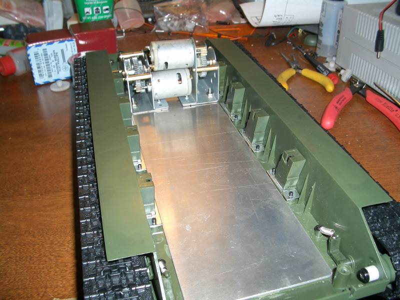

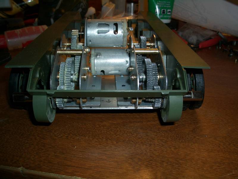

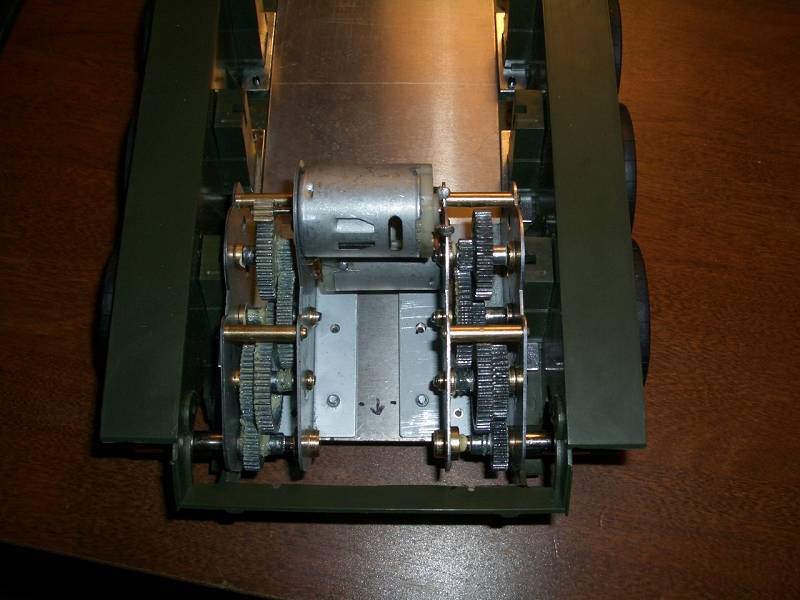

OK, my worst fears have been realized. The gearbox change will call for major modifications. Time to retreat to an easier plan. Right[sm=drowning.gif]. Experience has taught me that when confronted with a tough problem, come up with an overly complex plan then get a government grant to pay for it. Sooooo.
Had to do some trimming on the lower hull. When complete, it will call for a slight non-scale feature but it will be minimum and should be barely noticable to most. Plus it will be on the lower hull.
Once the battery box and all the internals were out the chassis was completely flexible so I cut to shape a length of .060 (that's 1.5 mm for the civilized world) 6061 T-6 aluminum. Cured that in short order. I actually now have perfect axle placement as can be seen in the pic's.
I still have to fit the drive sprocket which will be tricky but doable.
By the way, the gearboxes are for a Walker, which has a 1/4" longer output shaft than the Tiger, et al, gearboxes.

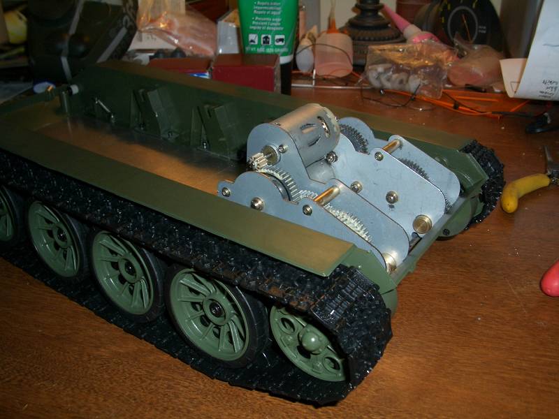

OK, I've finished off my drivetrain, at least I think. I used a die sander to take about 1/4" off each drive shaft. This puts the WSN sprocket to the correct depth. I hollowed out the WSN gearbox cover and reattached it with the stock hardware. To attach the drive sprocket I drilled out and tapped the HL driveshaft with a 10-32 thread. I took the WSN drive pin and cut it down in length and threaded it with a corresponding 10-32 thread. A before and after pic of the pin is shown below. Now I can 'screw' on the drive sprocket. If needed I will treat with Loc-Tite but I'll do that later seems pretty robust right now.

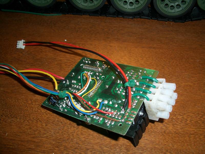

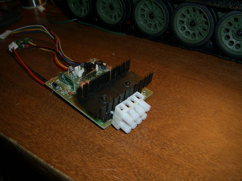

I have given my HL board the standard treatment. Big heat sink, heavy guage wire and terminal block for the motors. I have never had a problem with HL boards.

WOW pscartozzi excellent work on the su 100 i think i will have to copy your arrangement on the motors for my T34 as it looks brilliant keep up the good work

I agree. Your board modifications look excellent. I highly recommend what you are doing. I think the Heng Long boards are actually quite good for the price. Spend a few bucks like you have and I bet they are trouble free.
Tank is looking excellent. I like the metal tray. Very inspiring to see these toy tanks turned into something much more.

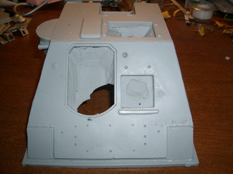

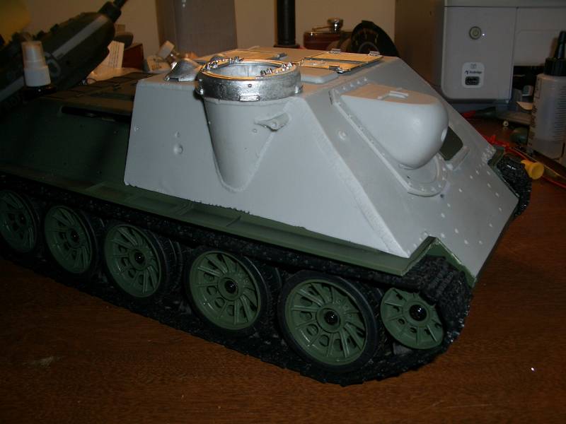

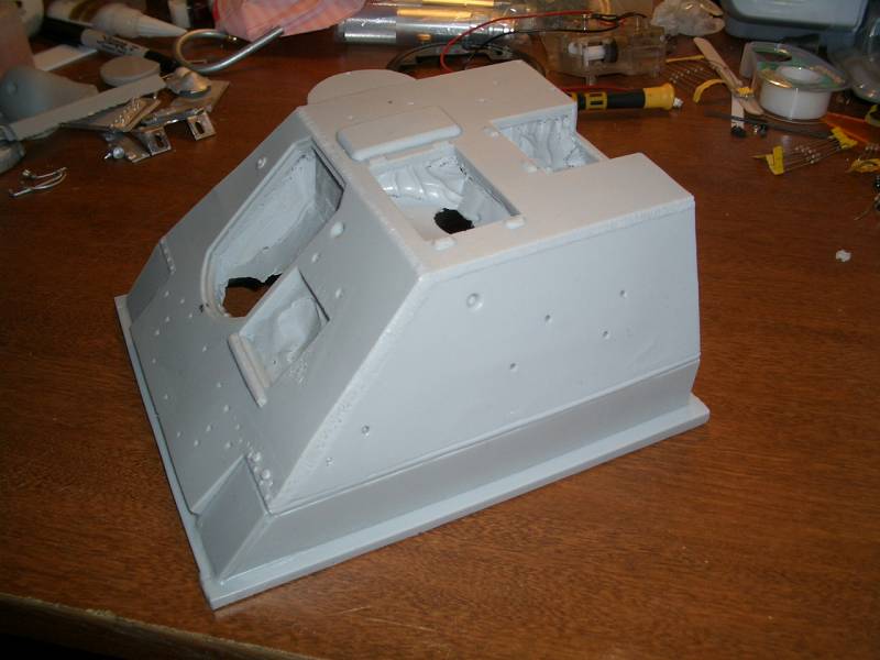

Quick update. I mocked up the HL electronics to try out the drivability of the chassis. I must say it drives like a dream. Excellent proportional control and smooth operation from the broke in gearboxes. Plenty of power if I decide to put on the metal tracks but I'm kind of a fan of the plastic. Here's a tip. NEVER drill your final elec mounting holes in an alum base plate until the tank is finished. The alum plate in my Tiger looks like it ran over a couple of mines there are so many holes in it
Since the lower hull is kinda done I have moved to fitting up the upper hull. Tons of sanding needed on the thick resin of the conv kit. Seriously, I don't know how I would do it if I didn't have an air sander. I'm going to shave the front fenders on this one as I like that look.
