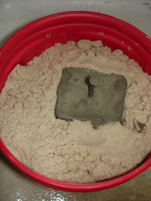

I've been wanting to make some of these for a while...could't figure how...then I remembered one of the guys on the halloween page made hands using sand soooooo......
I used play sand...added some water...made a Dragon's TOOTH from balsa. I pound it in the sand...which holds its shape...I screw in a screw and pull the TOOTH out...then add swift-set cement (pretty cheap for a container) in 10 minutes I dump the sand clean off the tooth and start another. Oh, placed a nail in the end, to make a hole so I could spike them in the ground if I want.
Here are pics:
Enjoy,
Dennis

5 made in about an hour....ran out of swift-set...Home Depot tomorrow.
