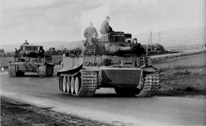

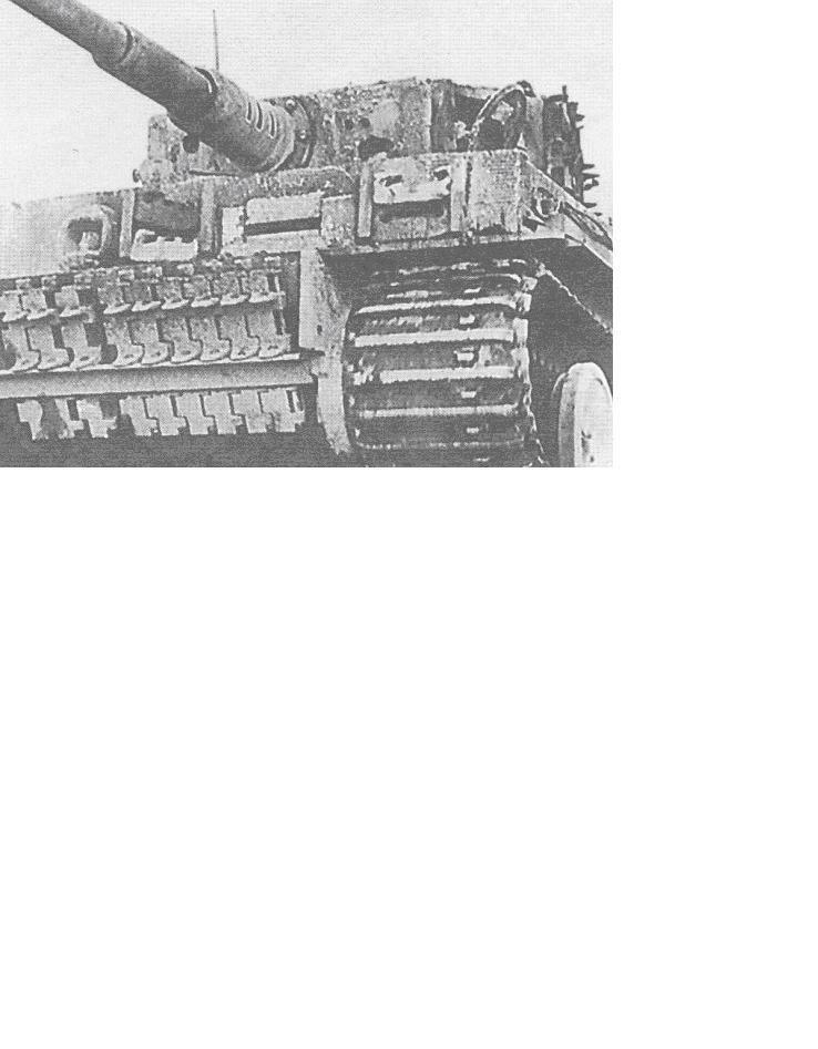

Not sure about the others the 2nd Kompanie of the 501st in Tunisia had the vertical bands for storing track on the outside of the MG and Vision Block and a bracket to hold PZIII track section between them.

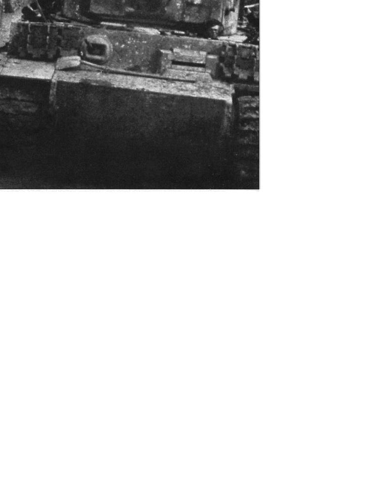

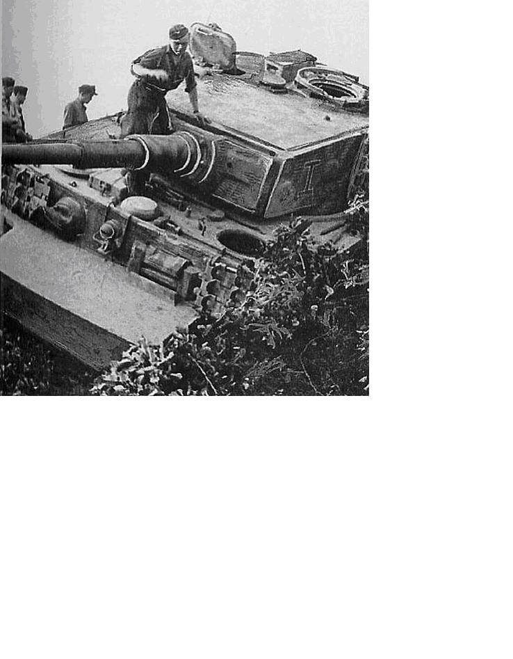

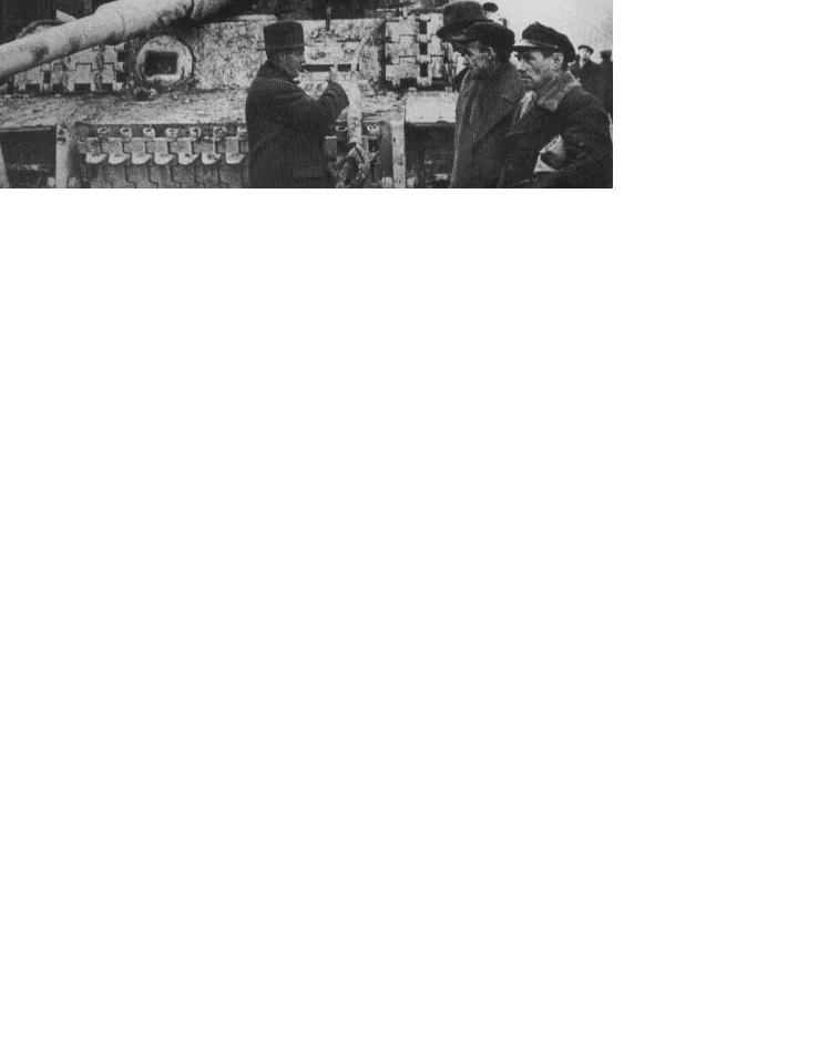

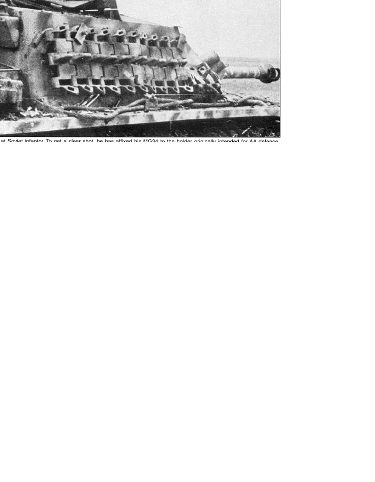

Hello Kabul,
have a look at the attached, how the links were held in position varies for where the unit was serving and wheather it was an early, mid or late model. I think it was more a question of surviveability rather than a specific method of attachment.
For the late mid and late versions - particularly on the eastern front, crews welded hooks on the front plate for a more secure attachment, at service stops or in the field - although any NON STANDARD attachment to the hull was frowned upon as welding weakened the armour!! (- a catch 22 if a 152 is waiting around the next bend for you.)
Particularly with the early versions, strong wire was all that was used to hold the links in position, and as these links were not intended for actual use, the wiring up could be rather crude.
Hope this helps you out somewhat.

part II
Images 12 and 13 are not relevant for a tiger, but just so the need to attach extra armour in any way possible.

Also looking at the pics there is a number of ways... one James shows in his pictures with Vertical bars... and two, the one 233 shows with the hooks.... Are they all after market mods... or is one more particular to later tanks?

My pictures are of the 2 Kompanie tanks of the 501st. These are field modifications done in late '42.
