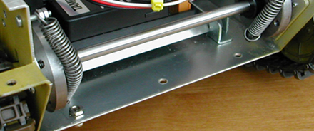

Hi,
To really enjoy running and reliable operation of your new KT model I recommend these 2 upgrade parts or the build will end up a shelf queen.
Parts:
Gearbox mount brace and the idler spring tensioner system ([email protected]).
By now you now why: Torque will bend and deform the hull at the gearbox mount points and the tiny springs in the Tamiya kit idler cannot handle the job, the tracks will flop around and either break or be tossed off.
John
ID:	738078   Click image for larger version
