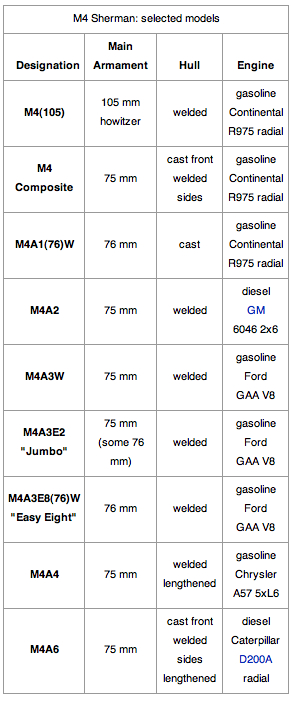

Huy Guys,
I am not profound about the Sherman hull variants.
M4A1 has casted hull.
What about other M4A2, M4A3, etc.? What are the differences?
Which type of hull do Tamiya provide in their kit?

The M4A2 was an M4 with diesel power. I think they were two 6-71s mated together. The M4A3 had the Ford Powerplant and a different angle of its glacis plate. The M4 had the Radial Engine and the M4A1 had the same engine but with the cast hull.

Wet-stowage Shermans were as-built, not field-modded, as it would have required gutting the hull, putting in the tanks, then replacing the guts. Only tanks that really got this treatment were the Brit ones that got the 17 pounders (M4's & M10's) They needed the stowage adjusted for the Brit calibre 17 pounder rounds.
The slope of the glacis did not indicate an A3, it indicated early or late hull. Early hulls had those distinctive bulges in front of driver and gunner, and almost always had plates welded over them. They also had small oval hatches that opened to the side that were hard to get out of. Late ones had a steeper glacis slope, no bulges in front for driver or gunner, and the crew hatches were bigger, aligned at a 45 degree angle, and opened at that odd angle (like on the Tamiya)

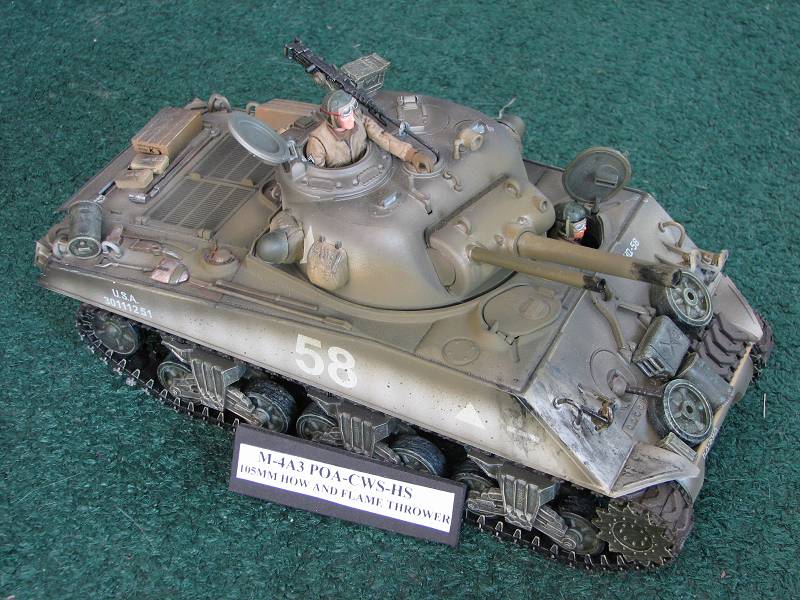

There were a copule notable Shermans left out....and as was alreadfy pointed out, many, many variations to the old M-4. The Marines modified the E5 or 105 Howitzer version by adding a very potent POA-CWS-HS flame gun, mounted in the gunner's telescope port. It was very effectove in korea. Another they mounted in M-4A2, POS-CWS-75 in place of the main 75 gun and used with great effect on Okinowa. Many Shermans were modified by mounting a small flame gun in the bow machine gun position. (We had a couple in korea, with the main flame housing actually outside bolted onto the hull above the bow machine gun on the M-46, but were not very good and discarded.)
