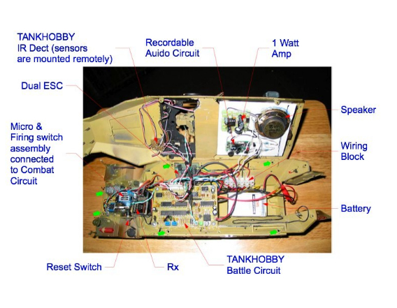

Kotori,
You can check out some of Merle / Bullyhys' builds on the S.C.A.T. site. He has been using the TankHobby Battle circuit. The TH circuit is independent of the tank drive or R/C. If you check out the TH site, you'll notice that he uses it in static guns as well as tanks. Merle has adapted his to play nicely with all the Tamiya tanks in our club. The biggest thing he has done is use a Tamiya TBU / Apple, so that everyone is presenting the same target. The TH circuit board has even been revised to include a TBU plug.
http://web.mac.com/ksoc/S.C.A.T._Pho..._Projects.html
You can try e-mailing Nick at TH or find Bullyhys on this forum if you have any detailed questions about the TH circuit.
Attached is a photo of his Half-track internals. A tank would be similar.
