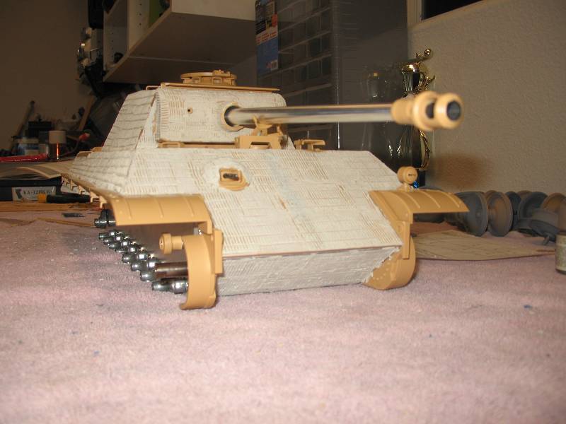

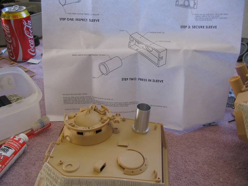

Here are a few pics of Connor's Panther, including Darl Turners mantle insert.

Beautiful zimmerit work on Connor's Panther.

Looks very nice. What material did you use for the zimm and what tool did you use?

you know,i did not get an instruction sheet with my upgrade from DT....how can i get one?can someone scan it to me?

If you look close at the first picture you can see all the tools I used. The material is called squadron putty (red label). Its a white modelers paste for plastic. Use a popsicl stick to spread it evenly about 1/16" thick, covering a 1" area at a time (dries fast). I used the cut down black plastic comb (seen to the left) and made the verticle scores. The tooth brush next to it is used to sweep out the extra putty from the comb after each use. I used a piece of T-1 fender (grey item bottom right) to press in the horizontal lines; of course any simular item can be used. Keep in mind the application does not need to be perfect because uniformity was non-existant. I have used this method on three tanks now and am very pleased. We have smash the fronts of our T-1s into hard objects such as rocks and the stuff will not come loose. Its not as hard as it looks, my son Christian who is 14 did his T-1.

The third pic is the best photo I have. The installation is very easy, almost self exsplanitory. Flat side of the lip goes down and add a little CA glue or House Hold Goop to the lip where it contacts the inner mantle.

Nice job on the zimmerit. How did you do it?

Thanks for the explanation Steve and for taking the time. I have read SO many zimm "How To's" that I had no clue until your post. When I do get the Panther I am going to give it a go ... of course after a few tries at some blank styrene that is!
