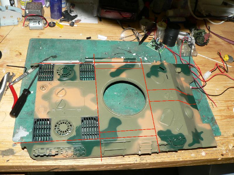

YHR how did you decide what cuts to make in the top deck? Where those simply approximations?

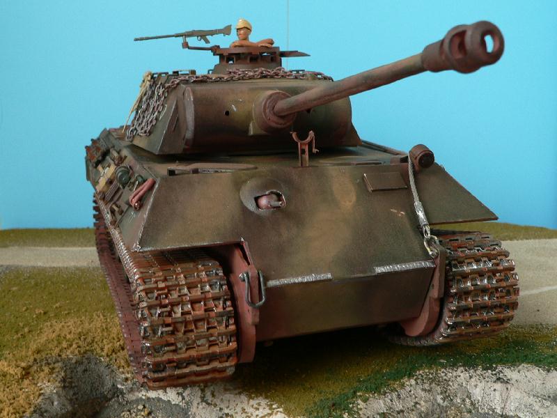

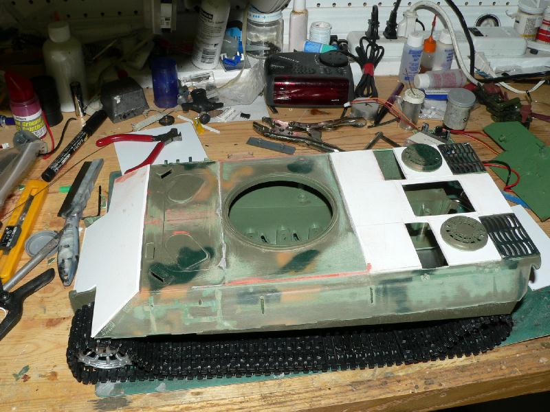

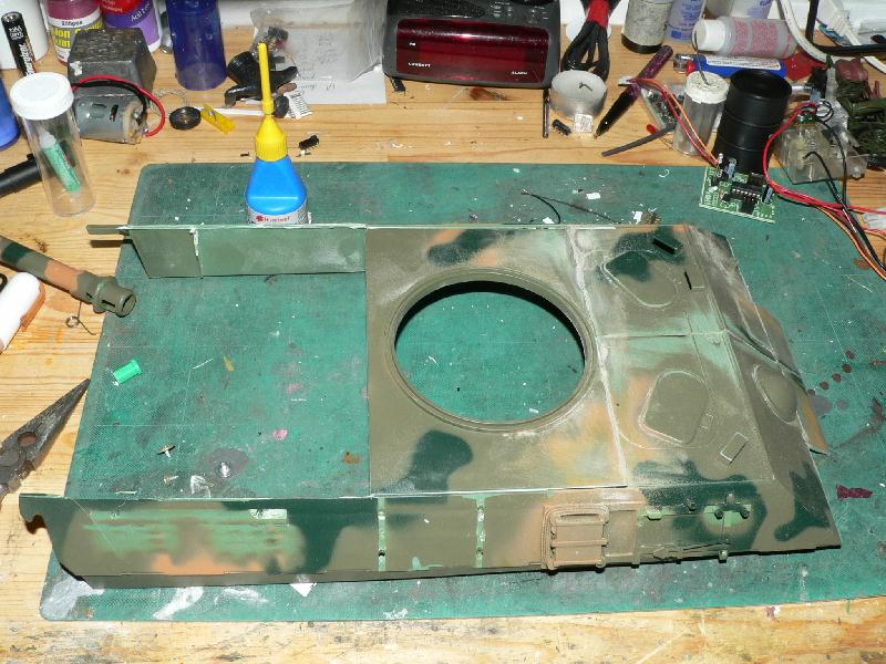

Here is a picture showing where I made the cuts and what I added for length. I hope this helps. If you are going to keep the Tiger tracks then this conversion is a good one. However if you want to go to the narrow Panther tracks, then you may want to remove material from the overhang. I think this would end up being much harder.
Also If I did this again I might make my cuts based on how much room I needed to stuff the stock HengLong motors in the chassis. I was oh so close, but had to switch out the motors. Another of couple of mm and I could have got by with the stock stuff.
As I mentioned before my Panther has lots of errors, but from 3 ft away it looks OK. I just refer to it as a King Panther II.

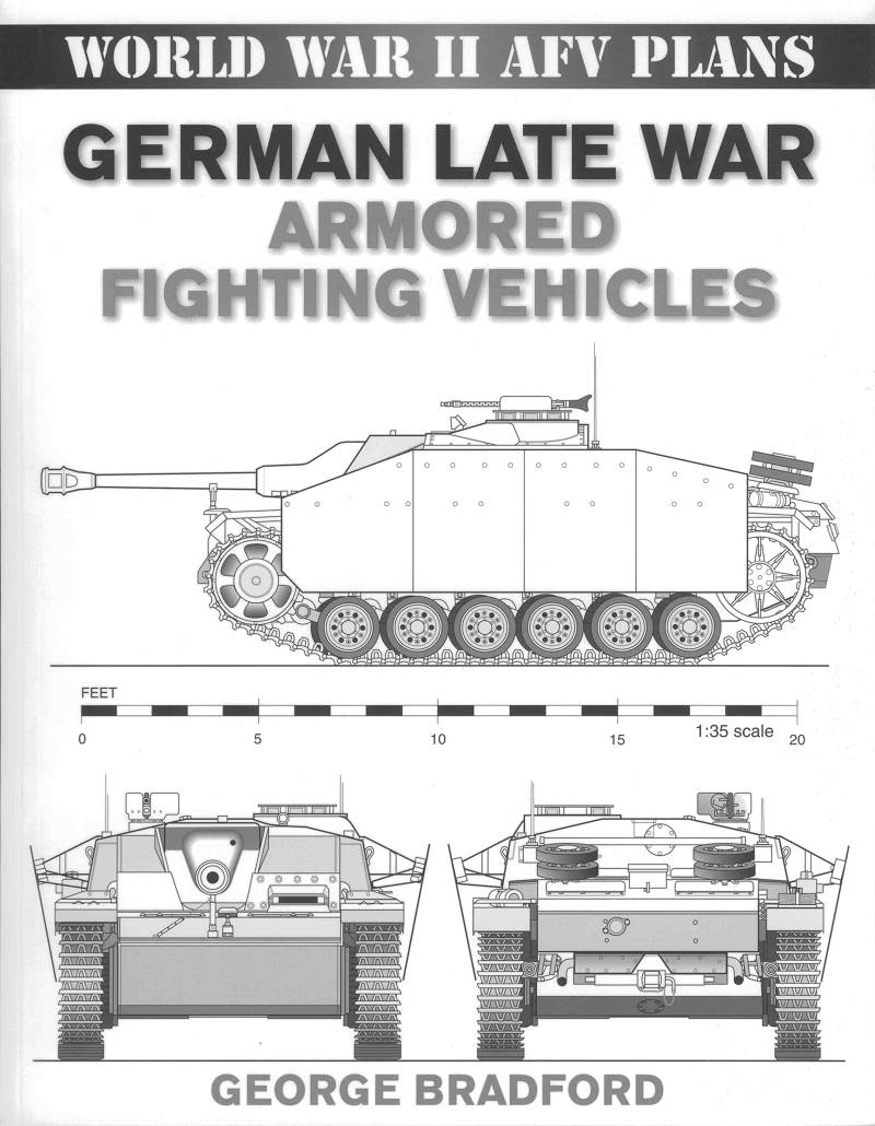

Check out World War II Armored Fighting Vehicles Plans series by George Bradford - specifically the "German Late War". $15 US retail
What you get are 3 and four view scale of various AFV's
Included are the Panther A, Command Model A, Panzerbeobachtungwagen prototype (observation), G, F, and FlakPanzer.
