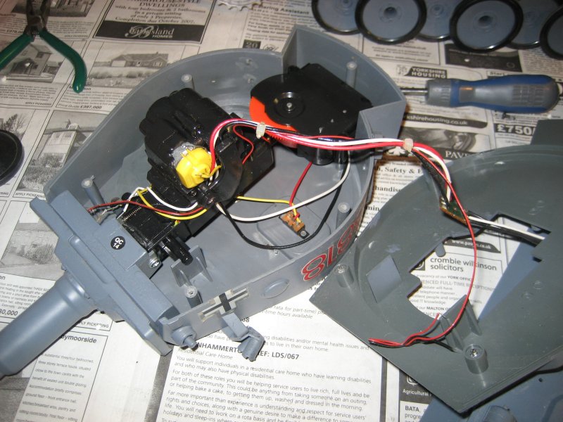

I was pleased as punch when it finally arrived in the post, had a play with it on the kitchen floor, great fun! I knew before I bought, though, that there were a few faults with it, mainly: one front road wheel missing, airsoft gun does not fire, turret rotation problems, top hatches and tank commander figure missing.
The turret rotation ring looks fine, all teeth are present and correct, I can only assume it is something in the gearing or the fact that the turret is so loose in it's fitting to the upper hull.
I notice that there are three wires not connected to anything coming from the airsoft mechanism - yellow, and red and black. Is this normal? What do these wires do? Yellow goes to the safety switch, the others I think go to an LED next to the gun (there are two LEDs there - red and clear).

With the wires not going anywhere, are they literally not going anywhere?? I see two wires coming from the turret going down - might be extended power switch

The yellow wire pops up next to the gun motor and is just waving in thin air, the black and red wires went into the tank hull and are also waving in thin air, it looks like they were never connected up as there's no sign of solder on them. The yellow wire might have come off the motor, which would explain why the gun does not work. You know how these things are put together... might have been fine when it left the factory and then just come off due to a poor solder join and some vibration.

The rear screens are historically accurate, just those don't look historically accurate! Look in the FAQ or do a search for the turret wiring diagram. The suspension arm can be easily replaced, you need a brass standoff and a M3 or M4 screws, again a search will show you lots of photos. That looks like an old 2-speed non-smoker with plastic no-clutch gears, right? If so, the middle buttons are for saving a maneuver into memory. You'll really want to upgrade the tanks electronics to smoke and sound. The 2-speed controller is why the kids beat the tanks up, they take off too fast and bang into everything. The other electronics will give you proportional control even if you don't care for the smoke and sound and you'll get a new transmitter with replaceable crystals. Looks like you've got your work cut out for you!

I discovered that the turret rotation gearbox has a broken gear in it. Damn. I don't suppose one can get spare gears??

I reconnected the yellow wire to the gun motor, it pulls the orange plunger back and releases it at speed, but the pellets don't seem to be firing. It could be something to do with the channel that the ammo rolls down, I'll have to look into that further. At least the mechanism appears to be OK.

The gun elevation gearbox is fine, it's the turret rotation gearbox that's got a damaged gear.
I shall have another look at the gun and see if I can find out what the problem is.
