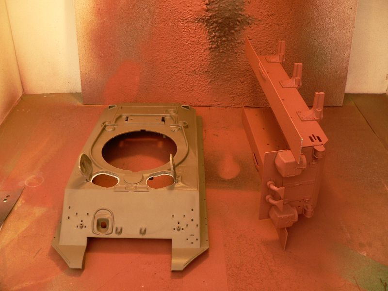

Time again for another Sunday Night Foto Fun. Again this thread is meant to be a showcase, or at least a look into members workshops to show others what you have been up to. I Imagine you will be seeing a lot of my progress on my Sherman for the next little while as I stumble through my first Tamiya Tank build.
It certainly is different then the Heng Long line. My mode of operation with the Heng Longs was to pull them apart and then just wing it putting them back together, better then they were. The Tamiya of course has bags of parts and a booklet of instructions. Nothing too intimidiating, you just do one step at a time, and when you get to the last page you will have a tank.
I got started yesterday and got the alumium chassis ready for paint, and then painted it. I have bearings on order, but I think I will build it with the bushings and add the bearings later.

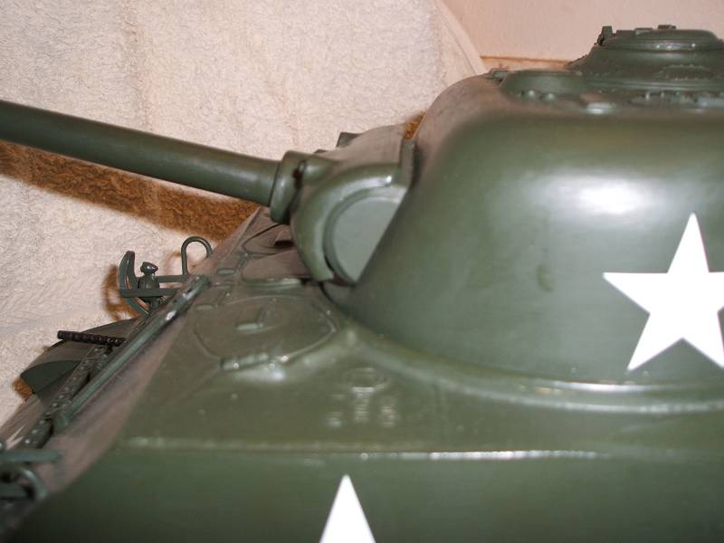

Ok this is attempt no. 2 at pic uploads of my partially finished Sherman...Please note it's no showcase and it's my first attempt at a plastic model and it is only a small detail change to the end plate section of the gun mount...theres still quite a lot to do with this section...Oh and please excuse the dust and my "marginal" camera skills.

Gigantohawk that looks really good.Makes the area look much more solid.May have to do the same to mine.
What did you use to do it?
Cheers.

Wow, thanks for the comment Wight. I think I'm going to like this Hobby and Forum...I've posted some pic's showing the Gun Mount detail of a 105 gun mantlet E8257 out of "Walk Around M4 Sherman"...It's a great source of reference and would make a great extra xmas present if you don't already have it.
As for my mod, it's made out of semi-circles of plasticard glued on to sides of the mount then the perifery filled in with white milliput to a concave section if possible... Use shaped wooden tools dipped in water to achieve a smooth finish,BBq skewers are ideal for this... The exact thickness of the plasticard is up to you. I tend to work by eye a lot... Just use your skill and judgement in the final choice...The gun and mantlet will almost certainly have to come off for you to work this area and whilst you are at it don't forget to fill the gap across the bottom of the gun mount with thin plasticard, cutting small slots in the card to allow the mantlet flanges to slide up and down freely...
I hope this helps.
