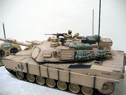

I like what you've done with the M1A1/Ex-Leo2, Its very seldom to see a proper RC M1 Abrams in 1/16 scale
Where did you bought your Hobby zone tank and how much? Hows the accuracy of the tank details? I see the smoke
dischargers are quite smaller than actual. Can you comment on this.
I saw Tankzone.com in the UK is selling them, now in Iraqi freedom Camo, for 129 pounds.
I would like to weather mine M1s like this (I have 1/24 & 1/12 scale).

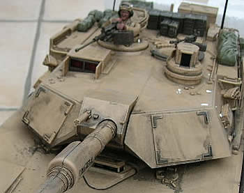

ORIGINAL: StoneColdFreak
I spent an hour or so today trying to decide how to make the upper and lower hulls fit together and I wound up having to cut both in order to get close. For the Abrams upper hull, I removed everything that was sticking down with my trusty Dremel, replaced the fellow in the turret with an Elite Forces soldier and cut and labeled the wires.
I hated to have to chop up the lower hull of the Leo, but it had to be done. All of the cuts were made with a cutting disc, so I will need to go back and even everything up and make it all smooth, later. Now, I need to start cutting some sections of Plastruct to make the coupling of the two hulls more believable. I have a long way to go and gaps to fill, but I think that I will be able to pull this off, even with my mediocre skills. [sm=thumbup.gif]
the top your using there is the same one as buddy has. noted the "rim" looking thing on top. most visible in the picture close to the commander dude.
I bought my tank used from a guy on Ebay, but here it is (just a little different): http://www.hobbytron.com/RCTankM1A1A...TRJHC0817.html As you noted with the smoke dischargers, the details on the tank are not great, but look okay from a distance if you don't know what you are looking for. The tank itself does not move realistically and has rubber tracks, which is why I wanted to install Tamiya electronics and lower hull.
I would never buy one to use "as is" since they are very toy-like.
I hate that wheel (spare?), but I'm not going to remove it and do any body work untill I get it working correctly. Maybe then I will make a better set of rails for the turret, too.

ORIGINAL: The_Stuff
M1A1 had a blank plate, often covered by a spare wheel, M1A2 has the CITV (Commanders Independant Thermal Viewer)
The big bulge on the rear corner is the APU (Auxillary Power Unit) - I hate them in this position, and usually put them in the bustle rack (more often found there)

Well, I guess I will leave the spare on the tank. I don't care for the location of the APU (nice to know what it is called) either, but I dislike trying to relocate it even more.
Thanks, Wackywheels. [sm=thumbs_up.gif]
