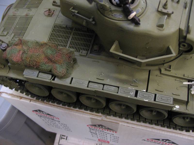

ive noticed alot of people have removed the sideskirts from there pershing. is this alot of work to do? ive been wanting to do it but not sure on how well i can do it. i cant see how people can get the edges soo nice and smooth this is why im worried about doing it. and also whats the best tools to use?
see pic for the line i mean!

Everone has their own best methods, but I have always used a Dremmel with a steel sawblade. Follow up with a sandwheel to even it up. The HL and Tamiya Pershing is a Korean War (late production) model so you may want to fold up the 2 center sand skirts for MG ammo stowage and discard the front and rear sections. they were hinge mounted and could be folded up for track work. The skirts were a real pain in the butt and most were simply removed and tossed. The Marines came up with the idea of using them to carry extra MG ammo boxes. (Direly needed facing thousands of Chinese in mass charges.) I have included a coupleshots plus a local M-46 with original sand skirts to show the bolt positions.(same chassis) When the skirts are off, be sure to add the bolt holes. If you leave them on, at least "weld" a bar or cables to hold the ammo boxes in place on the fenders where HL put them. Some Pershings in WW II left the skirts on, but they never entered the war until April 1945, only 6 months before the end. Between WW II and korea, crews had time to learn of the disadvantages of the skirts and once they left the "pristine" training environment of stateside, off they came.

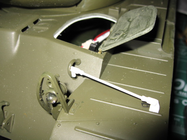

Hey Pattoncommander,
That is the first time I've notice that, where did you get the hinges? I have two Pershings and one i will definately cut off the side shields, but for the other this might be a cool mod and still give it the ability to drop down the sides for a different look!

The hinges came designed that way on M-26 and many others. Hinges are welded onto the fender and 9/16" bolts locked tham in place. If you want an on-off thing, you're going to have to design some way of sticking them on and taking them off. As I recall, the front and rear sections had 2 hinges and 4 bolts to hold them. They dismounted like a door hinge....just slide an inch or two and pull off.
On a plastic, operating model, that's going to be tricky, unless you get some model RR hinges and I don't even want to think about or screws that size. [:'(].

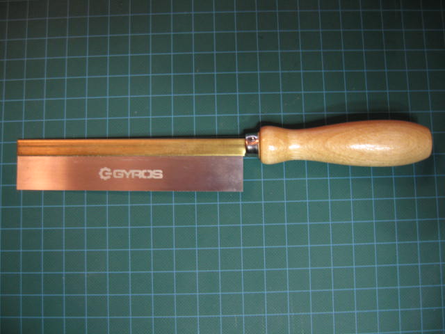

hdbeast's Avatar
Joined: Jan 2007
Posts: 1,332
From: Santa Rosa, CA
Default RE: removeing the sideskirts on the pershing
britishtankman
The razor saw may work the best, it's very thin and will cut fast, this is a pic of the one I have, picked it up at my LHS for about 10.00 USD and have found many uses for it. I have used the thread cutting for many hatches and that workes the best for them it will take a long time to cut the sideskirts with thread but can be done.

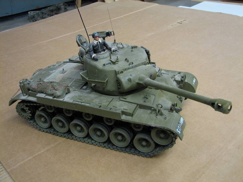

ok started to cut em off looking ok just need some more tidying up then should be done... mite just leave the fenders on there not sure yet tho.

looks good much better off IMHO

Britishtankman:
Very neatly done. I hope i can be as neat if I get one of the HL Pershing units..
