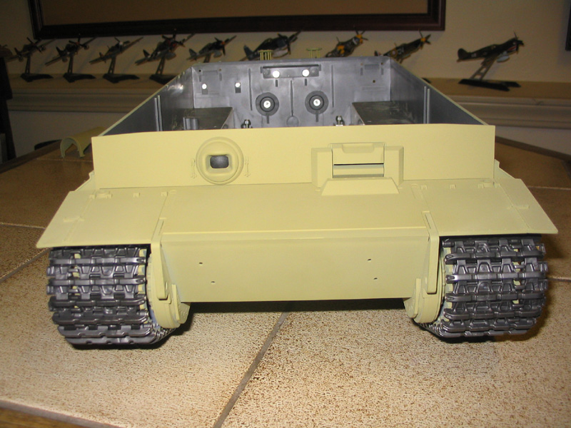

Well I'm taking my time with this kit but I am making progress.

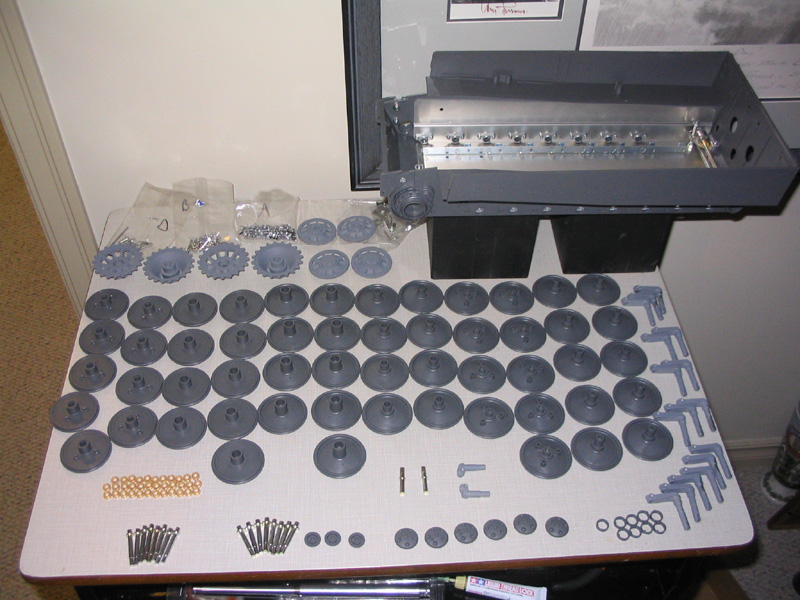

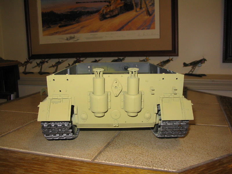

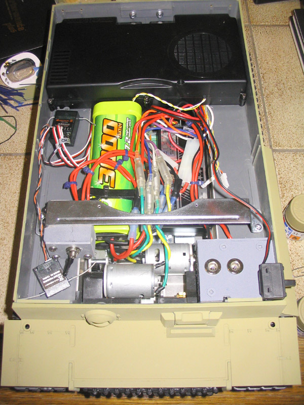

Well here are some more pics.
I covered up the screws on the back because I'm going to go with the Kursk paint scheme,leaving the exhaust guards off.
The mud flaps on the back are metal.
I'll put more coats of the base color on once she's all together and I have my new airbrush.

Dazman,
I am very interested in the book / magazine in the last picture. What is it and where did you get it?

I see "Modelers guide to the Tiger" in the bottom right

ORIGINAL: lanierrl
Dazman,
Thanks for the comments guys.
Yes, the book is called The Modeler's Guide to the Tiger Tank and the best place to buy it from here:
http://www.greatmodels.com/

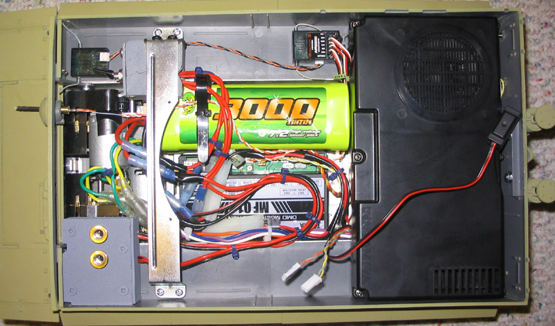

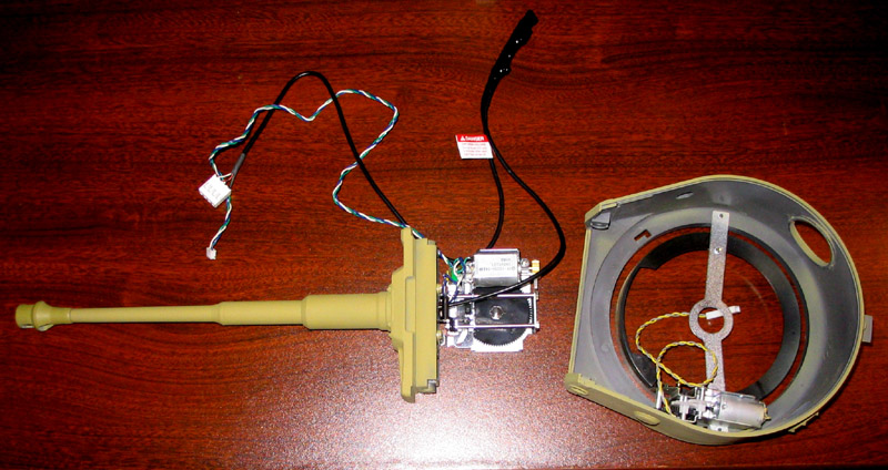

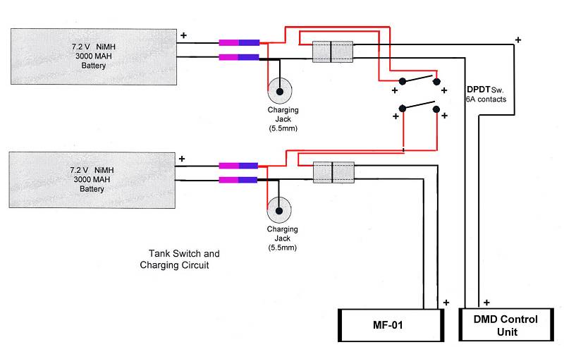

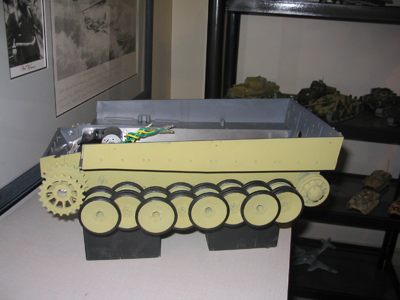

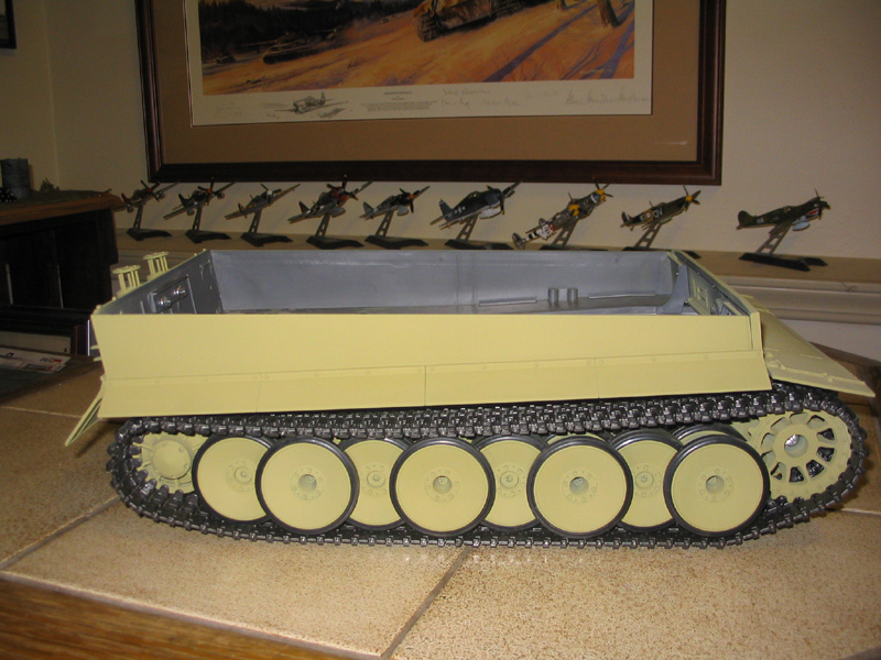

Okay, the charging circuit is now complete and installed.
The turret build is under way and progressing well.
I'll get her done yet.

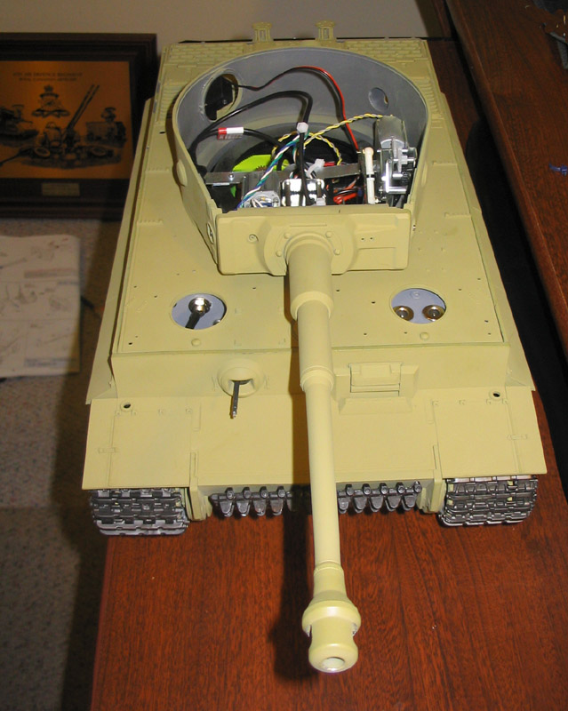

Here's the wires all nice and neat.
Turret on and everything works perfect.
