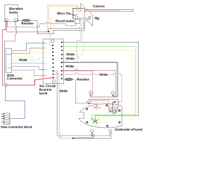

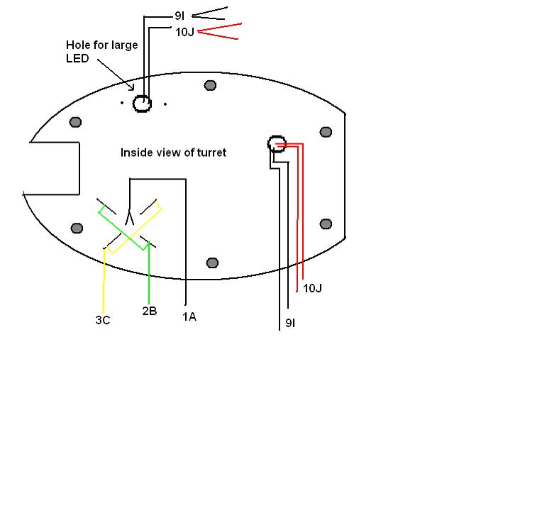

The schematic:
Please note that this was my machine, and if the manufacturer is anything like HL, the wiring colours MAY be different!!
I've not done anything like this before, so please excuse my deficiencies.

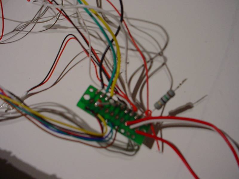

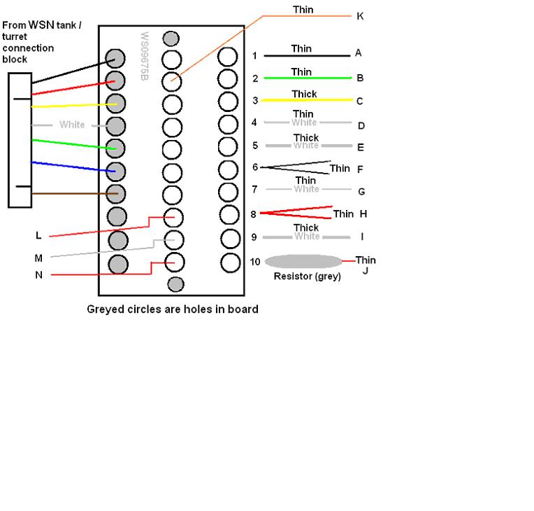

Turret circuit board:
Connections as follows:
Connections:
1A – Thin Black - To middle 2 x connections (wired together) on turret top IR sensor
2B – Thin Green - To front left leg of turret top IR sensor (this then goes via a green cable to rear right leg of IR sensor)
3C – Thick Yellow - To front right leg of turret top IR sensor (then this goes via yellow cable to rear left leg of IR sensor)
4D – Thin White - To cannon end flash / IR emitter (??)
5E – Thick White - To microswitch on cannon body (returns via black cable to ?)
6F – 2 x Thin Black - To black wires on the 2 x r/h side turret “hit†bulbs
7G – Thin White - To cannon warning LED on turret roof
8H – 2 x Thin Red - To red wires on the 2 x r/h side turret “hit†bulbs
9I – Thick White - To 2 x thin black wires for the “hit†bulbs in the commander’s cupola
10J – Via a resistor (grey) - to red wire to cannon warning LED on turret roof, then via 2 x red wires for the “hit†bulbs in the commanders cupola.
K - Thin orange - goes to cannon end flash / IR??
L – Red - goes to red side of the 2 x turret “hit†bulbs
M – White - goes to black side of the 2 x turret “hit†bulbs
N – Red - goes to elevation motor terminal (marked as "2" on that diagram)

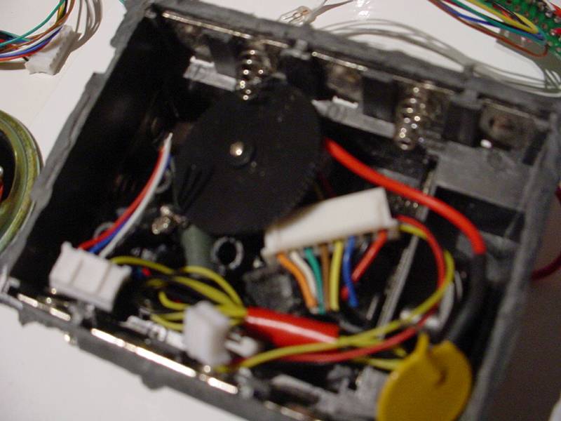

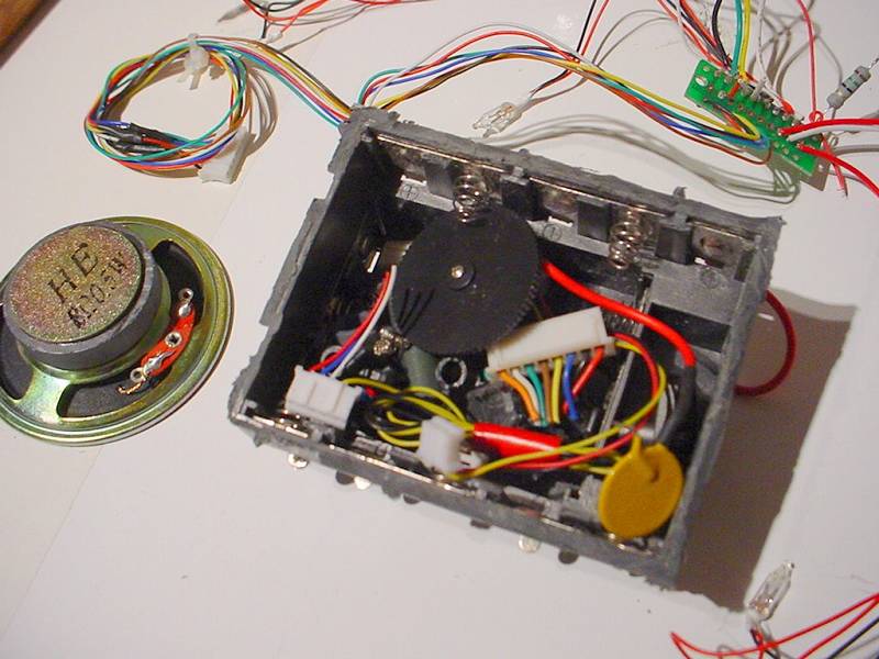

This is the tank as it was:
Edit: Sorry about the grainy pics (wife's camera was the only one available at the time, and I don't know how to use it...please don't tell her I'll never live it down)
Hopefully they can be of "some" use to someone.

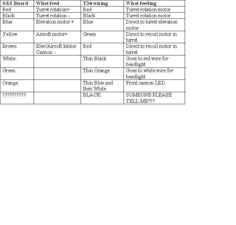

Tim

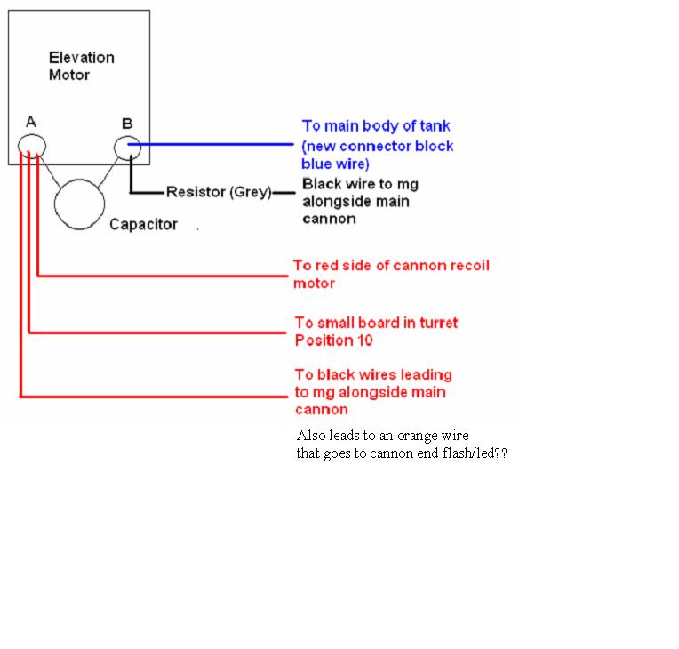

Not sure if this will help, but, here are my connections for the connector from HL electrics to the T34, using Wackywheels guide for the first 5x connections:
Edit: THAT DIDN'T WORK, LET ME THINK ABOUT THIS.....

Cheers Fv....
Right lets try this:
Mmmm should be OK. OK, this is the wiring for Wackywheels connector (chocolate block UK) as best as I can tell anyway!!

..the warp plate drive..oh no, that was the first part I pulled on the IR change. OK guys forget all that stuff above, its going back in!! LOL!!
Fv OK, so the black wire connects to what on the S&S board connector, please?

you need to find the airsoft firing warning L.E.D that is linked into the BB motor
try this link for wiring the cannon L.E.D to the main board using the "k" button but it wont fire the cannon recoil on the T34 just noise ,flash and track recoil heres the link http://www.dougstigerparts.com/led_cannon_flash.htm
going to investigate further how to do it
using the BB motor up stick only as i did sort it on my tiger gun upgrade (forgot to take a photo ME BAD) and it works a treat

Sorry Guys trying to be too clever there!!

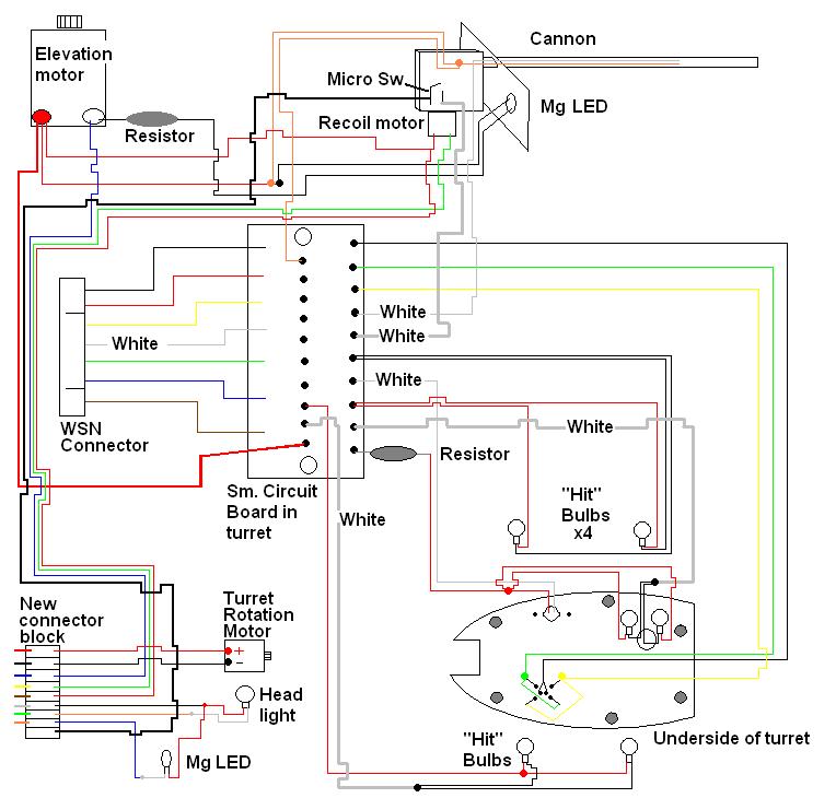

Right, the last schematic includes the wiring needed for the T34 headlight and hull mg to operate. This uses the HL electronics via the connector block. If you follow the advice from Wackywheels thread, he uses a cheap multi connector strip to mate the HL wiring loom with the WSN cabling headed for the turret. In the UK we sometimes know these connectors as "chocolate blocks" because of their similarities to a bar of chocolate, but basically they are just lots of screw terminals in a long strip.
I've shown the wires FROM the HL loom coming in on the l/h side of the connector block. All the wiring on the right hand side is WSN stock colouring as per my machine. The only wire I have a problem with is the thick black wire which sets off from the cannon mounted microswitch. I have routed this to the connector purely because with my limited electronic ability, I don't know where it SHOULD connect. I assume it has something to do with the cannon flash, but as to where it would need to be attached ........
So, in a nutshell, other than the wires entering the connector from the left side, this is all WSN turret wiring. I omitted the wiring inside the hull because Wackywheels had done a far better job on his thread than I ever could.
By the way, this IS a WSN machine, (it says so about ten times on the box and transmitter!!)
One final update guys:
Missed-off a wire!! On the Recoil motor at the green wire connection, there is also another blue wire attached. Now I somehow missed this and I "think" it went to the mg alongside the cannon on the mantle to the thin black wire, but unfortunately this wire has snapped-off in all the moving around, so cannot be 100% sure on this.
I was hoping to double-up the wiring for this mg so it fired with the main mg, but once again one of the LED legs have snapped off at the LED base, so the cables are useless, oh well never mind.

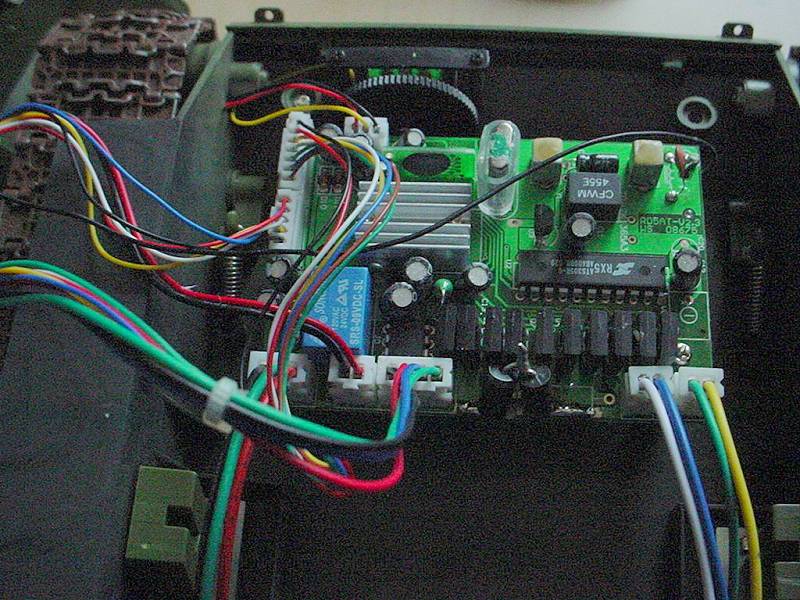

Ok, I have followed your wiring diagrams and:
-gutted the main board
-removed the existing IR system (although I have not been able to find the IR emitter, is it in the cannon????)
-prepared the turret wiring for a new wiring block.
-wired the turret MG to the Hull MG.
-Removed the battery compartment and glued the battery hatch on.
-Removed volume switch and RC Crystal hatch that was glued shut (***!)
-Put filler in all the holes left in the underside.
Question:
I am mounting an RX-13 board inside the T-34. What colours are the positive and negative wires running off the motors?
For your mystery blue wire, I have a thin red wire and thin black wire with a resistor on it running off my turret MG. There are 3 wires coming from the cannon, thin red, thin white, and a thin black to thick blue. (Not sure if this helps you)
Question:
