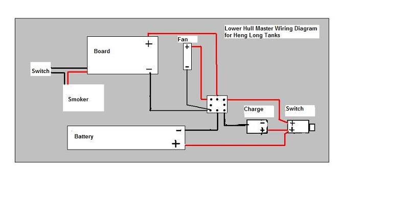

Has anyone posted in detail, how to mod the battery connector to a hatch for easier charging?

I got my dean connectors and dont know how to install them or what else I need. Any help would be appreciated

Does this help? It's how I wire up all my tanks now.
