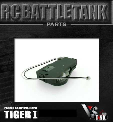

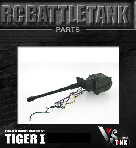

Have you looked at the new airsoft units from Toy East for the little 1/24 tanks? They have the elevation unit mounted to the turret ring under a new, more compact airsoft unit. Let me see if I have some pictures....
Yep, Here ya go:
ID:	884334   Click image for larger version
ID:	884335   Click image for larger version
ID:	884336   Click image for larger version
Old 02-21-2008 | 03:49 AM
borealis's Avatar
Joined: Jan 2007
Posts: 1,547
Received 17 Likes on 15 Posts
From: San Paolo Solbrito, ITALY
Default RE: recoiling bb on tiger
Is that an airsoft unit? I can't see the loading hatch...
Old 02-21-2008 | 07:26 AM
swathdiver's Avatar
Joined: Mar 2006
Posts: 5,031
From: Port Saint Lucie, FL
Yes!

The guy at Toyeast told me that the 'compact gun' for the Tiger is indeed an IR UNIT ! That's for the VSTank IR series!

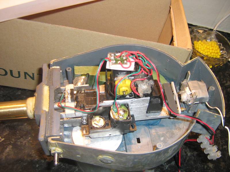

Old 02-25-2008 | 07:01 PM
Joined: Dec 2007
Posts: 679
From: nelson, UNITED KINGDOM

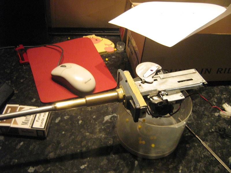

hi guys ive done it ive got a bb firing recoiling gun but it was a tight fit see photos
ID:	888620   Click image for larger version
ID:	888621   Click image for larger version
ID:	888622   Click image for larger version

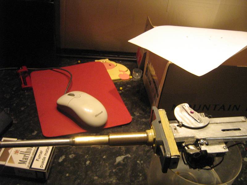

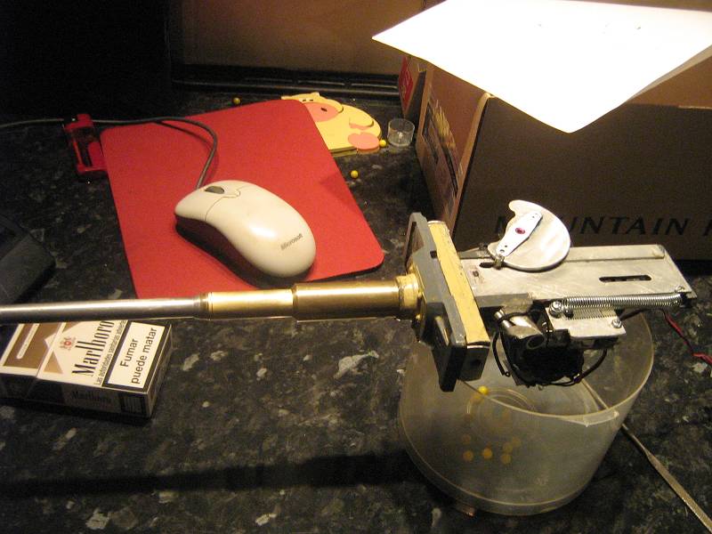

Old 02-25-2008 | 07:10 PM
Joined: Dec 2007
Posts: 679

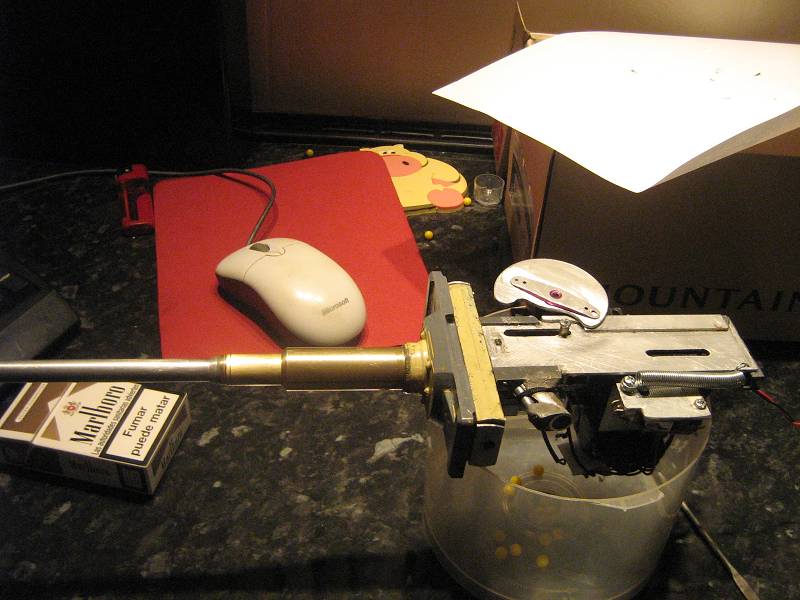

as you can see done a lot of messing home made barrel the hacking about insde still got to sort out turret ring but i think i have an idea for that
ID:	888625   Click image for larger version
ID:	888626   Click image for larger version
ID:	888627   Click image for larger version
ID:	888628   Click image for larger version

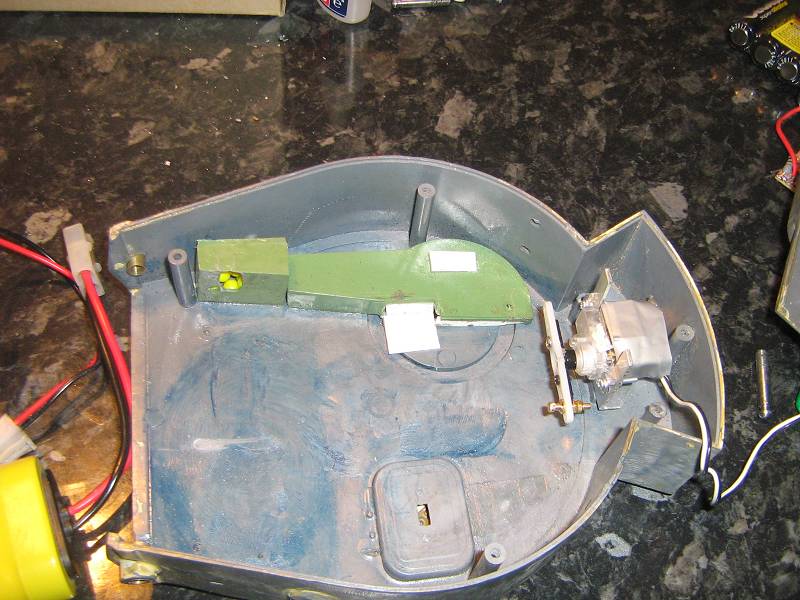

just few more photos tried too many so doing them in fours and fives
ID:	888634   Click image for larger version
ID:	888635   Click image for larger version
ID:	888636   Click image for larger version
ID:	888637   Click image for larger version
Old 02-25-2008 | 07:32 PM
Joined: Dec 2007
Posts: 679

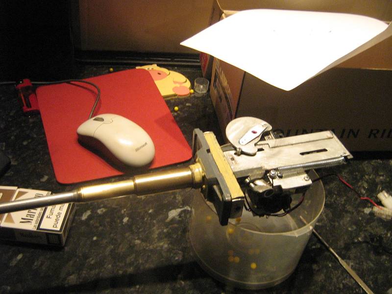

the secret is the mico switch on the side when the bb cylinder comes back to the point of firing it activates the mico switch which turns the servo just slightly which allows the gun to recoil that opens a second micoswitch that turns the servo back to the normal postion sub min servo for elevation
ID:	888662   Click image for larger version
ID:	888663   Click image for larger version
ID:	888664   Click image for larger version

Old 02-25-2008 | 07:42 PM
Joined: Dec 2007
Posts: 679
also the sharpe eyed will notice i had to move the turret ring back about 5mm to give me clearance when the gun recoils it now pivots where it should ie the mantel just a few things to iron out bb feed sticks a bit nothing new there then the drive ring to sort out by the way the turret i was going to scrap be cause the person who had it before me panited it with a tar brush you should see the body might have to scrap if i cant get the paint off
