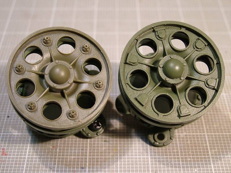

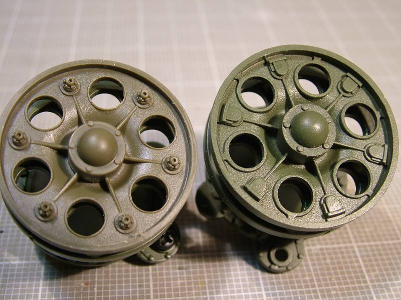

Attached are two photos showing the difference in detail between the Trumpeter and WSN idler wheels. The Trumpeter wheel is on the left (more of an olive green) and you can see the locking nuts with cotter pin detail as opposed to the WSN flat detail on the right. The front half of the Trumpeter wheel aligns perfectly with the WSN back half, simply screw them together.

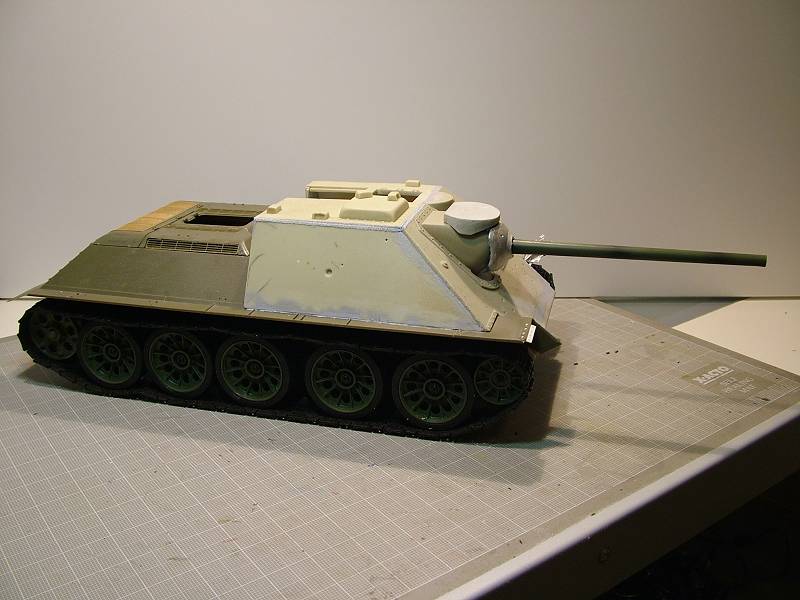

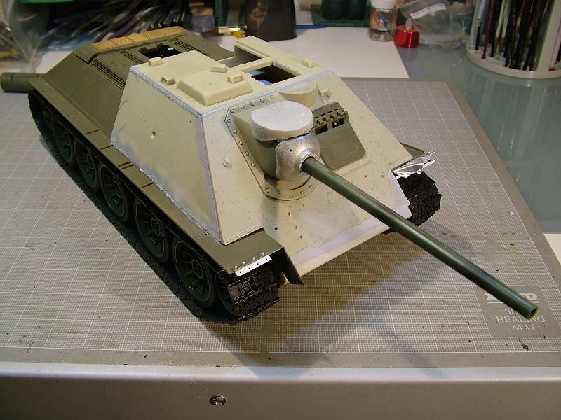

I chose to use the WSN barrel, it's smaller in diameter and fit better than the Trumpeter one.
After stripping all of the other electronics, I bored out the mantlet, found the center pivot point of the gun then removed the flash unit. Here the gun is only mocked up in place, but I have an idea that will give me both elevation (probably not depression though) and side to side movement of about 15 degrees. If all goes as planned I will be able to use the stock recoil as well. I initially thought I could only get two movements, either traverse and elevation or elevation and recoil, but not all three. I'll post more as the engineering portion moves forward.
