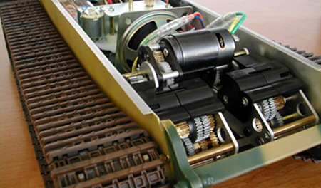

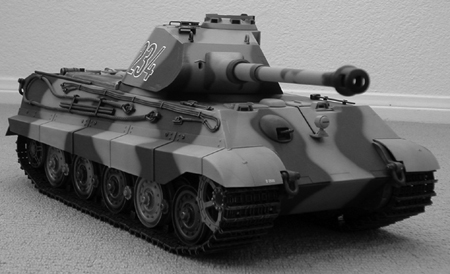

0. You will need a turret mounting ring that sits atop the deck plus:
1. Visit ETO Armor and they can help you determine the turret parts you still need (they do have the rear hatch, co hatch and might have a manual or pdf of a manual):
http://www.etoarmour.com/products.php?ViewCategory=9
email Bob at ETO with your questions and use both email addresses:
[email protected]
[email protected]
2. Also try this site and email Willy with build questions and ask for a pdf manual :
http://www.customrcmodels.com/shop/impact_upgrades.htm
3. Once you know the parts numbers for sure for your missing turrret parts go to Tamiya USA. They still stock some of the RC KT Porsche Turret plastic parts.
http://www.tamiyausa.com/product/rcp...s&kit_id=56007
4. I turned a static Porsche KT into a DMD, sound, battle unit runner with Willy's big motors, Daryl Turner braces and Willy's gear reduction units and I used the HL Pz3 turret elevation motor (2 springs pulling down, not up), the motor plugs right into the DMD with a plug change, but skipped the recoil mod. Used a separate ESC to drive the turret (using the old Tamiya Turret rotation unit, still sold at Tamiya USA) and sync'd it with a Y Cord to the DMD/receiver cables for sound. Tank club members thought those solutions were cheating (fast turret rotation). The tank at 8 hits could still drive away from an engagement. So, I sold the tank along with the manuals and built the Panther G. This time I won't let them look inside any of my tanks.

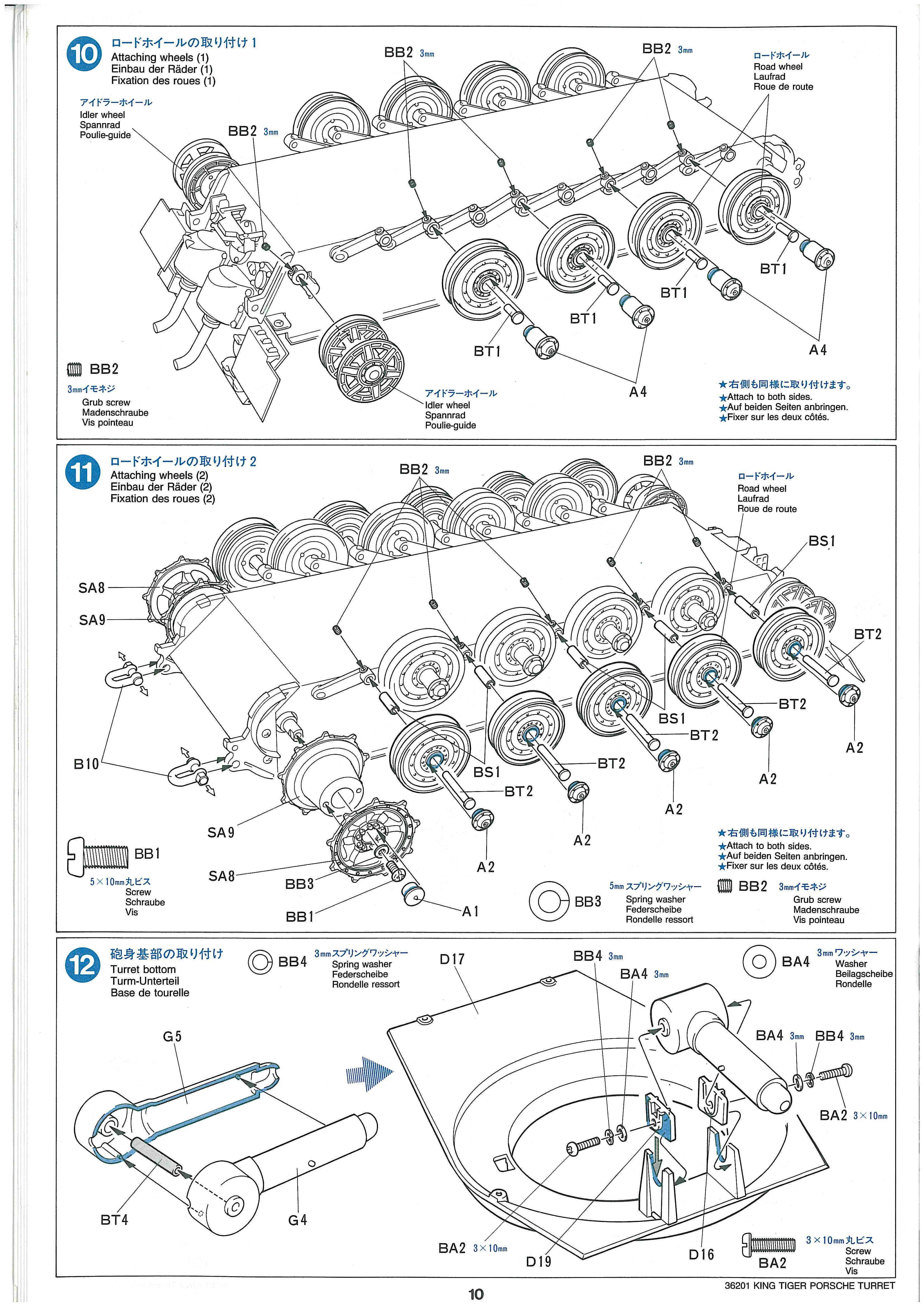

Just got this from Axels in Germany. If any one, can use this.
Best Regards

Hello Danish Commander , Thank you for the pictures . Just the info i was looking for . Besides the turret i believe there are two sprues - D - 9003381 and G - 0003475 - that are in the Tamiya Porsche KT kit which have the rest of the parts needed for the conversion . Regards .
