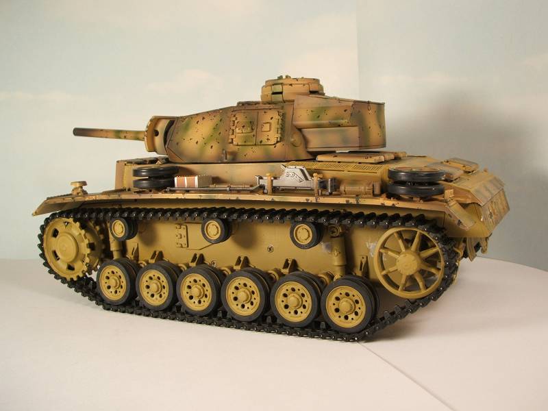

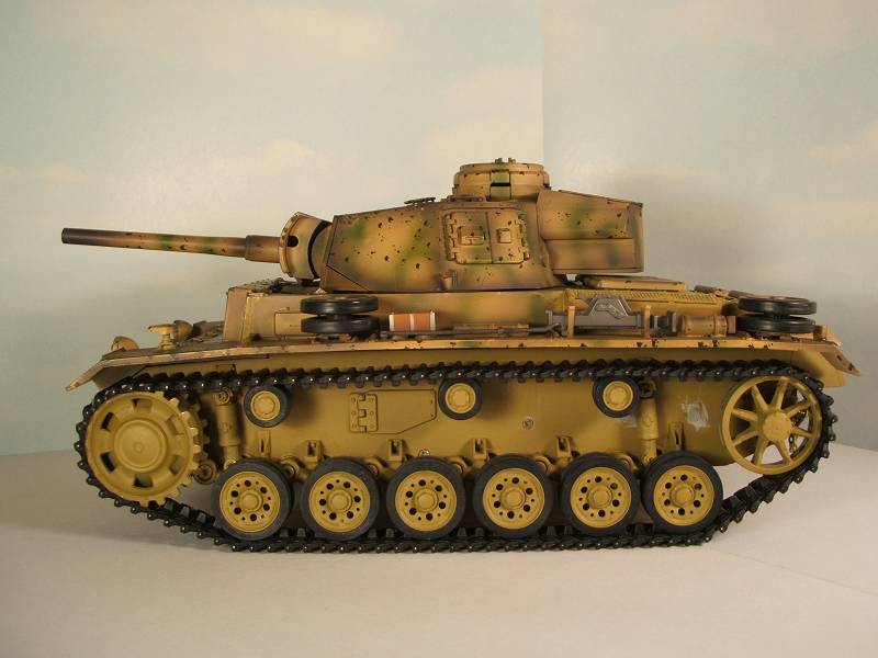

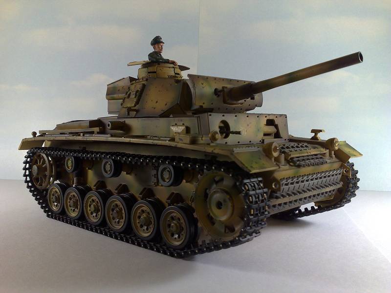

I just wondered if you Guys can notice the difference in the location of the Sprocket and Idler wheel. I thought I would post this before I did the other side incase anybody was interested in a pictorial walkthrough. The sprocket has been raised by the width of one M4 washer ( probably something approaching 0.7 to 1 mm ). The rear Idler has been raised by Approx 3mm. If it looks good to you and you want a walkthrough just let me know.
I've popped an older pic in at the end to give you an idea of the H/L standard version.
Nick.

Honestly, I can't notice the difference looking at the pictures provided. Are you sure you got a stock tank in the group????

I think the second picture shows the stock setup. The other pics clearly show that the real idler has been raised, is this more accurate?
Oh, OK then . Yes it does appear the rear idler is a different height, but man this cowboy has a hard time picking that up. Somebody would have to point that out to me, otherwise I would never have caught it.

Hi Guys, it looks a lot more convincing in the flesh. Blame the photohrapher, me !!.
Captain Nemo12 you are perfectly correct, it's the second pic thats stock. They got mixed up in the download. The height of the idler is now correct according to line drawings that I've studied. In that the idler should sit on an imaginary line drawn beyond the bottom of the hull. The problem now is that the idler is too small in diameter, so I guess I'm stuck with that now. It also means the return rollers need moving again up again and I guess I'm pretty much on my own with the measurements there. As the panzer-ketten measurements are now invalid.
I'm using this tank as a prototype for mods and learning things on the way and making notes of any changes that improve it's appearance. I intend to buy another PZIII after I've finished moving things around on this one, so I can get all the adjustments right first time.
