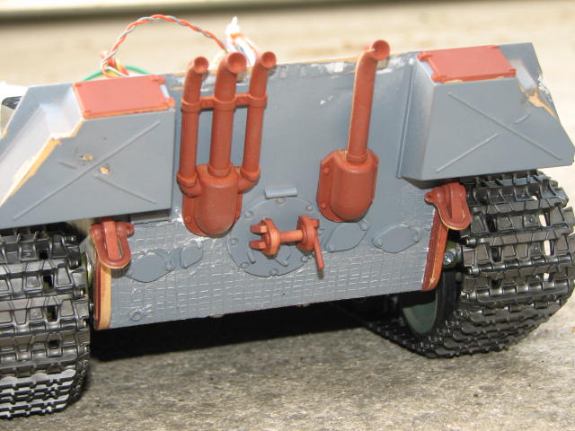

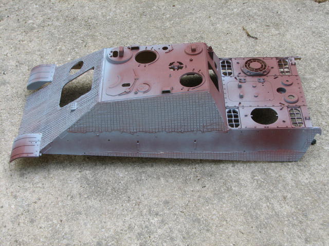

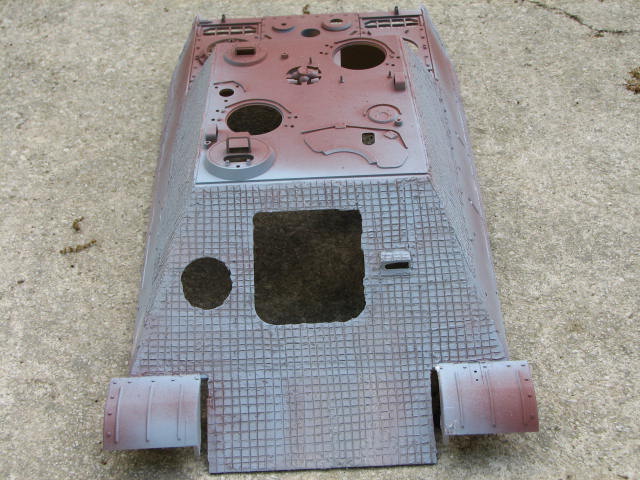

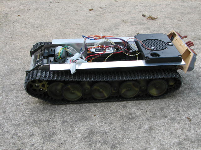

I finally started my Jagdpanther which has been sitting for a few months. I am going to do an early JP with zimmerit. This is the first time I have tried the zimmerit so be kind. I am happy with the way it is coming out so far. I just finished installing the electronics and it runs great so far. I still have not decided if I want to try and change the mantlet cover to a welded one though. I was thinking of sanding the bolts down and filling the areas with putty. It will be a little different, but overall look well I think. I might just leave it as is with the bolted version. I saw some pics of one on a thread that looked great with it and the zimmerit. Well here are some pics so far. Let me know what you think.
Carl

I recently finished my Panther G and had added the Daimler Benz criss cross zim pattern as well. I hadn't seen many people attempt that pattern. To create it
I ended up making a custom tool. What material did you use for your zim paste, and what did you you use to apply it?

Hi Squid,
I used a multipurpose joint compound for the paste. I was going to use squadron putty, but found it dried too quick for my liking. I read on some sites about using the drywall paste so I thought I would give it a try. I used a putty knife to apply and then used a knife to make the pattern. The main concern I had with the drywall compound is that it can wash off. I practiced on another model and then primered it and it seems to hold up well after this. I will post more pics as I go. I hopefull will work more on the upper hull tonight. I think I will go with the welded mantle cover so I will post picks of that as well.

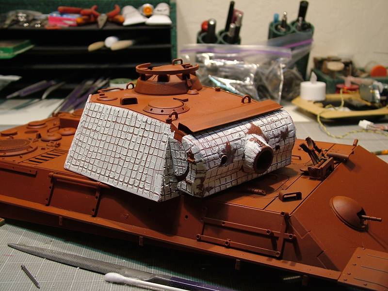

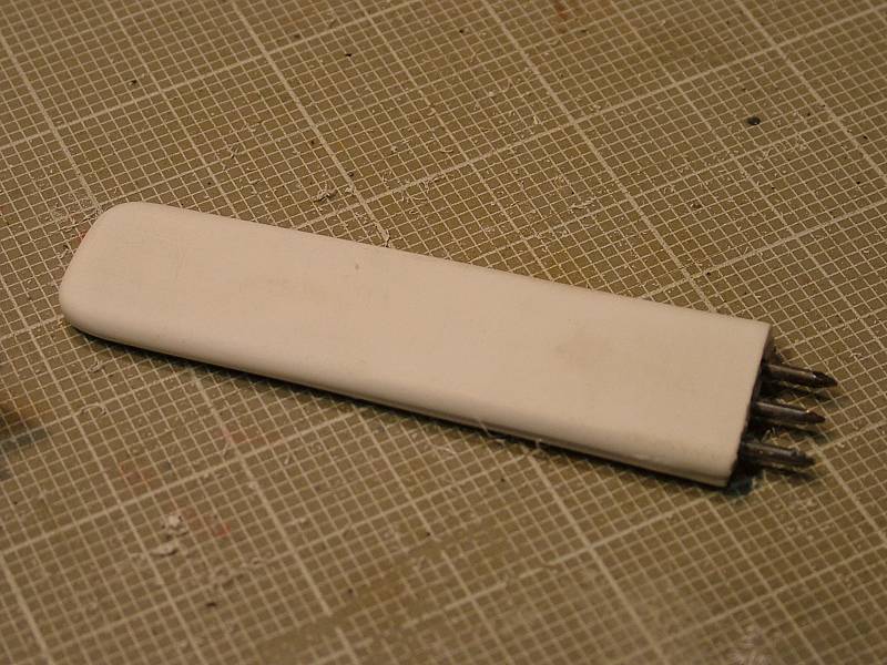

That's how I did my Panther as well.
I used water based vinyl wall spackle that you can buy at any DIY or home center (Lowe's - Home Depot) applied it with a 1" wide flexible putty knife. Then using a home-made tool I created the criss-cross pattern.
The fact that the paste could be easily removed or washed off was a plus. In fact I used it to my advantage to create "damaged" or "chipped" effects to the zimmerit. I had posted a pretty extensive thread on the build as I worked through it, you might find something in it helpful, I had quite a few responses. You can find it under "most active" the title was Panther G rebuild or click the link below if interested.
http://www.rcuniverse.com/forum/m_72...tm.htm#7232225
Here are a few pics of the tool I created as well a a few shots of the Panther. I hope this helps at least a little.
Regards
Craig (Squid)

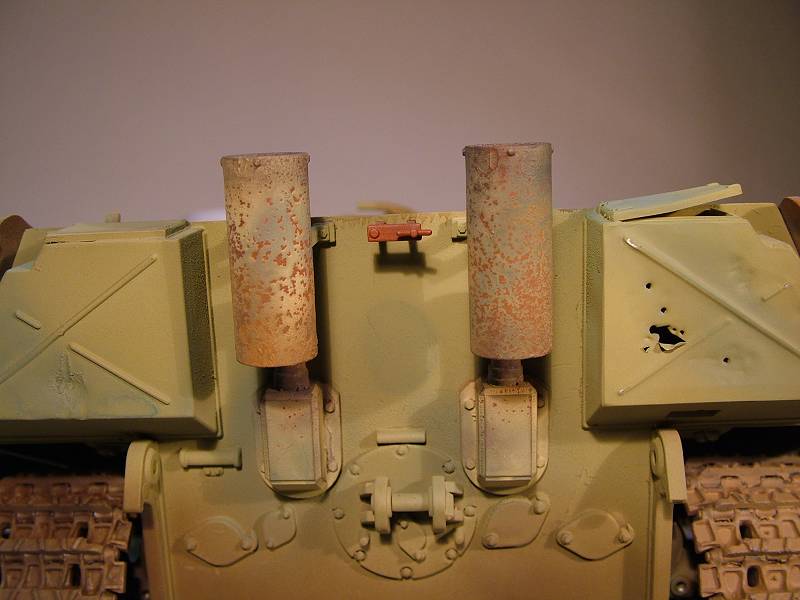

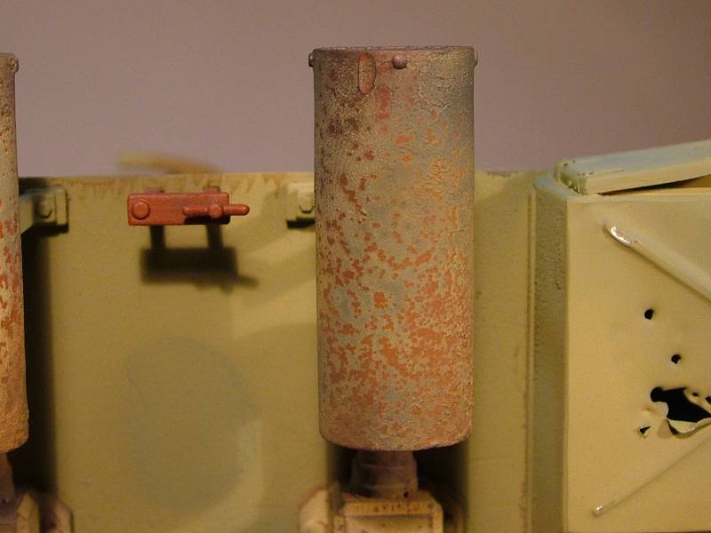

Carl, depending on which type of exhaust you choose to go with, I had pretty good success using salt weathering technique to rust the "can" type exhaust stacks included with the Panther G kit.

Sorry I did not reply sooner, but it is hard to get time to sit here in front of the computer. I remember now that I saw your thread on your Panther build and this is where I got the idea for the drywall compound! Thanks for sharing that. I really enjoyed reading and seeing pics of your build. Also want to thank Posion Porkchop and Pcomm1 for their help. I got a lot of good ideas from y'all. I am planning on trying the salt technique some on the pipes and see how it comes out. I am finished with the build and will show some pre painting pics later. Hopefully I will get to paint some today, but it is looking like it will rain here. Also as an update, I am going with the stock mantlet cover. I tried to fabricate on and it did not come out well and I am too chicken to experiment with the stock one. I have been running it and it runs great so far. I will hopefully be able to post some pics later today and also some on my T34 conversion to HL with DBC and DBU (they work great!).

I am just learning about the different manufacturers out there. Is your tank an HL? or a Tamya? It looks like there is aluminum bracing on the hull. Thanks

It's a Tam
Only Tam make a JagdPanther (though some people convert HL Panthers into JP's)

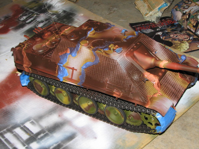

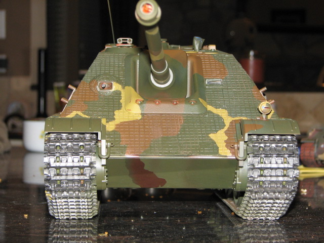

It is a Tamiya. I have been working on the painting today and have the dark yellow and brown on. I am trying "Silly Putty" for a mask over the yellow. I will add some over the brown before I paint the green. So far everything works great except my maching gun LED was out so I am sending that to Tamiya USA to see if they will get me a new one. That is not a big deal though. Everything else works well. I have enjoyed building this so far.

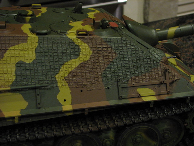

Okay here are some more pics. I started the cammo. Now I have to tone it down a bit with some weathering and maybe filters

Paint looks very sharp csal, nice job[sm=thumbs_up.gif][sm=thumbs_up.gif]
