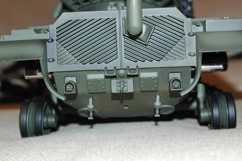

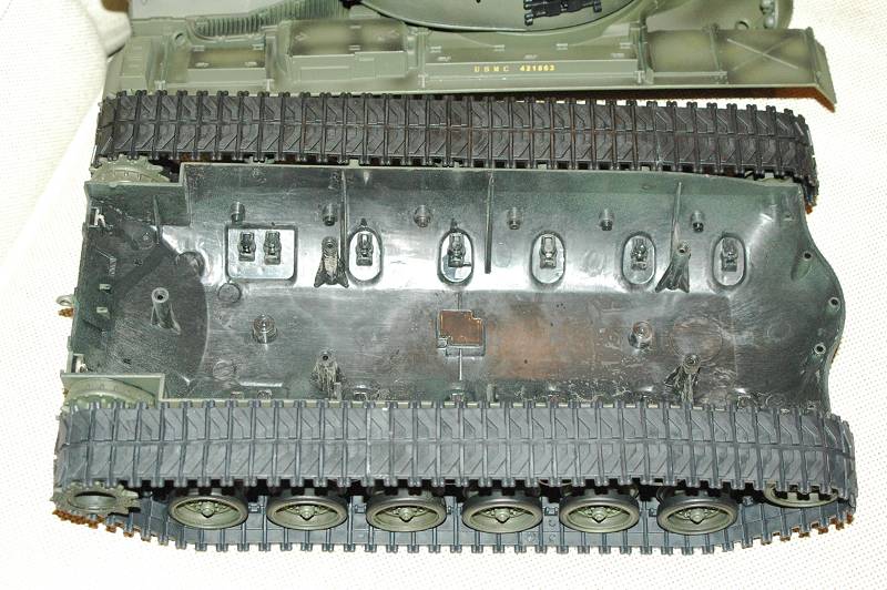

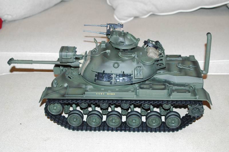

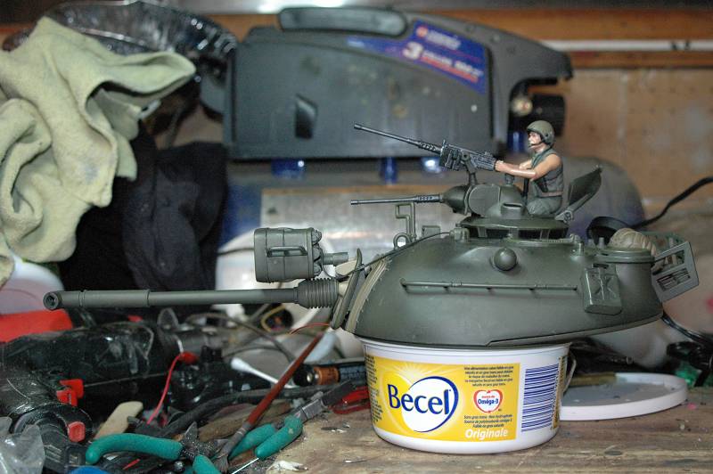

I just started on my conversion of a 1/18th scale 21st Century M48 Patton tank. As requested I will try to show the steps I've taken to upgrade this to full RC. This is a big tank and should have no problem fitting the necessary RC components. The top and bottom are held together by 5 screws so its quite easy to take apart. I plan on installing either Heng Long gear boxes or my spare gear box from from my Matorro King tiger. Each one will have its pros and cons. I will have to do some internal cutting but nothing that a dremel tool will take care of.

I removed the transmission casings using a knife (there are three plastic connections holding it on) I am planning on cutting down the hull so the drive shaft can slide in place. My first observation is of I use the Hl gear box I will have to use the Pershing gear box as it has a longer drive shaft. The ones in the picture is one from a tiger

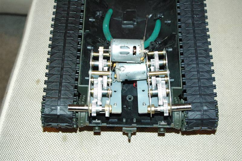

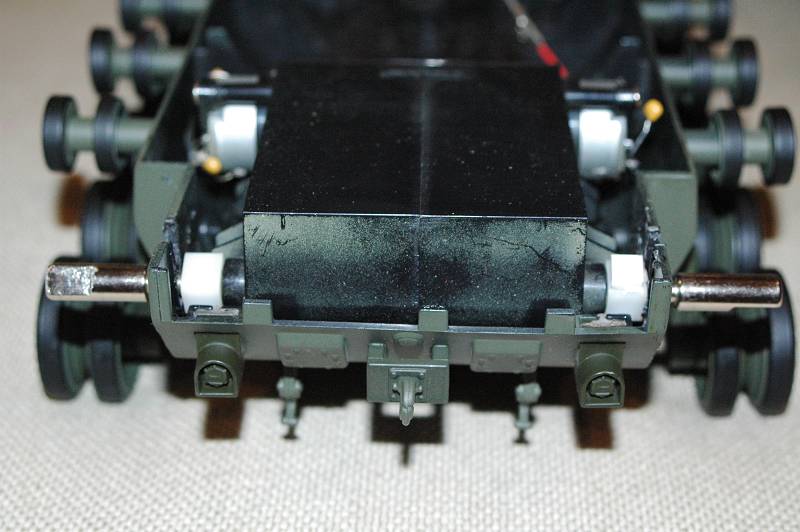

after some internal cutting I was able to fit (quite nicely the matorro gear box. Now I will have to figure out how to attach the drive sprockets to the drive axel

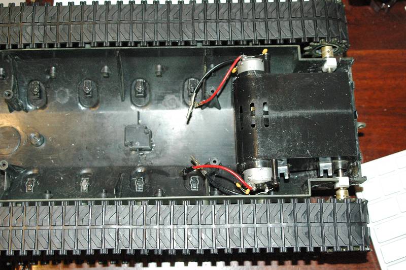

a good start for an hours work

This is actually an Ultimate Soldier not a 21st Century tank. I hear they are pretty much the same company.

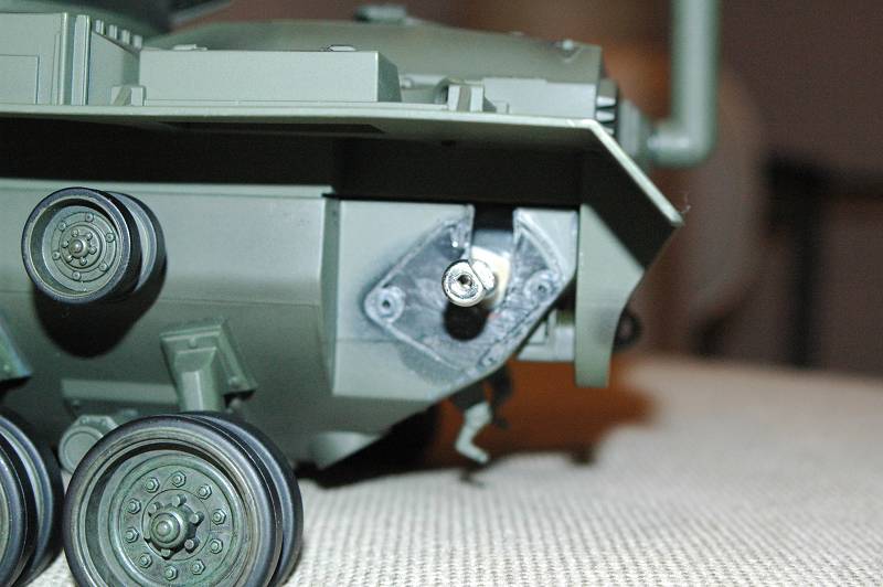

Default RE: M48 Patton - 1/18 RC Conversion

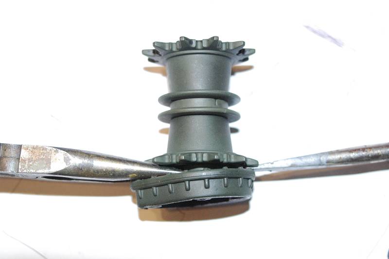

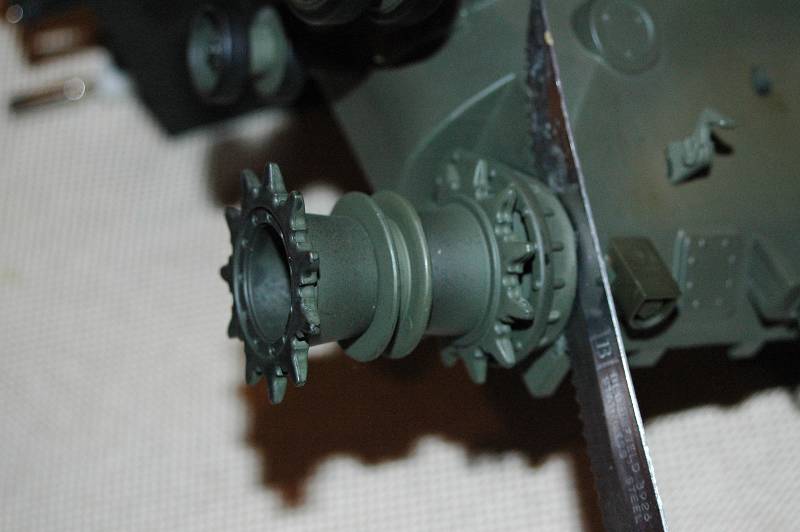

I removed the rear drive sprockets by inserting a knife between the transmission casing and the tank's body. I removed the transmission casing from the drive sprocket by prying it off. I then cut the drive axel to remove the pin. That allowed my to drill out the drive axel so I could insert a brass bushing.
OK, I have the sprockets attached to the gear box. I hooked it up to a battery and it seemed to have run fine. The true test will be when I get the RC in and run it with turns. I'm optimistic but if it does not work out I can always get my HL tracks/sprockets and drive train

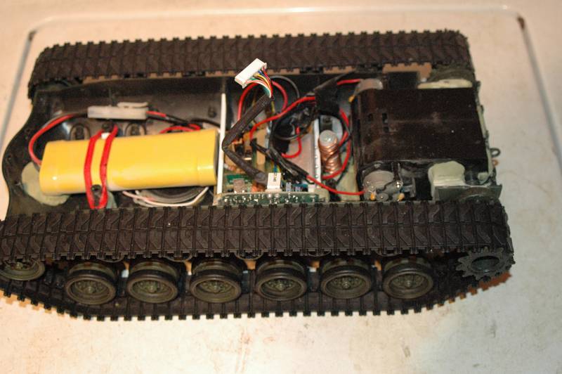

Back to my conversion. I've pretty much have this thing done. Just need to put the turret on to the chassis and the chassis onto the hull. Everything seems to fit well. Unfortunately I do have to take the chassis off the hull to recharge the battery

forgot my pics

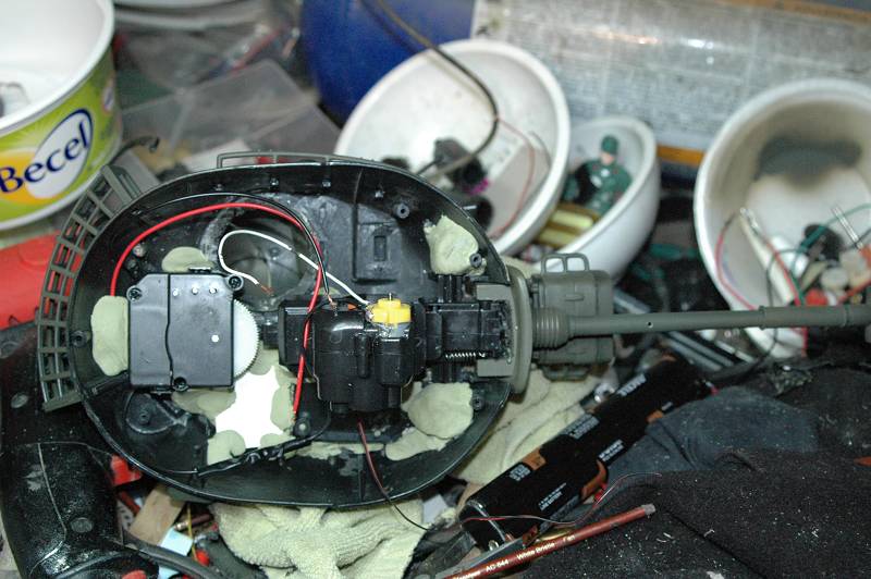

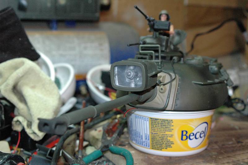

Some more pics. As you can see I've installed an airsoft unit. I was able to figure out a system to feed bb's to the gun. The gun elevation unit just fitted into the turret (notice its a smaller one from an HL Panzer III. You will also see that I installed a white LED light from a HL tiger
