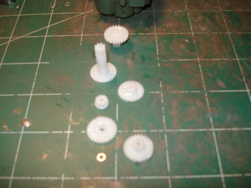

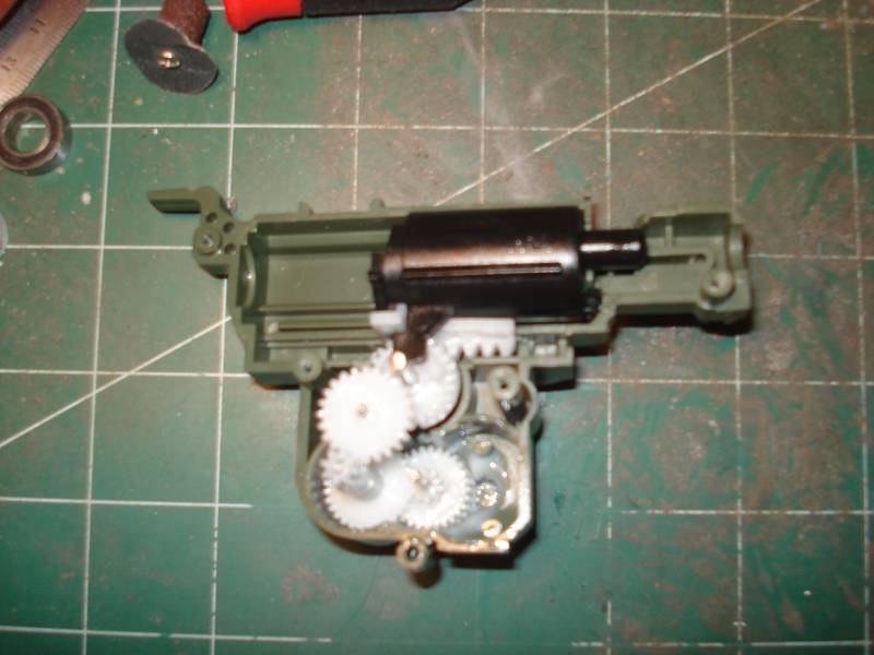

These 2 photos show the position of the gears in Heng Long and VS Airsoft Units.
On a Heng Long Airsoft Unit there is usually a washer underneath the large gear that moves the plunger/nozzle assembly back and forth.
On both units there is a spring at the base of the left side shaft right below the clutch gear. A washer usually goes on top of this spring and below the clutch gear.

Nice! Good thing, will be less trouble next time I open the airsoft gearbox Thank's!
