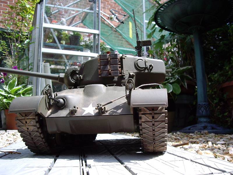

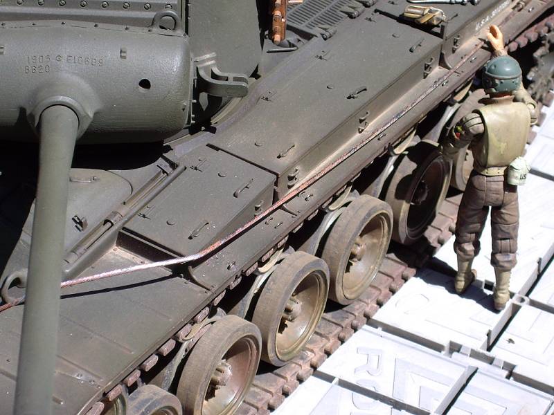

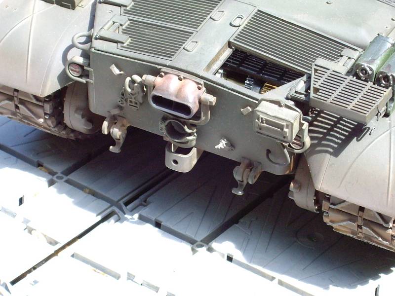

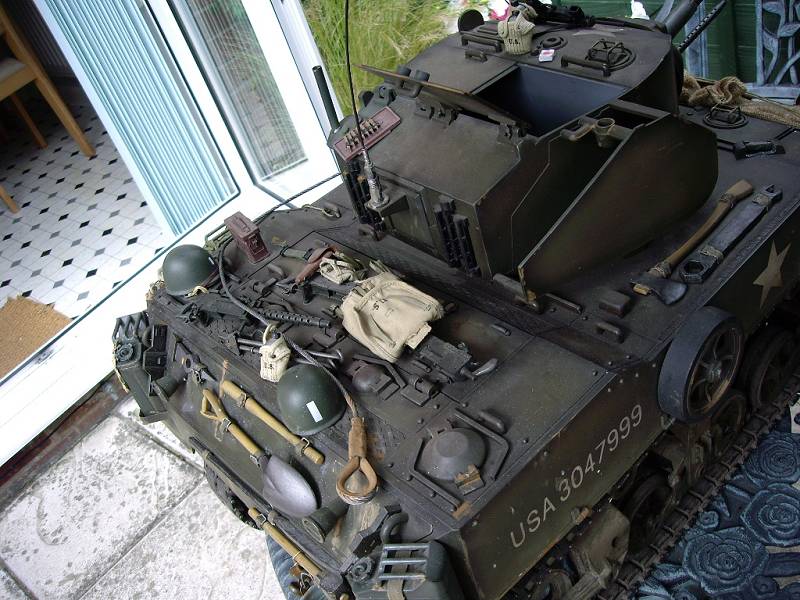

As promised a few pics of my pershing, i shall early next week,
post some more and explain how some of the fittings were made,but i hope i do not bore you with
this,hope you enjoy these........
Pete..........................

Great job, looks great! Really like the detailing and the tie downs on both sides. My Pershing has them so I can appreciate the amount of time it took to make them! The port side tie downs were only on the center tool box the pictures that I've seen.
Old 07-03-2008 | 05:29 PM
pattoncommander's Avatar
Joined: Dec 2006
Posts: 5,058
From: Columbia, SC
Default RE: Petes Pershing
One of the most accrurate Pershings I've seen on the RCU. Looks great. I like the open transmission access grill. Looks great and at the exact open angle. What's under it....switches? What's missing are the gunners and loader's periscopes. On the M-26, the periscope is the primary sighting device, with telescope as secondary. Stand the oil cans up and lock in the fender ammo boxes, and she's ready to roll. The TC is really good....who has these figures? [sm=thumbup.gif]

Thank you guys, modellers license on some things,added a few more pics.

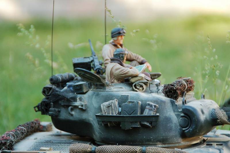

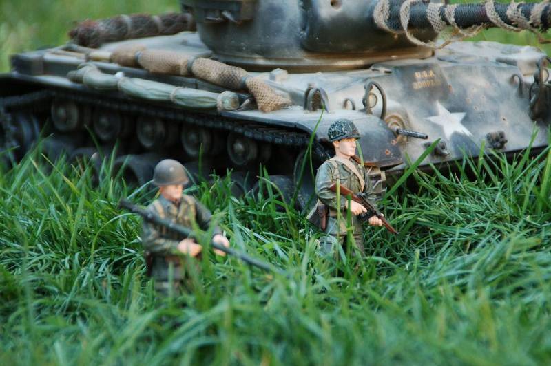

Hi there
I just got my Pershing
Still miss the electronics, but hopefully it will run at the next battledat
cheers

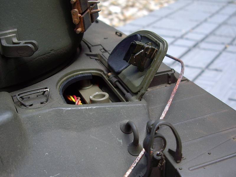

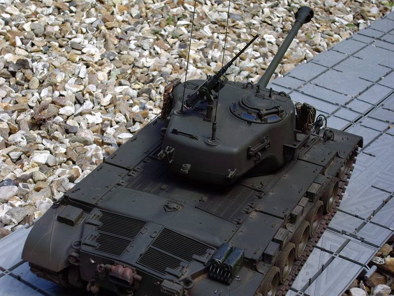

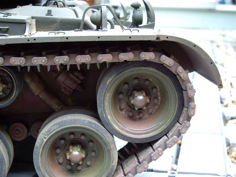

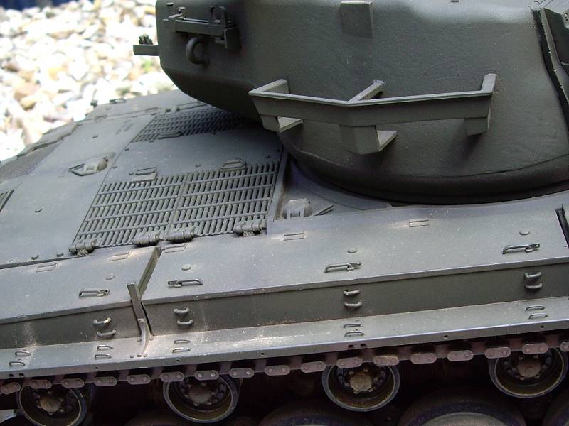

Hi guys, sorry for the late reply on the build i promised you.
First thing to do is replace or thin down the light surrounds as these are way too thick,replace with brass or thin them
the same as i did, just using a file.
Next if no sandshields are fitted then drill the holes in the edge of the side skirts about .05mm or a little larger, as i broke
the rear fitted wire when i first used the tank, i then decided to replace the small retaining lugs with brass, these simple brackets
are bent into a L shape with a small tang to locate where the original fittings were. I was luck to have a spare retaining bracket from
my sherman build which has a thread and wingnut fitted. These items epoxied in place to stand the handling that the tank has to endure.
The tc vane sight was drilled but not spilt as plastic to thin to risk that. The loaders hatch retaining lug made from plastic and drilled
then retained by some thin wire with aloop on one side as per real thing.Removed the raised molded springs on the loaders hatch
and repaced with coiled wire plastic card remember that thse springs are not on the same axis as the hatch itself, beware that you have to glue this movment solid so that both axis move together.
Fitted the five periscopes guards from schumo, the matlet suround that the weather guard clips to. was thin plastic strip then drilled and plastic rod fitted into the holes.
Will continue later work calls.

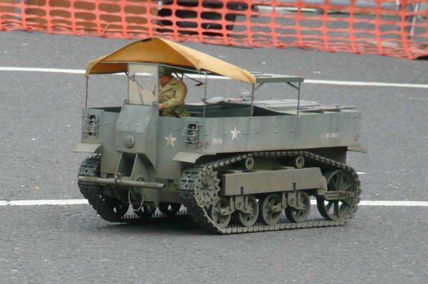

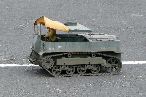

Not today, as i have the lid off.
hoping to catch you later in the year at your bash in september,
will it be ok if i bring this as well.............
