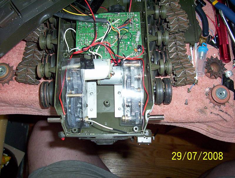

As I used a light grease, I know there will be a mess. So, I used some light gauge lexan I had kicking around to build wrap-around splash guards. I'll add a pic or two at the end so you all can see. I held them in place by putting the front and rear screw in thru them underneath. It was a real pain to work around them to screw the drives down but I believe it is worth the extra aggrivation. Oh, and you can see that I have trimmed the smoke tubes as suggested- they stuck out and looked butt-ugly!
Last thing to do for now is to install a tiny laptop fan I have. I'll need to drop the voltage- it runs on 5 volts, so I'll need to dig up a 50 ohm resistor to knock off 2.5 volts. BTW I have a TK-RX 13 receiver board- anything I need to watch out for, or should I just order a RX14 board right away? It should last a while with the fan cooling the heatsink, but is there any significant difference between the two?

The fan connects where the main board gets its power: negative from the battery and positive from the middle of the switch - you can put another switch in-line to independantly turn the fan on/off (cold days, short runs etc)
I was also going to connect the fan to the power switch and battery ground. I salvaged the fan from an old Dell laptop I had kicking around (I'm a computer tech). But a good place to find computer fans is Princess Auto if you are in Canada- they have all kinds of that stuff in their salvage section. Barring that, I'd look at a CPU cooling fan from a computer shop. Be carful on voltage- you want a 5 volt fan, not a 12 volt. And you'll need a resistor in series with the fan to drop voltage.
The way to figure out the needed resistance is figure out the voltage drop you want (2.5 volts or so as as full battery shows at about 7.6 volts fully charged), the current draw of the fan (on mine it's 0.05 amps), then divide the voltage by the current- 2.5v/0.05 amps. This gives me 50 which is ohms. A great resistor color code calculator is at http://www.dannyg.com/examples/res2/resistor.htm.

The motors are on order, but the fan is already in. See pic. Do you think this is enough, or should I add a larger heatsink as well? I have lots of heatsinks from old CPU's, and I have thermal compound.... all I'd need to do is cut a heatsink to fit and screw it onto the existing one.... [8D]

Nah, I left the original heatsink alone. My Pershing's fan is located a little down lower on the side of the battery box and facing the heatsink. This Pershing is running the hotter black capped Suntech 385s which are slightly less powerful then the Speed400s.
