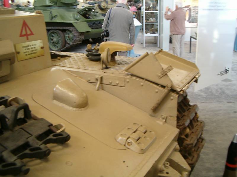

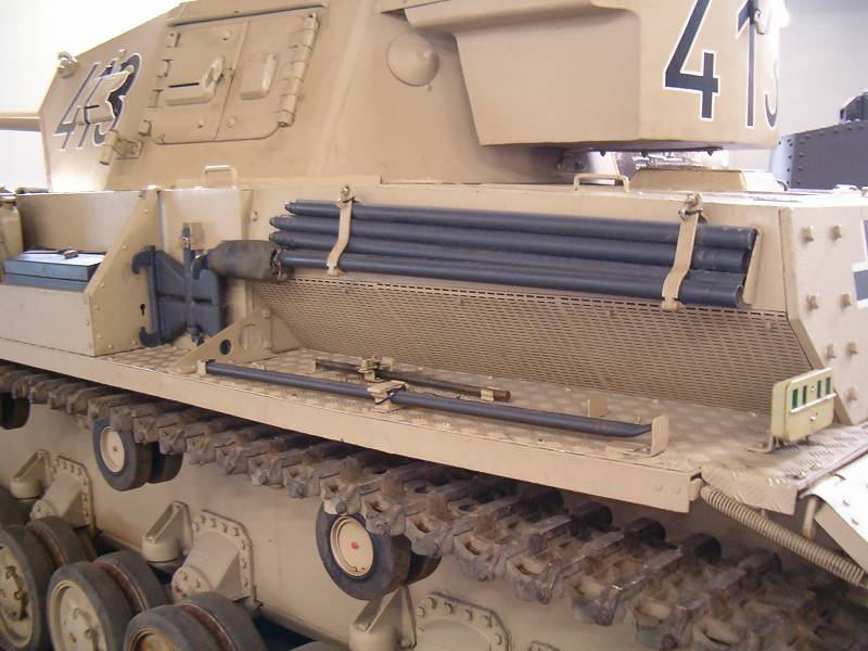

The upgrade was in exterior details as well as interiors.
Let's start with some of the details added to the turret:
- rebuilt Rommelkiste
- new side metal slits in correct position
- moved the side port hook upward
- some minor details made from metal
