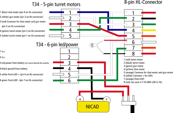

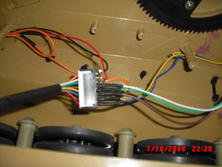

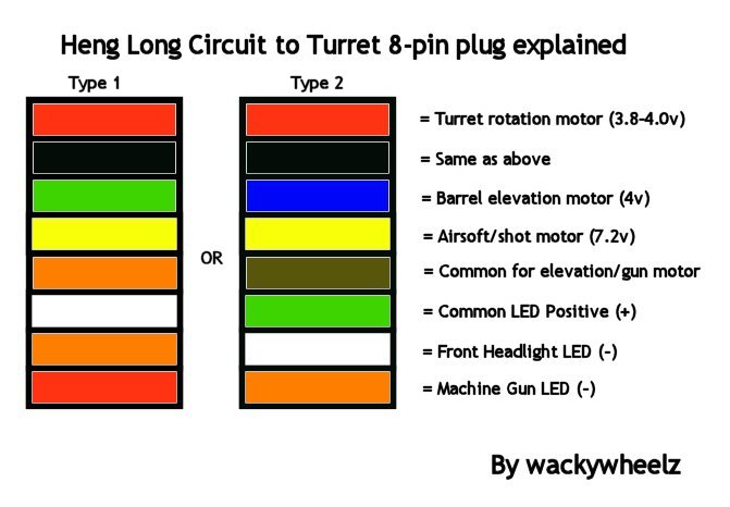

Thats correct Rob ive done just that changed it all to HL electronics rx-14 board and put in HL turret drive mech made the turret move faster one thing watch out for the wiring Matorro wired the KT diffrent from HL tanks and also changed there turret male plug from 10 pin to 8 pin just like HL and that is wired diffrent also then HL wackywheelz wiring diagram will help and the one on the turret wiring from blitz also Ionly had to change the blue and yellow wire around on Matorro side for turret direction rotation .
http://members.iinet.net.au/~wackywh...rade/pershing/
thanks
jimmy

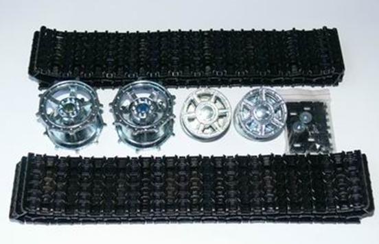

Hello MilitaryMight RCTankwars.com has been stocking the new woodland camo for a while now and I have the metal upgrades, the electronics are better, but still not as good as Heng Long but they have improved!
http://www.rcgroups.com/forums/showthread.php?t=895810
The Blitz

Well it's been awhile since I have posted on my King Tiger, The only thing I did not replace was the rear idler wheels which I find that the axle shafts are hugh compared to the stock size and not enough meat there to hammer the new axle into the hole. My gearbox was replace a few months back and I have been running the crap out of it, opened it up the other day and found two screws had backed completely out that help the box together, so those were tightened up and the 9 gear pinions installed also a few months back and now she has the torque and some speed to match with the new 385 motors(Electronic Goldmine) and the new boards from Phil!
If I do any more updates it would be to the airsoft gun which I am starting to believe is not really needed any more, I rather put a 5mm BB gun Co2 gun then have the crappy
airsoft but then again I just like going around the yard and maybe the park to draw attention to the hobby.
That my fellow tankers is what it's about..Fun and Attention.
