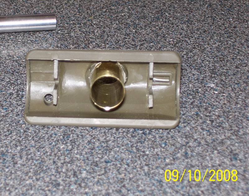

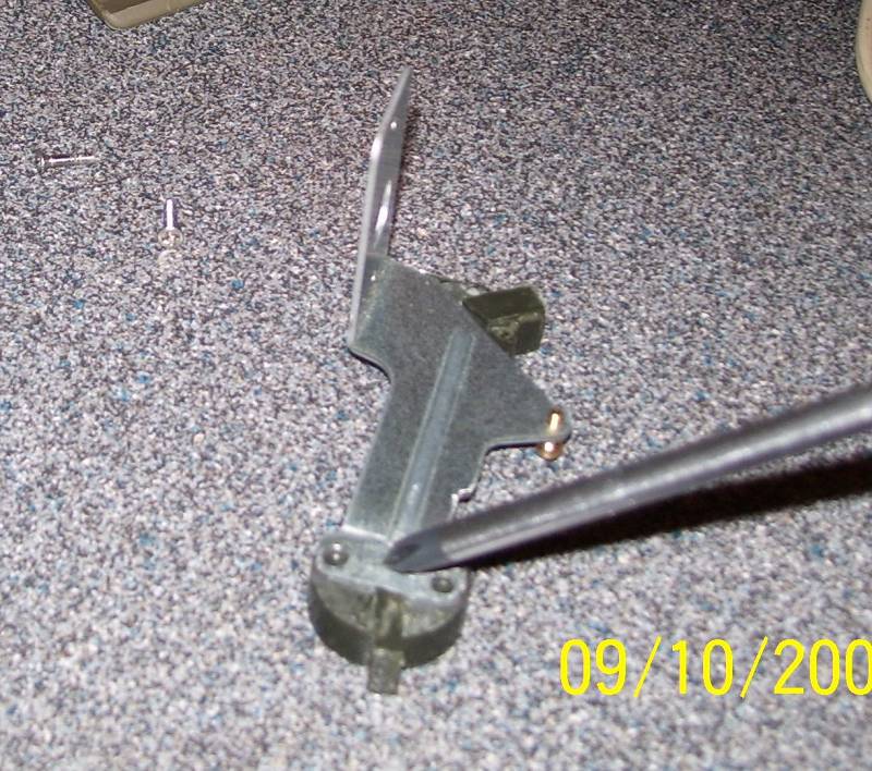

Old 10-09-2008 | 09:49 AM
bubbajoexx's Avatar
Joined: Jul 2008
Posts: 803
From: toronto, ON, CANADA
Default RE: Tamiya Sherman Which mods need doing

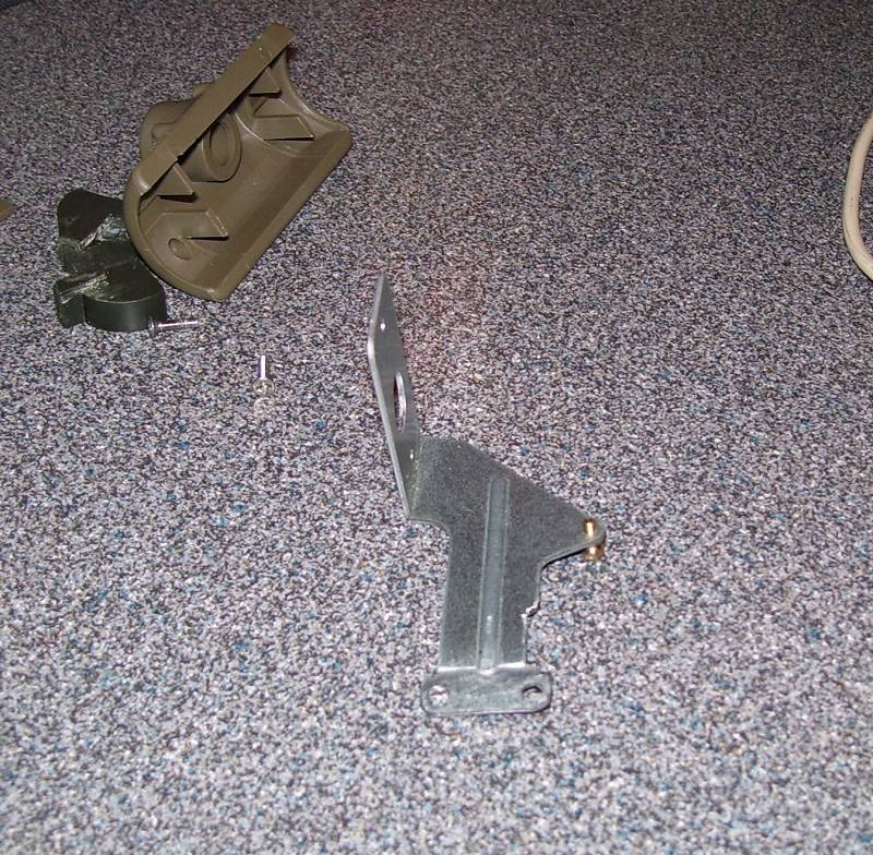

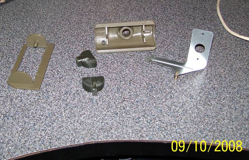

recoil install here is what you will be working with
nowyou will flaten out the persihing recoil mount so it is flate as in the pic
now youput the mount on the right side mantlet mount and drill 2 small holes to install the recoil mount
one you have the screws in use 5 min epoxy and fill in the back side of the plastic mount leaving onl the pin hole where it is attaches to the turret mount
then bore out the mantlet so the barrel slides freely in and out
assemble per istructions and your done

Old 10-09-2008 | 11:12 AM
Joined: Dec 2007
Posts: 679
From: nelson, UNITED KINGDOM
That dosnt seem to hard thanks for posting will down load to file the I dont lose it once again thank you

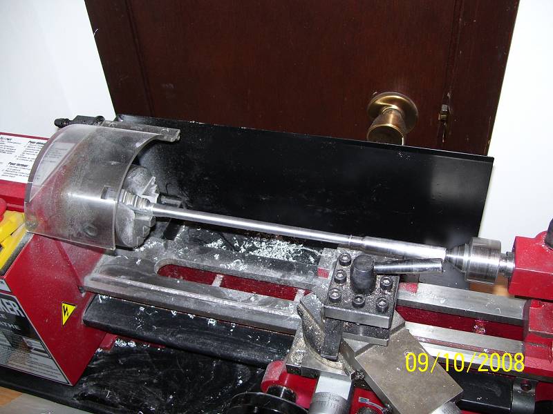

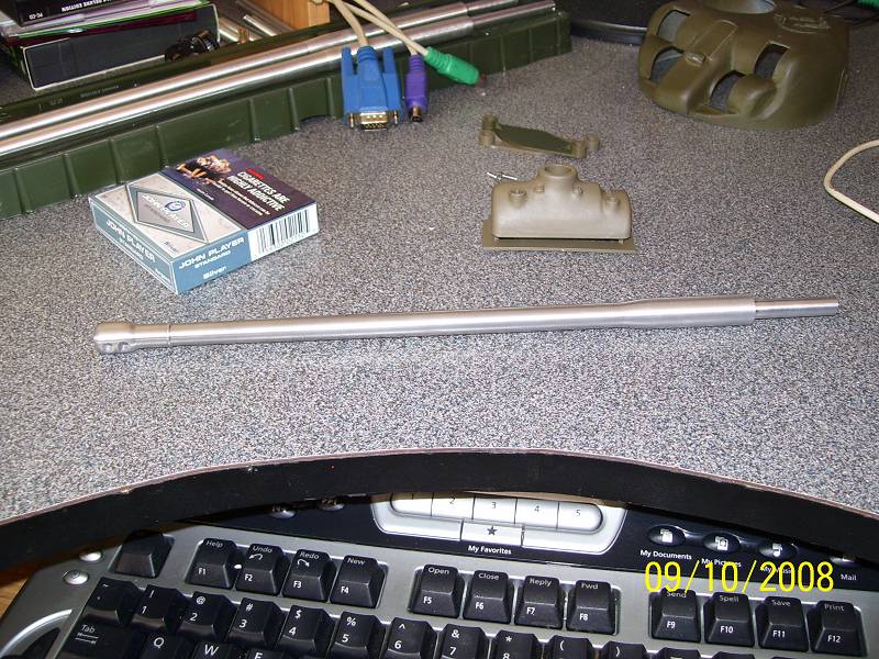

Old 10-09-2008 | 01:24 PM
bubbajoexx's Avatar
Joined: Jul 2008
Posts: 803
this is how the barrel need to be for recoil

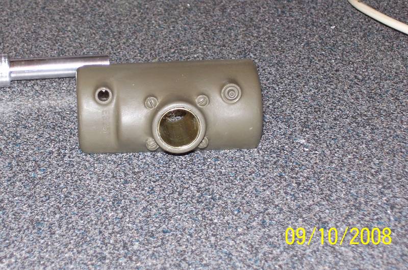

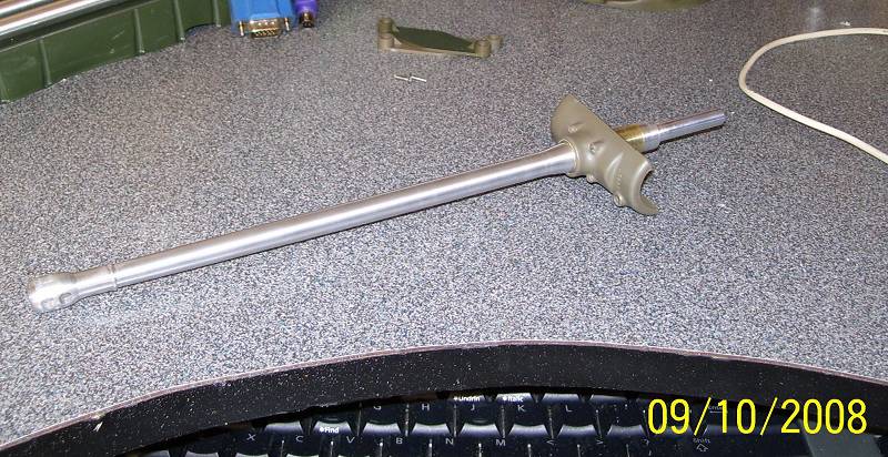

Old 10-09-2008 | 03:42 PM
bubbajoexx's Avatar
Joined: Jul 2008
Posts: 803

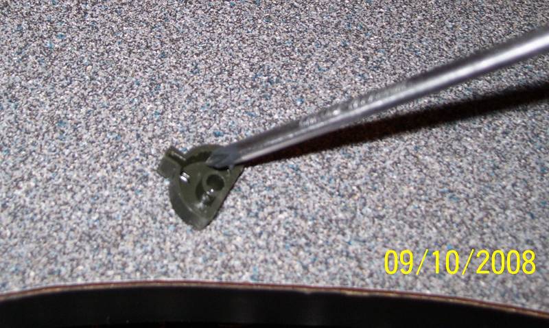

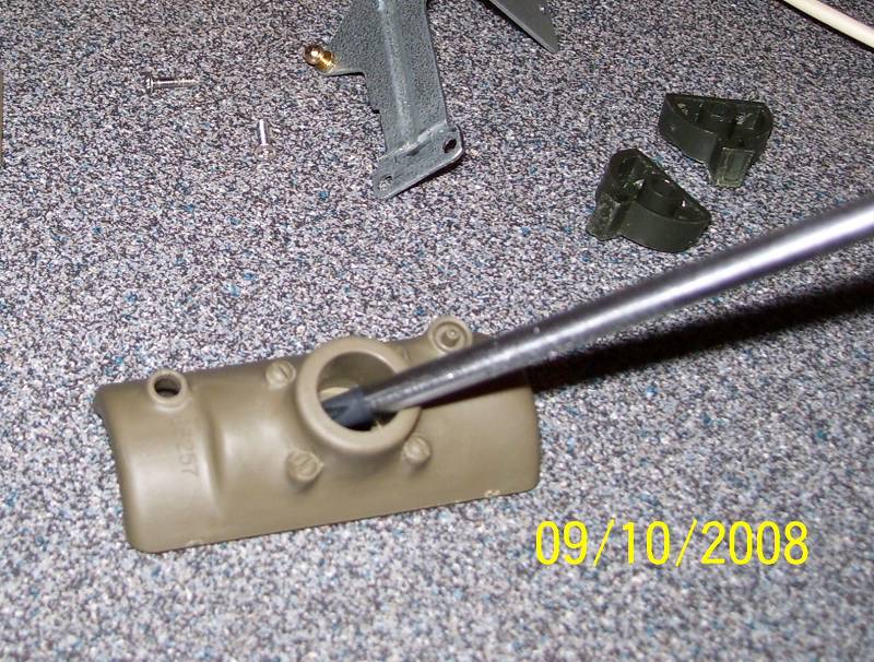

here is what the mantlet looks like with the barrel bushing installed and the barrel

Hi Bubbajoexx do you have diamensions of the barrel I have a lathe and if I can I would like to make the barrel .thats a very nice job you have done. did you mount the I.R. in the mantle or dont you bother with battle systems.
best regards pete
Old 10-09-2008 | 03:58 PM
bubbajoexx's Avatar
Joined: Jul 2008
Posts: 803
ORIGINAL: 971wright
best regards pete
the pics are of one I just made today I will measure up the barrel and pm the sizes to you
the pics are of spare parts i have I made the pieces up just to show you how it is done
