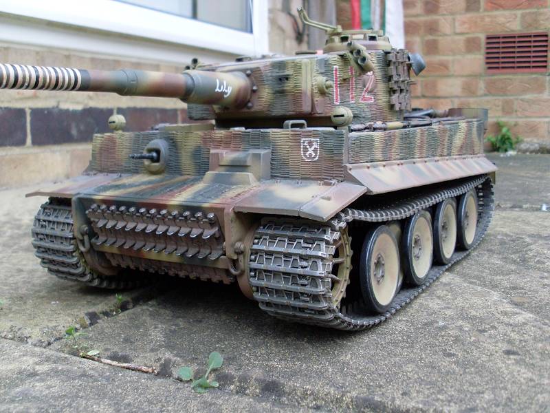

You can use some puttys from local hardware stores and use a rc pinion gear to roll the pattern on m8 thats how i did my tiger
example here..
[link=http://www.planetarmor.com/forums/showthread.php?t=3844]http://www.planetarmor.com/forums/showthread.php?t=3844[/link]

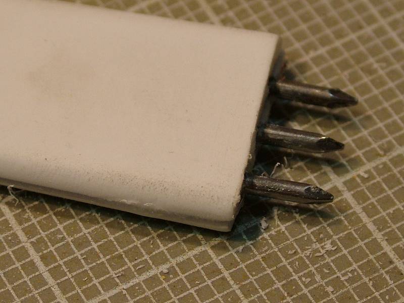

I used milliput. you spread it onto the tank then press a flat bladed screwdriver into it to make the pattern.
It takes a bit of time and effort but i think its worth it.

thanks for the info. The foto shows a beautiful Tiger....Lilly? As in Marlene???

Marlene is correct.
Regarding the millput, I started off doing a small area(about 1 square inch) but as I got more confident the area got bigger!
I spread it as thinnly as I could and used lots of water on the screwdriver to stop it sticking.

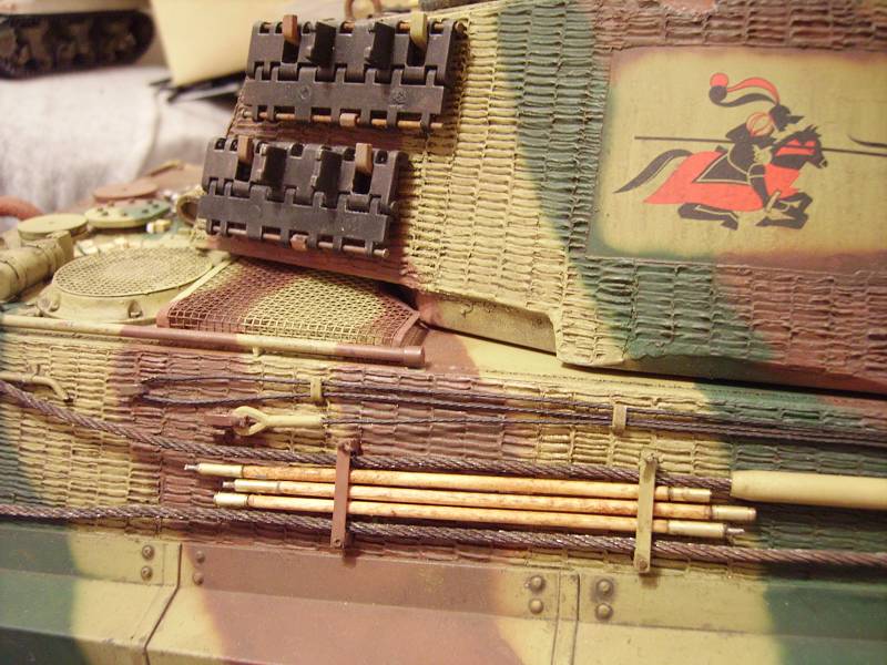

I agree with Fynsdad that the milliput is a good material to use. I do mine with Squadron Green Putty but in exactly the same way with a screw driver - see pic of my current project. One of my pals has used the no more nails technique as well but you need to be careful as there are two types of the stuff so make sure you get a solvent free type otherwise it can badly attack plastic leaving you with a melted hull.
As for the Tamiya stuff, personally I did not like it as it did not look very convincing once painted. It was too smooth and the patter did not look right.

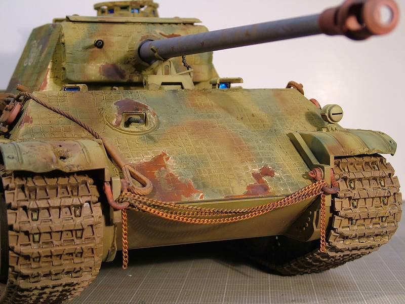

One thing to consider is that there were several different zimmerit patterns that were used by different companies. Most people do the straight lines using a tool (like a comb or screwdriver) and achieve very nice affects. But other pattens can be equally interesting yet inexpensive and relatively easy to replicate as well.

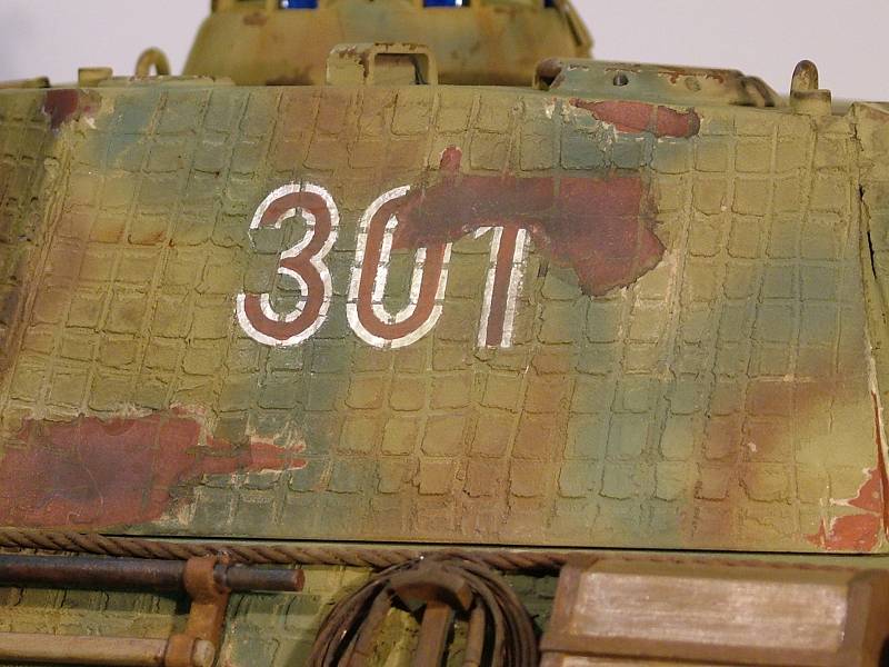

When I did my Panther G model I wanted to do damaged zim, but also create a pattern that was a little different and not as popular amongst RC modelers so I chose to replicate the criss cross pattern used by Daimler Benz. I had an entire build thread on my Panther but here's and excerpt from that thread describing my technique using water based wall spackle (vinyl patch for sheetrock wallboard) and a customized tool I made at home. The entire zim job cost me less than $5 US dollars to create.

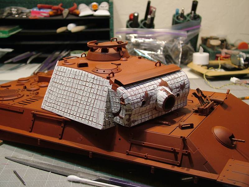

Here's the first attempt at applying zimmermit. I used vinyl spackle as I wanted a lot of control when adding the damage. It took some experimenting to get the consistency just right. I applied it in thin even coats using a 1" wide flexible putty knife, and a 1/2" and 1/4" wide chisel blades for the tighter areas. Once the spackle starts to set I used the tool I made to create the criss cross pattern. It all looks a bit stark in bright white, but once it's painted and weathered with washes, dry brushing and pigments I think it should look ok.
Best of all a Q-tip moistened with water is just enough to lift the spackle and create damage effects. For a harder edged look a simple chisel blade allows you to "pick" or flake off other areas. The mantlet was just more of the experiment, as I'm using acrylics I'll wait until the color coat goes down before adding any more damage. That way as I go through the color coat and erode the zim paste it will also expose the red oxide underneath.
