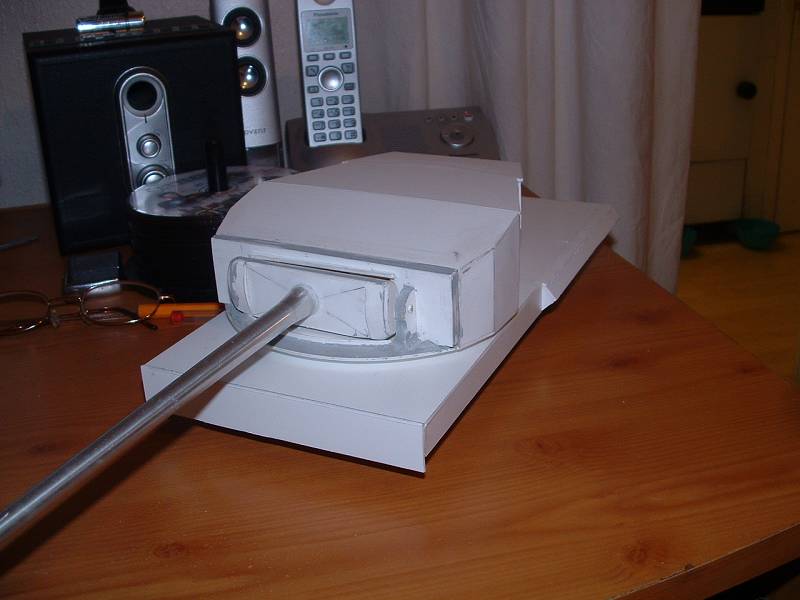

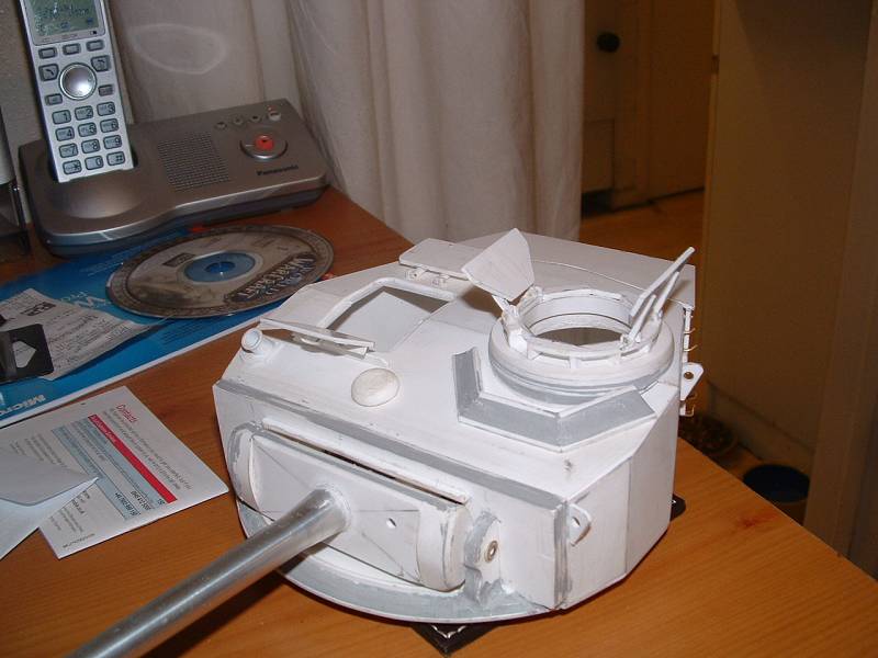

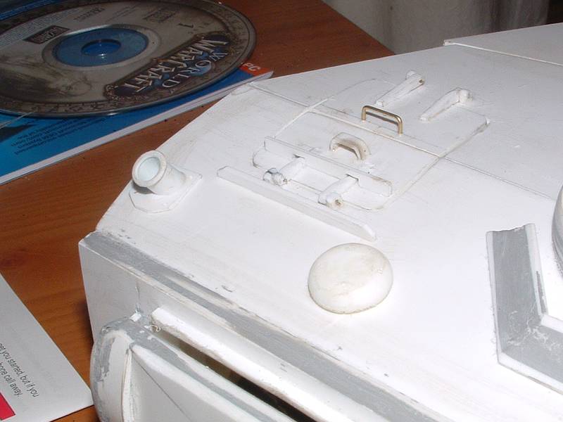

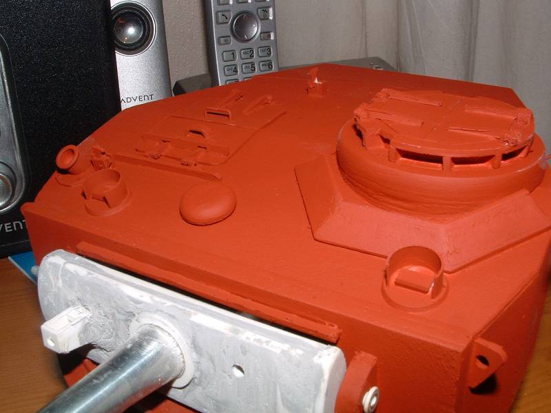

got some more work done on the turret tonight

Old 10-18-2008 | 08:40 PM
hdbeast's Avatar
Joined: Jan 2007
Posts: 1,332
From: Santa Rosa, CA
Default RE: A34 comet
Nice build your doing septon. [sm=thumbs_up.gif]
Gary
Old 10-19-2008 | 06:58 AM
Matdragon's Avatar
Joined: Jun 2008
Posts: 623
From: Bridgwater, UNITED KINGDOM
that is outstanding detail work septon! good job! its so intricate that nust have taken ages to do! well done!
cheers,
Matt

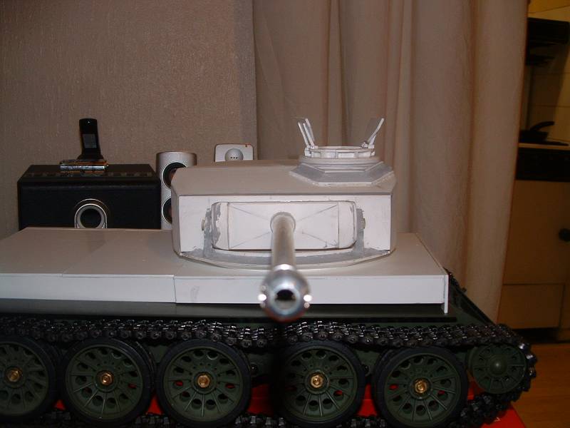

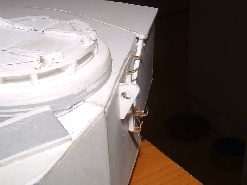

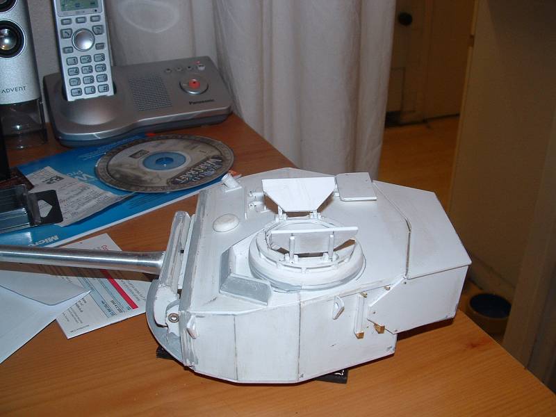

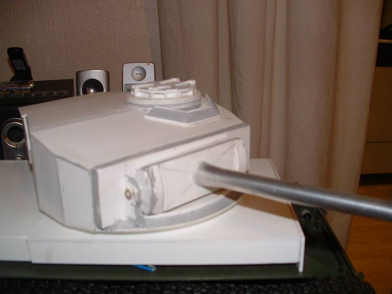

finished the construction of the turret tonight just the mantlet to do

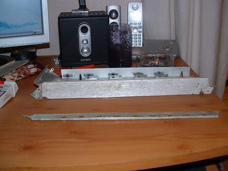

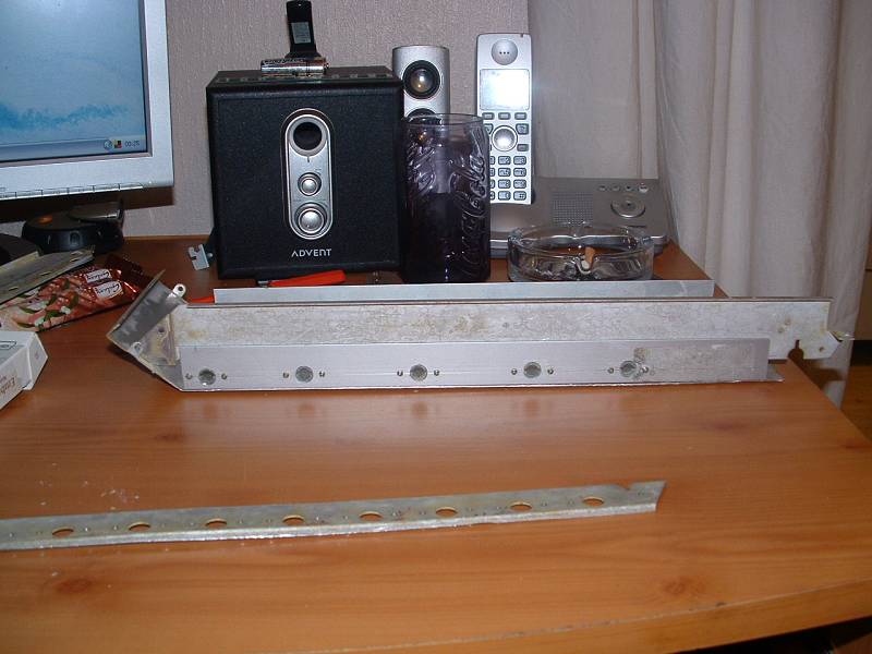

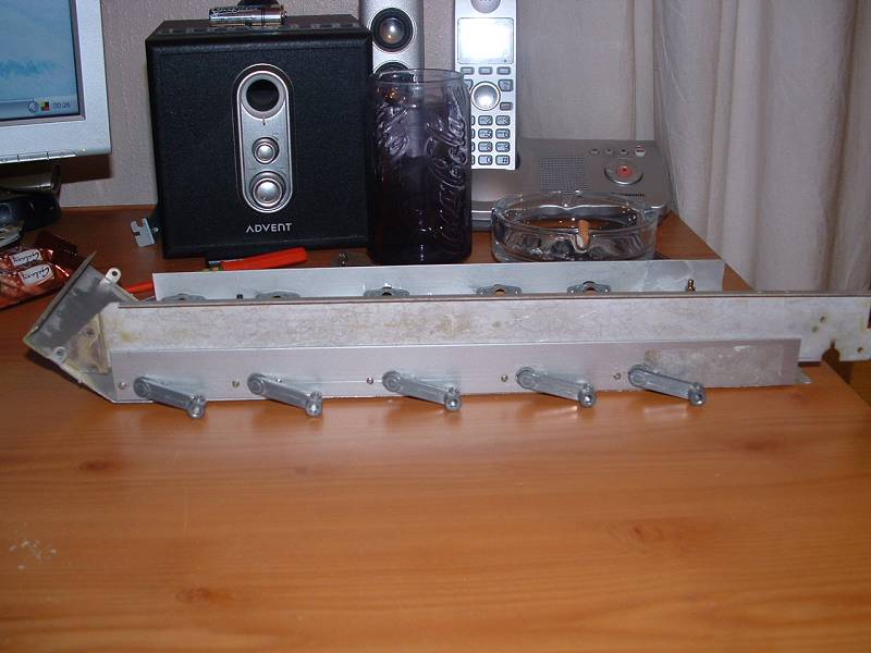

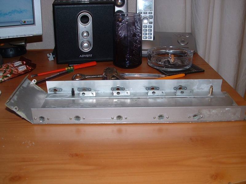

started the lower hull last night it has taken some time to work out but it should work luckily a tamiya kingtiger hull is about the right width but i only need 5 suspension arms not 9 so i have got some ally right angle so i cut the sides off the kingtiger hull then fitted the kintiger suspension

Old 10-22-2008 | 03:13 AM
herrmill's Avatar
Joined: Aug 2006
Posts: 1,994
Received 63 Likes on 47 Posts
From: Hangzhou, China
Excellent work! With the Comet as well as a Maus & KT to build, I'm amazed you still have time to play Warcraft.
